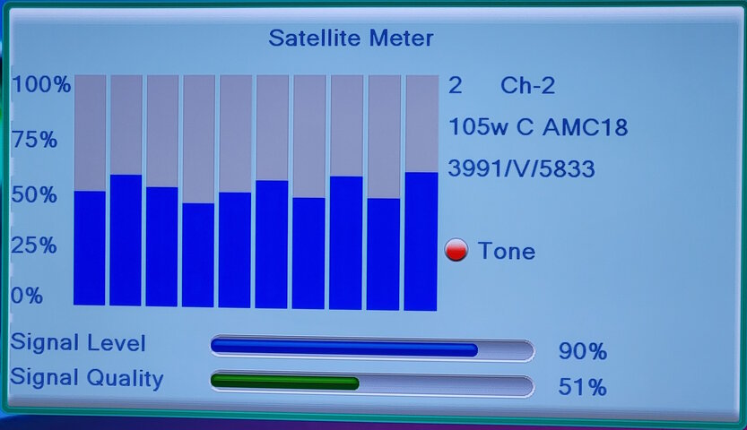

That's disappointing. I hate to discard things that have minor problems. The microHD has the best tuning indicator I've seen for dish orientation. It has a 10-segment time-division display that helps you get the dish oriented dead centre on the signal.
