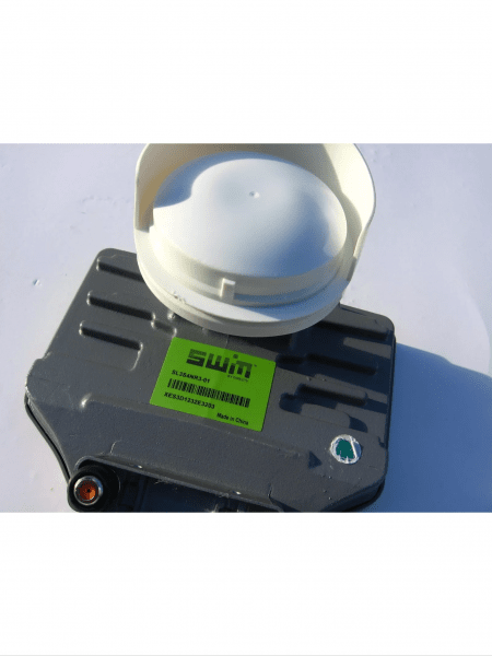

Well after all of that I just found the lnb is shot. The wires are brittle and no good. So back to the drawing board. I have the SL5S4NR2-01.
I'm going to obviously need a replacement and need your opinions where and which one to purchase.
Thank you
Since you got an H24, it doesn't have to be on a swm setup. If you aren't going to move it back and forth with your home setup, you can get a non swm lnb. It will be a little simpler since you won't need to use the power inserter. Either way, except for the lnb setup in the menu, the process of pointing the dish is the same. eBay will probably have the best prices.
I did purchase the power inserter so should I purchase the same lnb as before?
You might as well. You can get the 3 lnb version. They are a little easier to align, but you won't get your local channels in standard definition if you care.
Will this one work?
