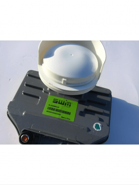

I purchased a new LNB - SL3S4NR2-02 supposed to be 3lnb, SWiM.
My receiver is H-24 100 and satellite connector says "SAT IN (SWM-1)
I purchased a power inserter, model PI21R3-16
I thought I'd make the conversion easier by staying with a swm system.
My problem is I am getting the "cannot detect swm" message. I've made sure all connects are correct and tight. I've unplugged the PI to try and reset it.
What am I missing? are these systems compatible or is there a problem with the PI??

I had a Satellite Finder attached between the satellite and the PI. I was just reading that the swm system was incapable with a this satellite finder. If I took that off, would that help????
