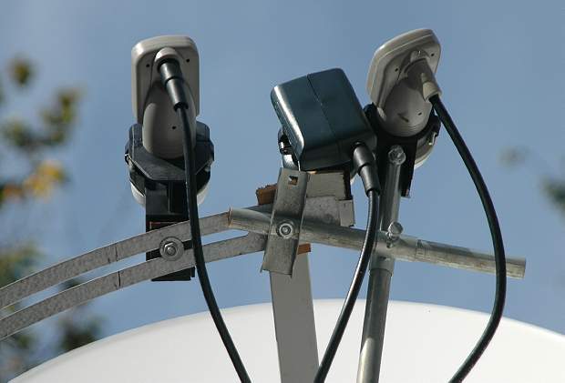

My suggestion would be to remove the bracket and use the original LNB holder on the dish and see whether that improves the signal (which I suspect it will, unless you are having line of sight issues). Then do what I did, take the bracket holder and cut off the LNB holder, and then attach it to the dish. The attachment below shows a setup I had in 2006 and you can see the cut off bracket holder underneath the LNB arm. Plus, the multiple LNB bracket I like the best is on the left hand side. IIRC the LNBs are on 87, 97, and 101.
I might give that a try if the test shows it's the bracket. Won't have much to lose at that point.
