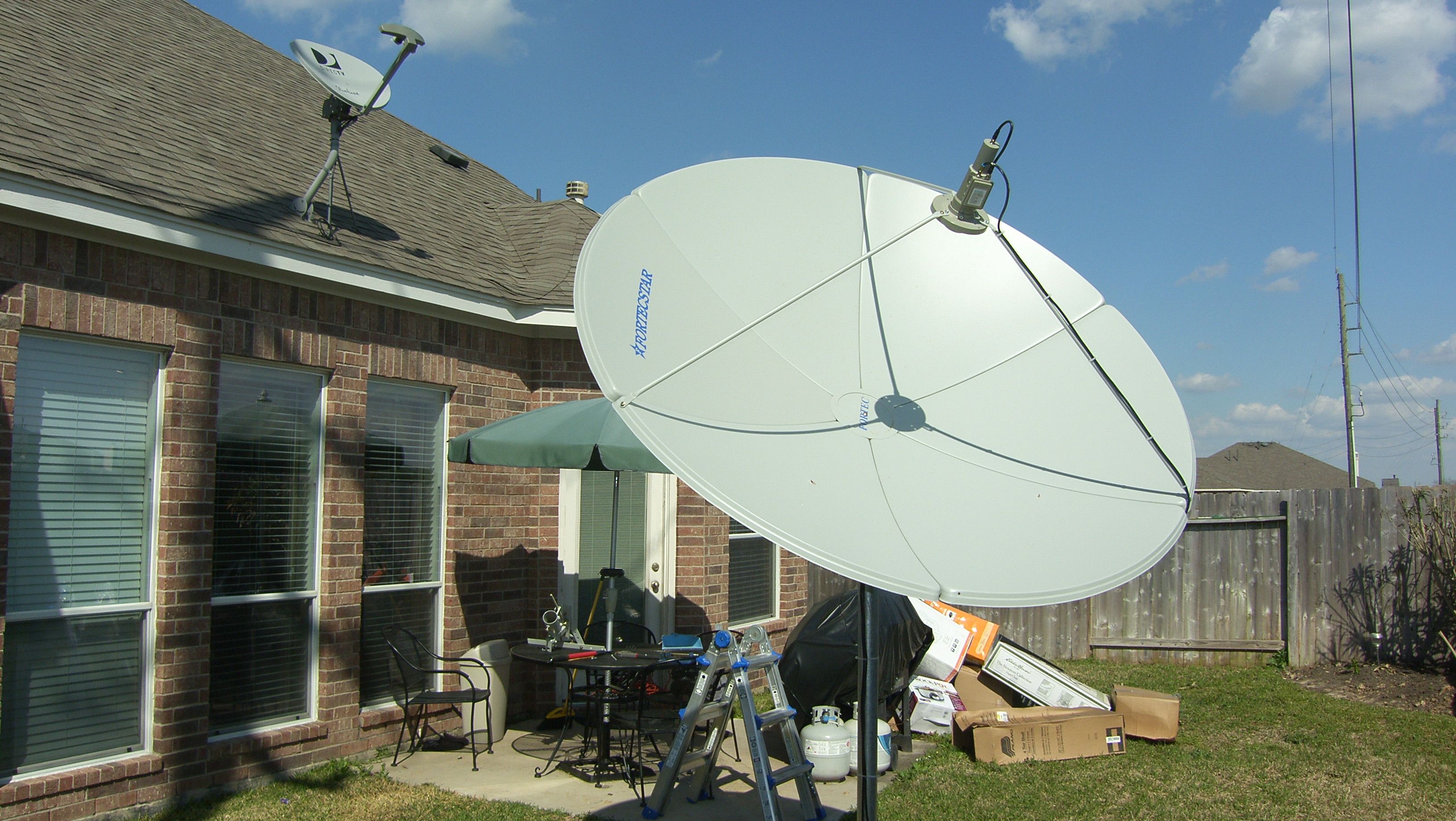

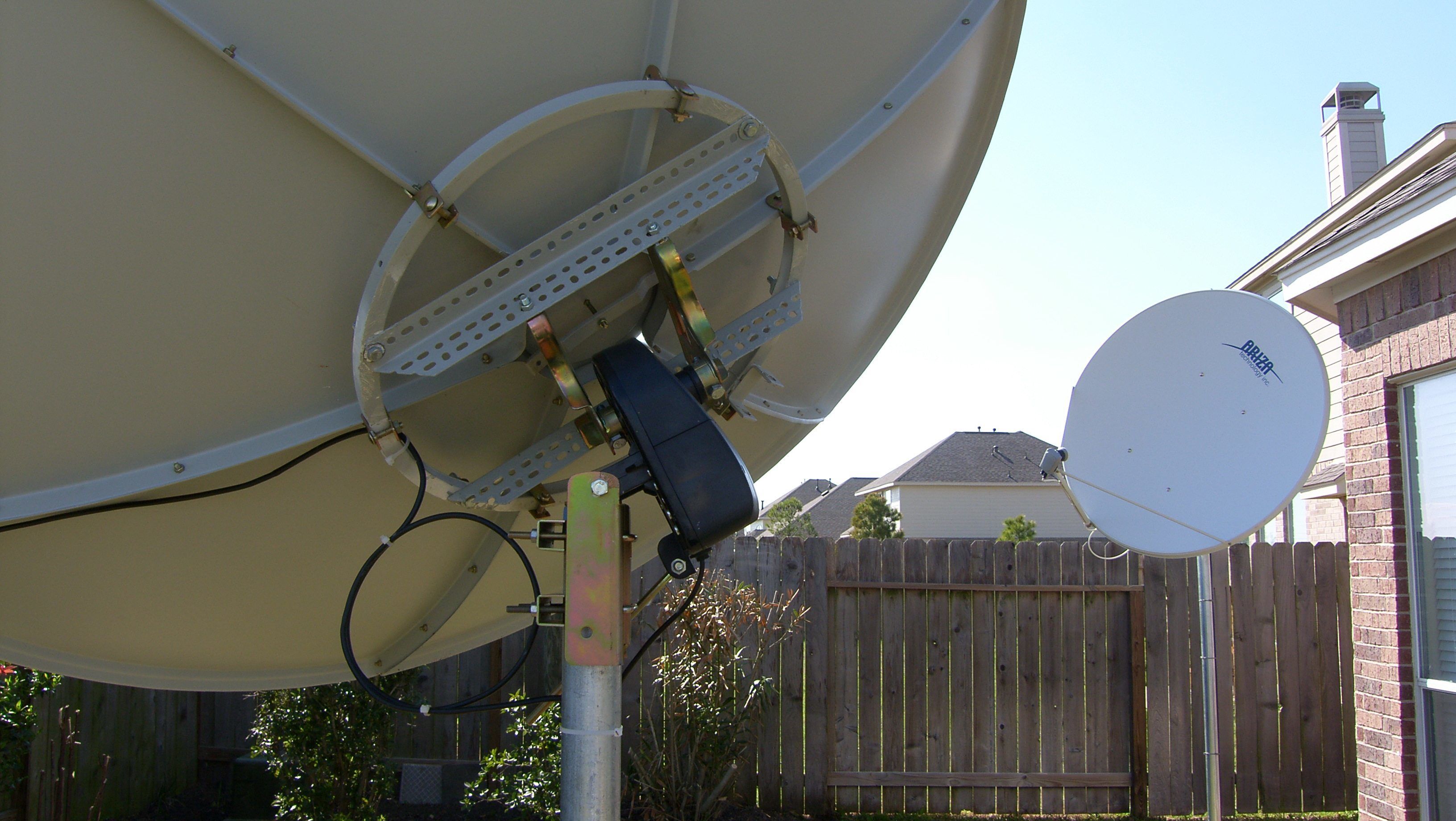

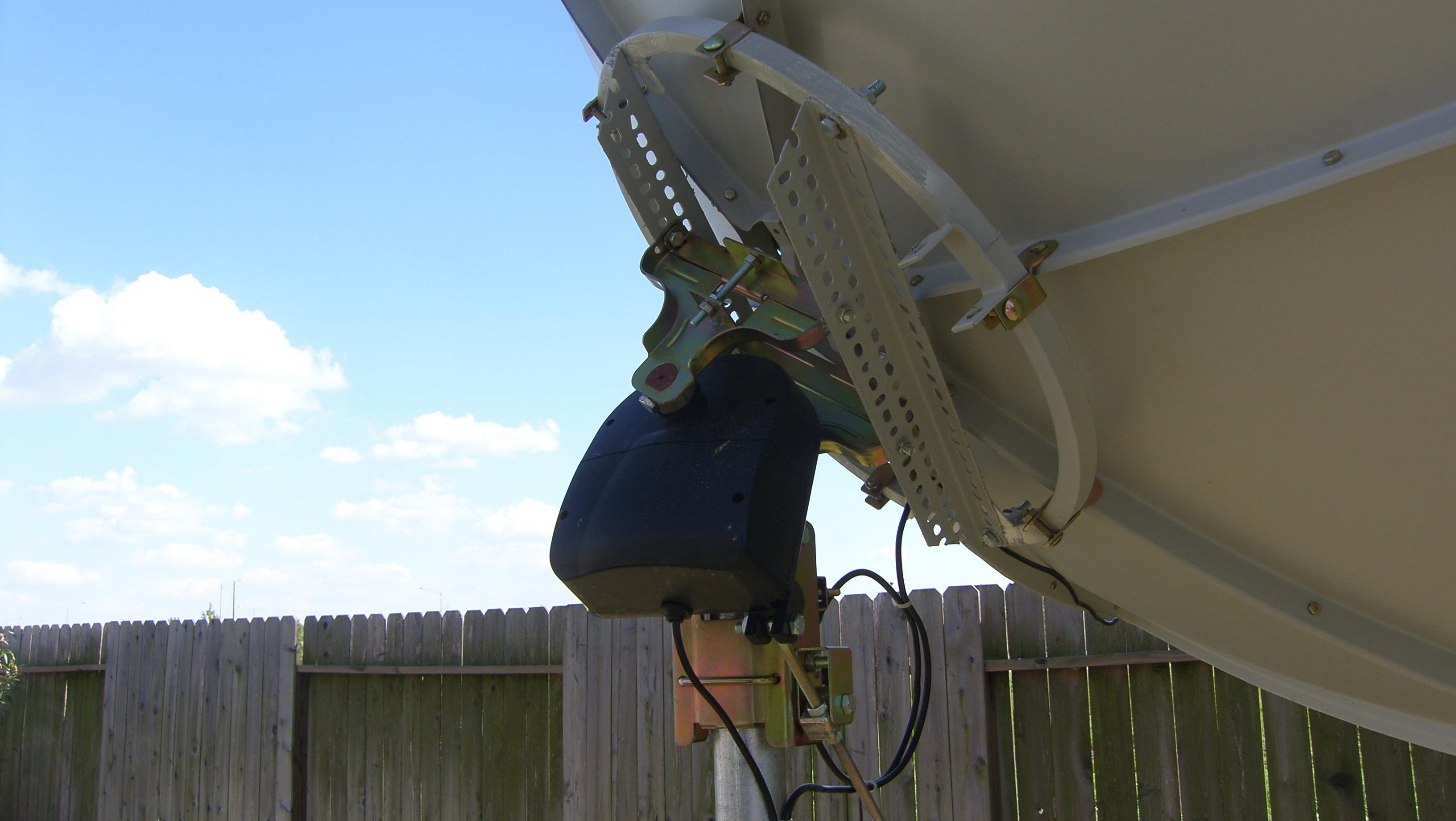

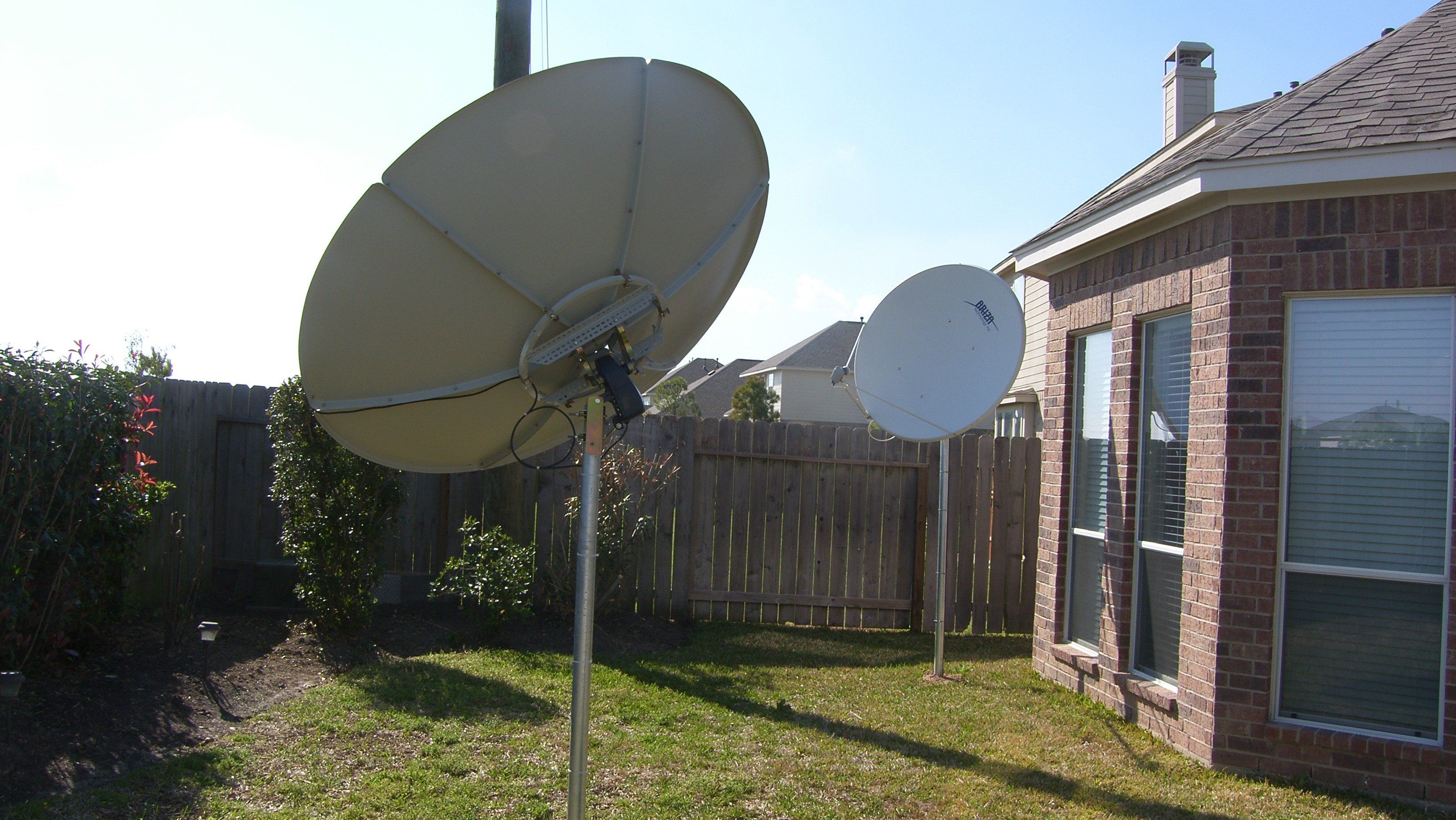

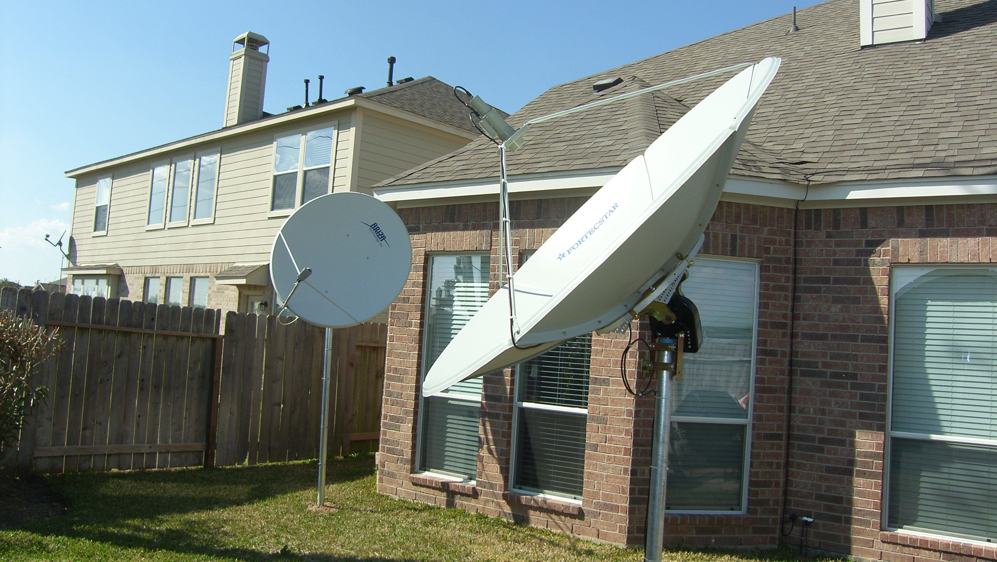

Now my 1.2m Ariza technology dish will never be alone again. I just completed the installation of my 6ft fortec Star on H180 motor. I had to go to HD and get the L shaped metal, cut it and paint it to match the dish color. This new baby is hooked to a gbox and can track the arc from 45W to 131W. The 1.2m in the background is now dedicated to Ku only. Let me know what you think. I believe in very neat installations.

sanjap, nice setup, just wondering about the motor? who makes it and were did you get it? Never seen one like that before.

It is an H180 motor made by moteck. Sadoun used to carry those. Unfortunately I had to beg Sadoun to search his warehouse to see if any was lying around. Luckily for me one was lying there. I grabbed it at the speed of light. It is super fast and it is very quiet. I wish Sadoun could import more. It is way better than an actuator. Covers the arc more from 15W to about 145W. But remember it is for 6ft dish maximum.

Very nice looking install, I think unless you live where the wind dont blow I would have used heavier angle, just my thought.
Cruzin, what do you mean by heavier angle? you mean the pole? That is a rigid 2.5' conduit pole Very solid in concrete

If the metal stock with the holes in question is like the "Metal Lumber" brand if I have recycled for all sorts of projects, it's very strong.
