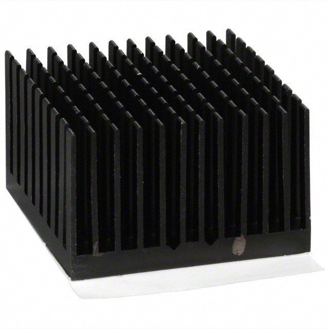

Regarding Heatsinks, why not use larger heatsinks? and why not use the kind with the thermal adhesive tape that many CPU heatsinks employ?
Digikey dot com has an extensive selection of heatsinks and every electronic device/component available on the market today.
24.5mm_X_40mm_X_40mm_heatsink
They have hundreds of heatsinks to choose from. In fact at a quick glance/search I found the one I posted in the photo that measures 40mm X 40mm which appears to be the same dimensions of the 9200 and it's 24.5mm tall, this may be one to consider and it's about $10. There are many to select from and I'm sure there's available space for a much taller heatsink and maybe room left to mount a thin fan atop.
I would also like to share this web page, a heatsink guide, I haven't spent anytime searching it yet but it looks like it can offer tips and answers to questions. Heat_Sink_Guide
