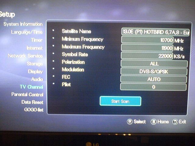

On Rick's board, a user says that the latest daily build has blind scan. Anybody tried it yet?
I havn't tried it yet, but I saw these pictures from another website.

If you can only scan one symbol rate at a time, that's kind of useless. I wasn't expecting anything spectacular without hardware support, and it sounds like they didn't disappoint :(

Yep it does, and it doesn't. Oh, it looks like it alright, but you have to give it a signal rate, and it scans ONLY that signal rate. If for some reason you know the signal rate, it will find the frequency for you.....otherwise its useless. :rant:
The forum I was on said if you put the symbol rate to 30000 it will scan up to that,he said he found channels around 27500,this is in europe.
The new firmware has "Poor Man's" Blind Scan
You set the Freq Range, FEC, Modulation, and Pilot if dvb-s2
Freq: 3700 - 4200
Scan Rate: 29270
From what I read from other sites, the AZBox will scan up to the SR you input. So lets say you input Symbol Rate of 12000, it will only scan up to 12000 symbol rate. I will test it when I get the chance. It's a start though!:)
Nope. I scanned Galaxy 19 Ku with a 22000 S/R, all it found was ONLY the channels with 22000 S/R, nothing else.

I have a couple Dummy Sats setup as Poor Man's Blind Scan, 102 TPs all with same Scan Rate
In what universe is that useful?
Don't get me wrong, I wasn't expecting a miracle, since there's no hardware support for it, but they kept claiming that they were working on a way to make it scan in a reasonable time. I suppose this does, but I don't know why I'd even want to.
so the blind scan is useless then
unless you scan symbol rates like 13021, 13235, 29270 or 30000 for sports feeds
My "Poor Man's" for TNT DVB-S2 takes about 15 minutes to scan the 102 TPs

Ok, got it working. Hard reboot needed. I set 17000-12200, SR at 32000 / S28PSK on 125w AMC21.
Scanned in everything, dvb included and Montana PBS with a SR of 4340.
So I tried again but:
Deleted all TPs
Deleted all channels
17000-12200, SR at 32000 / S28PSK on 125w AMC21 and
17000-12200, SR at 32000 / DVBS on 125w AMC21.
Got nothing.
So 'blind scan' was just scanning my saved TPs. Big wup!

I scanned AMC15 knowing there was a cbb game on there
set the s/r for 30000 (big 10 feed) and said scan
It said it found 6 transponders, 2 new ones...the 4 "old" ones were already logged in there
-macy's
-echo test card
-2 feeds from this past weekend I hadnt cleaned out yet
and for some reason it logged the TP for the bb game twice
-one at 1mhz below the "known" frequency (compared to the Coolsat 5000)
-one at 5mhz above the "known" frequency
so its kinda working but again you have to know the symbol rate. It scans in 5mhz steps when it scans
