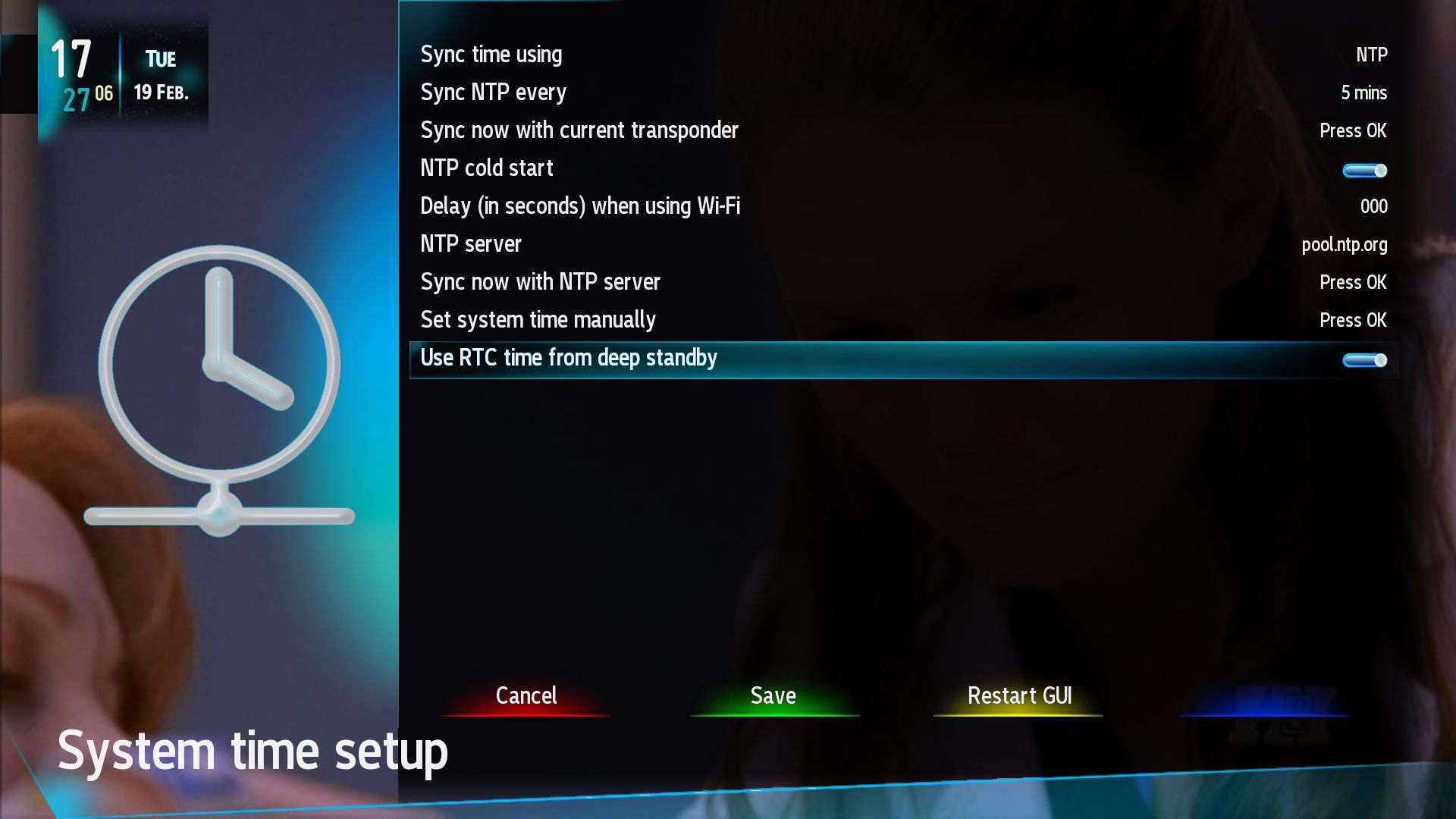

Also, Johnny (and others) make SURE you have your time settings set like this, or it can drift off after REBOOTS (until the time you set to auto resync) The "NTP cold start" and "Use RTC time from Deep Standby" are the most important ones

The NTP sever change didn't fix the problem. There are other NTP servers that I can try but my routers don't have any trouble with us.pool.ntp.org. And only OpenVIX is having trouble with time sync. OpenSPA, TNAP, and OpenDroid don't have a time sync problem. I'm trying north-america.pool.ntp.org now.
Did you reboot after each change of the settings?
Did it happen after an OpenVIX update? We could check if running different builds. Odd that OpenVIX is keeping NTP referenced time on a few of our systems running OpenVIX, but not yours.
