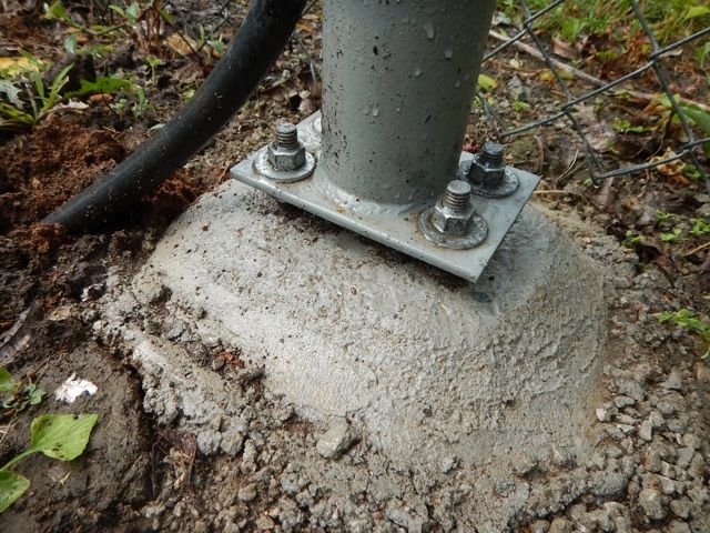

To allow for adjustments - a rebar cage with attached J-bolts could be set in the hole, then place concrete around the rebar cage and fill hole. For the pole, weld a plate to the pole with holes drilled to match the J-bolts. You'd wind up with a strong base and an ability to adjust for ground shifts.

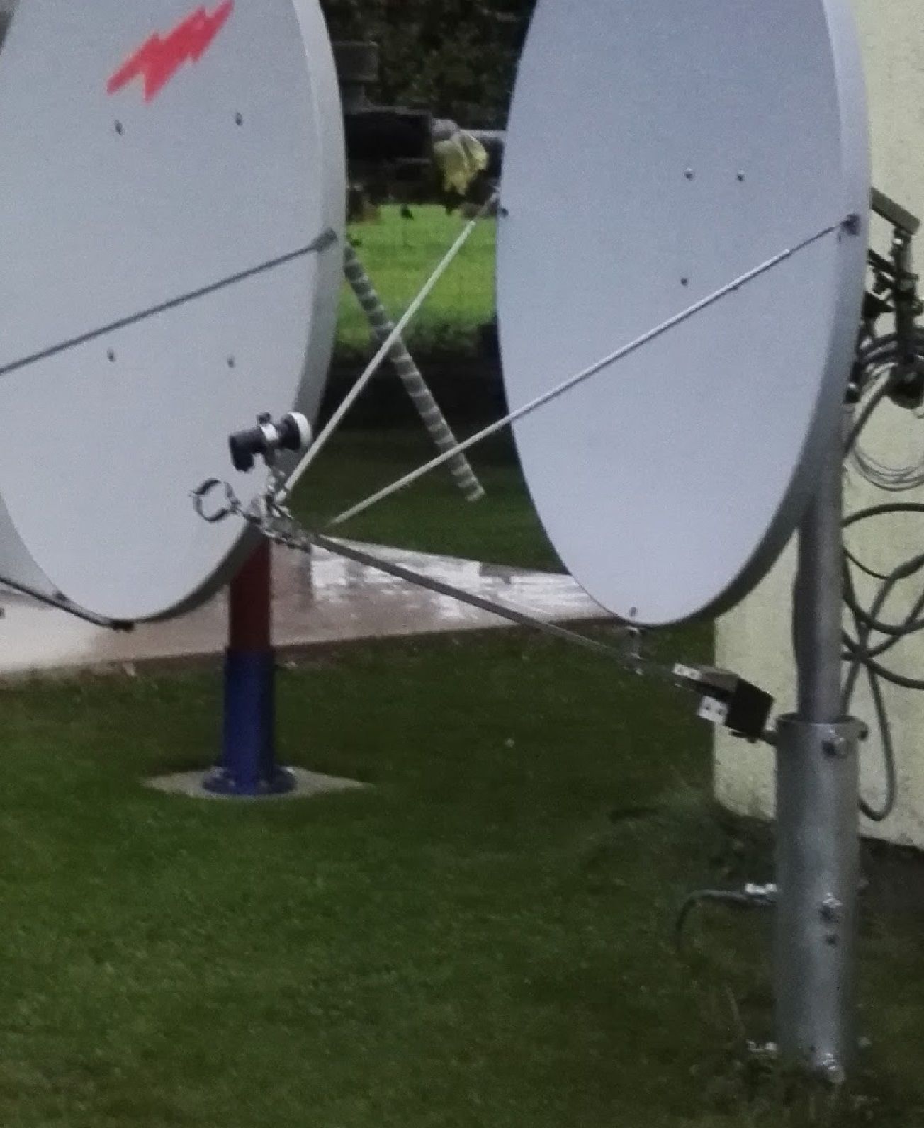

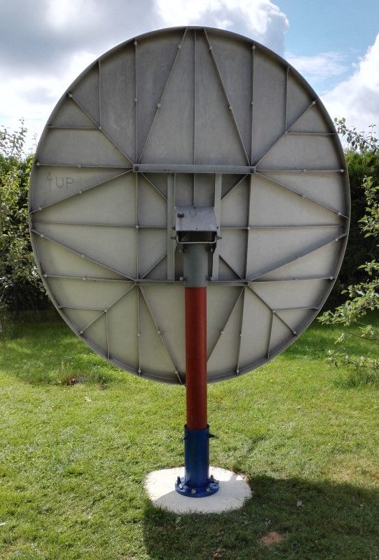

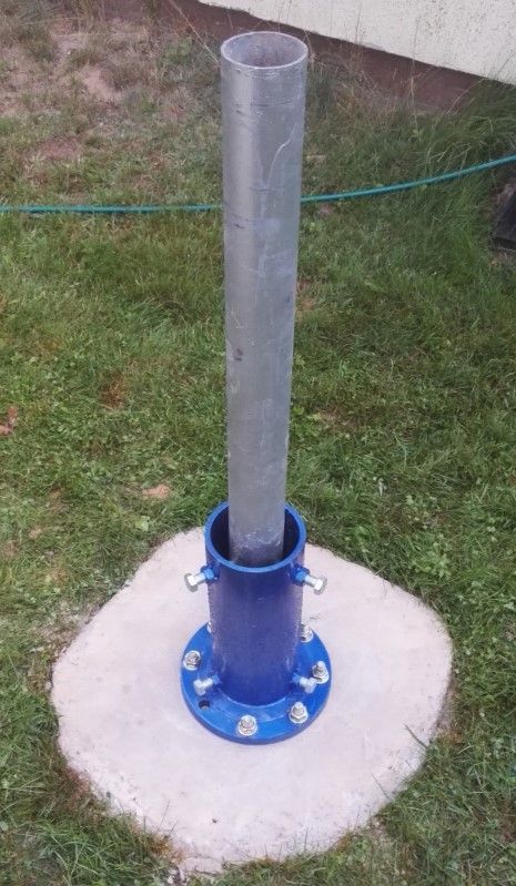

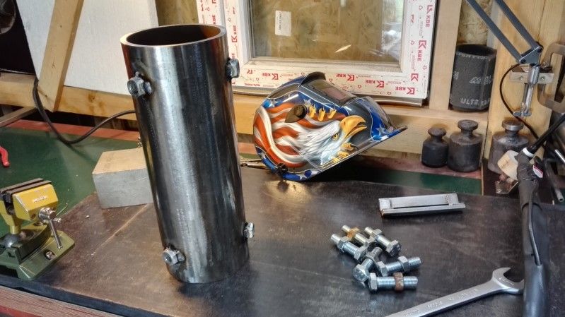

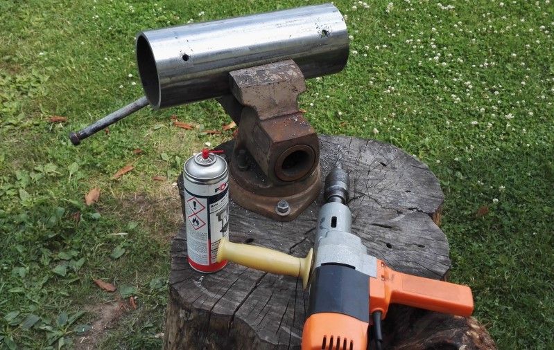

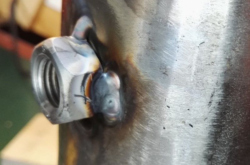

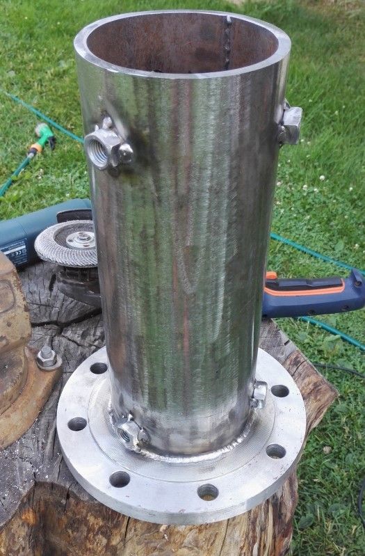

I did it this way (perhaps I was already posted some pictures): Took piece of pipe, drilled 6 holes on it, welded nuts to the holes, welded flange. Used anchor-bolts to attach construction to the concrete block (~50cm wide and 125cm deep). Any pipe can be adjusted inside and made plumb. For 1,8m CM dish I used 120mm pipe.IMG_20160626_144539 (Custom).jpg IMG_20160626_160228 (Custom).jpg IMG_20160626_160238 (Custom).jpg IMG_20160626_174003 (Custom).jpg IMG_20160728_212222 (Custom).jpg IMG_20160729_114032 (Custom).jpg

That's probably the smartest way to plant a pole. It gives flexibility to mount different poles/dishes in the future!
Thanks. Yes, that was my objective to make installation as universal as possible. I already have 2 of such a mounts and pretty happy about them.

So, did you just happen to have a spare 300lb or 600lb weld neck flange laying around?
