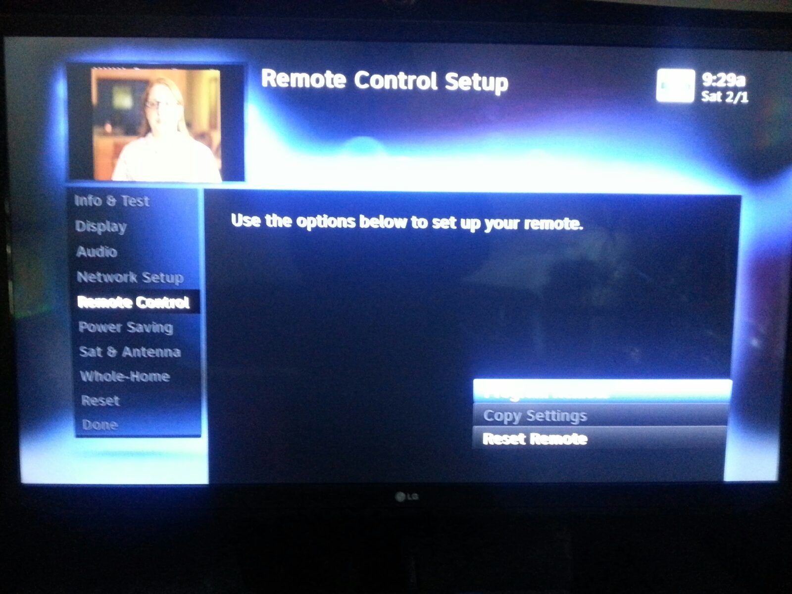

This is where I got last time. There is no option in the menu. There is no advanced settings or anything like that. I have not checked on the Genie unit, though, since the remote with my Genie is non-RF according to pino's post.
Is ur system currently working? If not, the menu will be different, the system needs to be working to be able to setup remote
Sorry for the glare. The selected option is "program remote" and there is nothing in there about RF/IR.
If I select it, it tells me to make sure nothing is in front of the TV. Then AV1, AV2, TV, (nothing Directv related), then it starts over.
Are you actually using an RF-capable remote for the HR34?
After you select program remote, it should give you AV1 and 2, TV then advance. If not then your remote is not RF.

The RC65RX remote does not seem to want to accept my TV or Denon. I switched it back to IR mode. I tried to set up my Denon and TV. On AV1, it says "sorry, your remote could be set up..." and when I press TV, i get the error sound.
I'm wondering if you have a bad remote. My denon, newer, programmed just fine excluding the power on and off buttons.
Do NOT switch it back to IR mode. When it is in RF for the HR34, it is in IR for everything else.
With the remote/receiver in RF mode, you then need to follow the instructions for programming the TV. You can't set up the Denon until the TV mode has been programmed.
