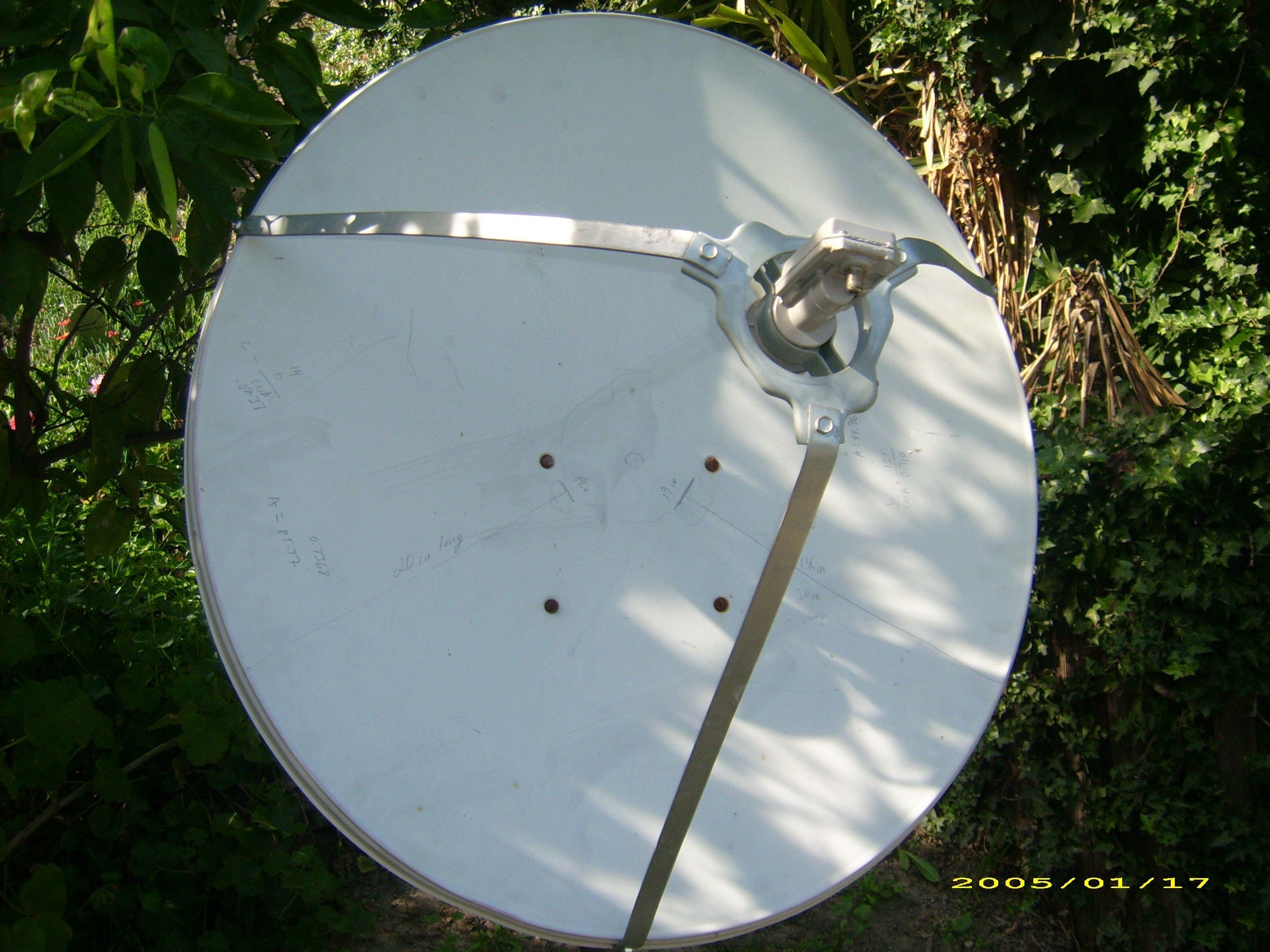

It looks like an offset dish to me, but you've positioned the lnbf like its a prime focus dish. Assuming that it IS an offset dish, your lnbf is NOT at the focal point. I don't expect you will be very happy with your reception in this configuration.
Me three.
Plus even if the dish were a prime focus (and I've seen some which are), it's not going to have a narrow enough beam width to do much on C-band.
We've been over this all before, and a 1 meter dish will get you just a taste of C-band.
For equipment, I'd suggest a C-only LNBF like the C2 from SatelliteAV, or the DMX242 from Galaxy Marketing see top of any page).
They're quite inexpensive.
That'll work well on any actual mini-bud or six foot dish.
Use your little dish the way it was intended with a Ku LNBF, and you'll be better off.
