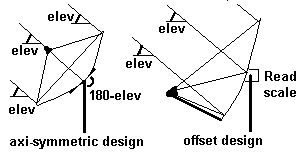

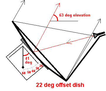

Keep in mind that with off-set dish the signal comes down from the satellite at around 22-24º higher than where the dish seems to be pointing. So you may not need to go as high as you think!
