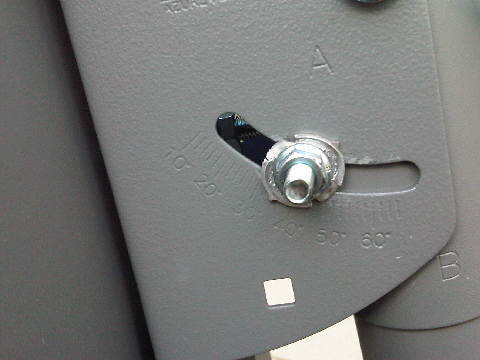

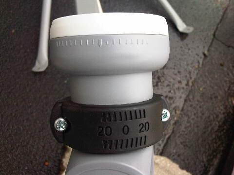

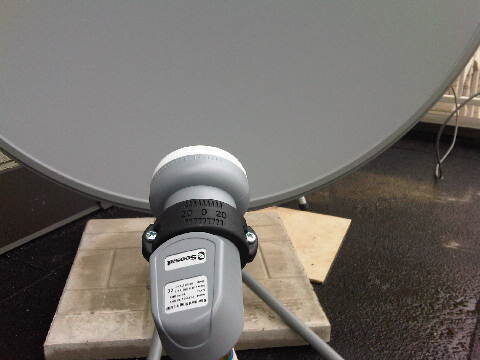

How about some pictures?? ** dish & lnbf - Label on LNBF - elevation scale - receiver setup screen with S & Q meters, LNB setup screen. maybe someone will see something.

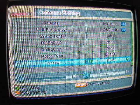

IF your LO is off .... or IF you are near the Wrong Bird, and you are showing signal (I believe with a squealer) then Blind Scan. You will not show quality on the STB unless you do have an active transponder (usually) as the first on the list. If you are close and can pull in one transponder then peaking that transponder and rescanning will give enough information to let us help you get spot on.

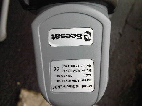

LO is local oscillator. I think I remember your LNBF being a normal linear so that is the 10750 as I remember.... It took me 15 minutes to type my last reply and there were 3 replies made while I was typing mine!
At this point, do not worry about that now. when the squeal is the loudest, turn off stb power (not standby) and remove squealer and then blindscan. Many times the squealer will block the signal to the box...

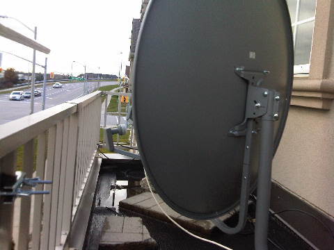

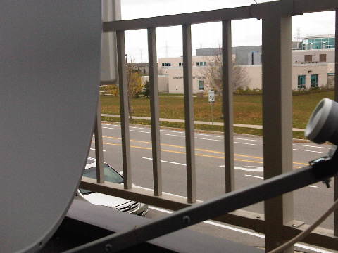

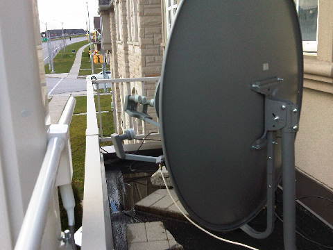

Could you Aim the camera along the bottom edge of the LNBF arm so it looks like a single pointer from one end to the other? From here is appears the dish may be way low and pointing into the railing or the buildings. Probably is my eyes... but it looks way lower than mine and you are not that much further north than I am.
Along with "Tp Freq: 11836", Polarity and SR have to be programmed. I.E. freq= 11836, Polarity = Vertical, SR = 20765. This would be the 'Transponder Programming'.

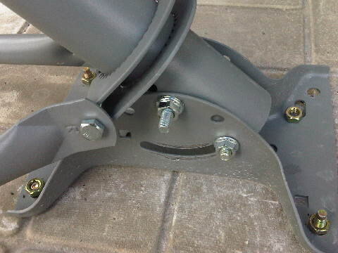

Not sure I really got what you meant, but I took some more photos, including the LNBF scale and info.

Really doubt that a .2db NF LNBF is the answer. I've got 20 some year old LNB's with a ,then, NF of .7db that still work well. Aged they're probably closer to 1.3db.

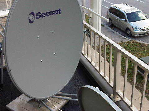

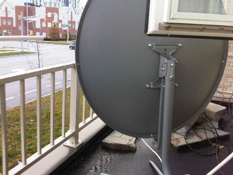

And along with rvpop, I also thought it seemed that your line of sight might be obscured -- if not by the tall building, then maybe from the railings or the other satellite dish (a bit hard to tell from the photos, but a possibility to consider). Sometimes the dish elevation is also a bit off, so try ever so slightly tilting/pushing the dish upward and see if the signal improves...
is the pole the dish is mounted on level(pinted straight up)? it looks like it's tilted forward a bit which would render your elevation settings inaccurate . Just eyeballing it, it looks like your dish is pointed at the horizon which is way too low for 97w. where are those other dishes on the balcony pointed at? I'm assuming dish network and expresssvu? If so then 97w would point at halfway between the two azimuth-wise

I use a .2db LNBF at least that it was advertised for, but thinking that it is a .4db or worse. Some companies may not be very truthful about specs. Besides I played with an 500 dish a while back using the same LNBF and still was able to get a few channels on 97w.

Set the dish on a table to raise it enough to get a view over the railing to see if that helps any.
How far is the building away across the street ( your aiming direction ) and how tall is that building.
