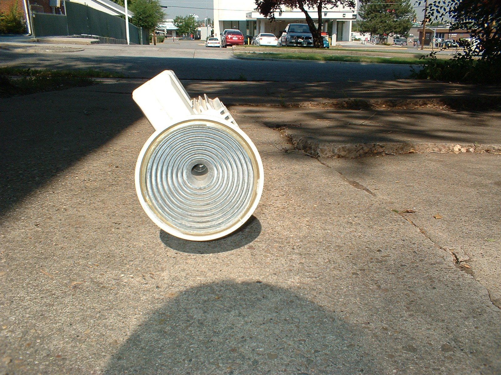

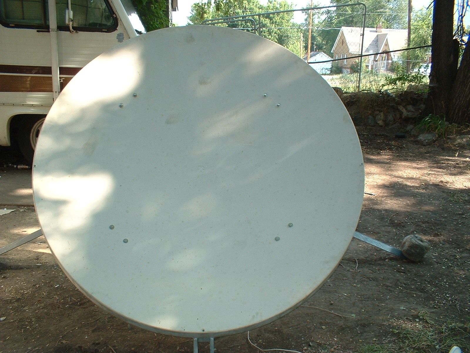

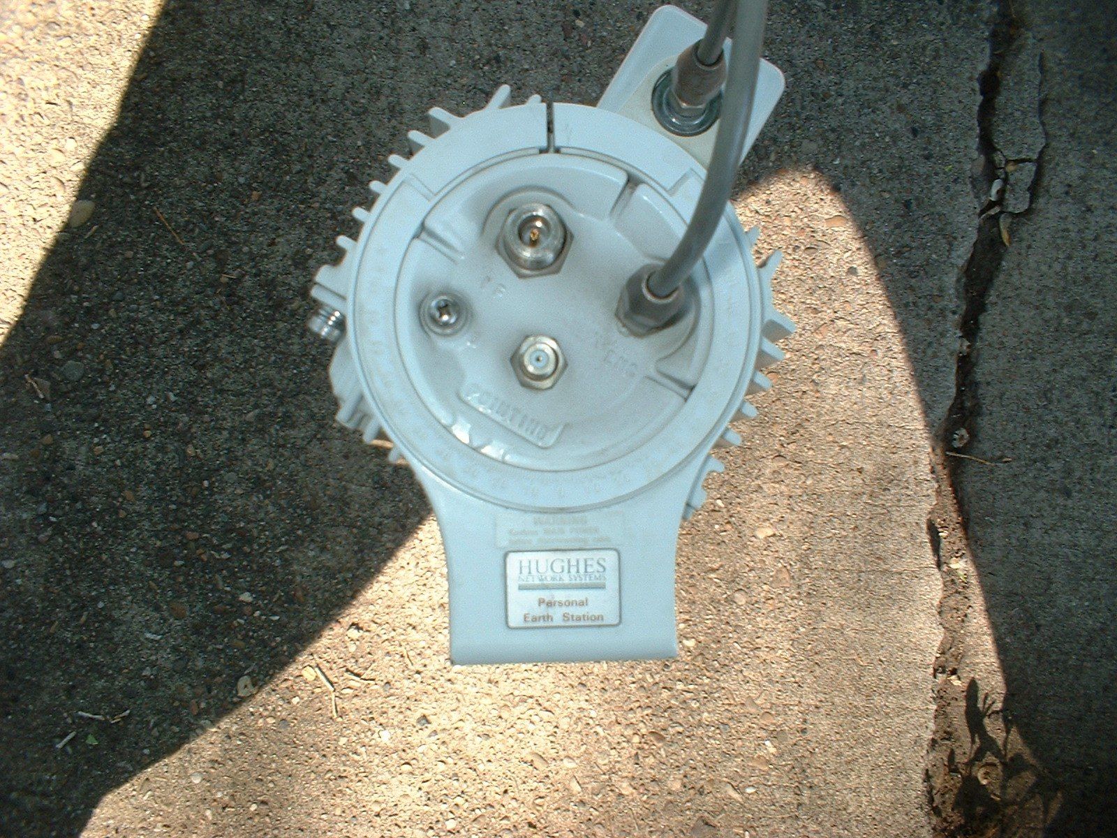

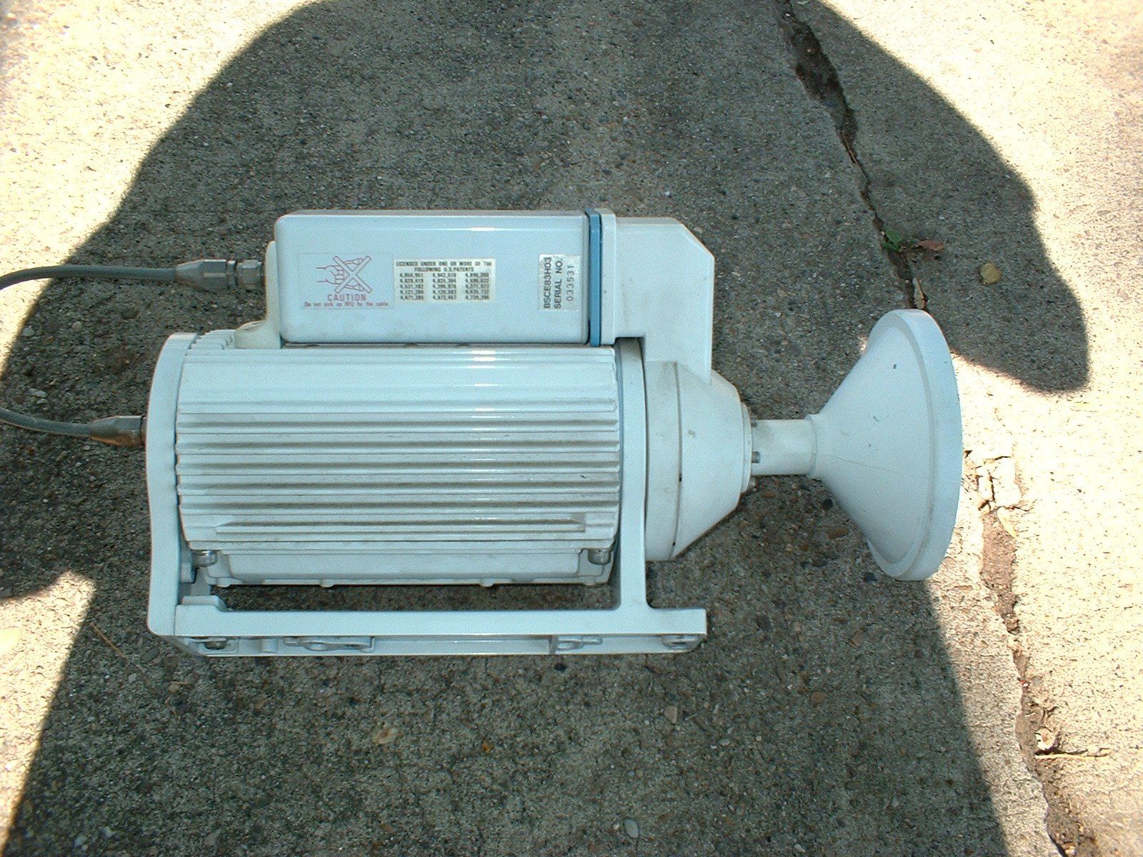

Here is some pictures of the dish and LNB.
I don't understand all of the connections on the LNB and I can't find any information online.
There is also a similar dish at the same place i got this one.
would it be worth it to go get it?
Thanks!
Dave.

Its a sweet dish! I would get the 2nd one just for a spare :)
The LNB seems to be on top of the transmitter, so just one coax from the DVB receiver (when you get one) to the LNB should do the trick!
NICE find! (x2)

Looks like you've got a LNB/Dish from a credit card machine system ;)

It looks like one of the hughes setups for credit card transactions.
You may want to contact one of the techs at hughes and get some info on the lnb.

Nice VSAT dish! Looks like a C-120 flange right after the feedhorn and before the transmitter/waveguide. You could always bolt a C-120 Invacom on there if all else fails!
