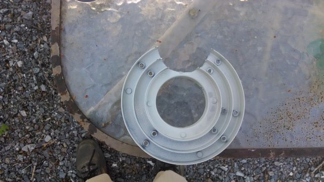

Not sure how much closer my LNBFs need to be on the 8.5 footer compared to the 10 footer for
4 degrees of separation.
I am planning 99W on the center LNBF and 103W on the one on the right (facing the dish).
I will probably start of with this scalar to be on the safe side:
