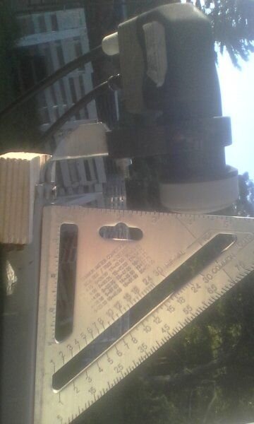

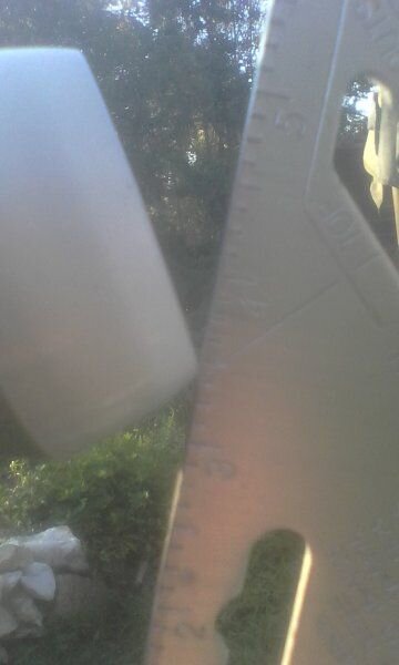

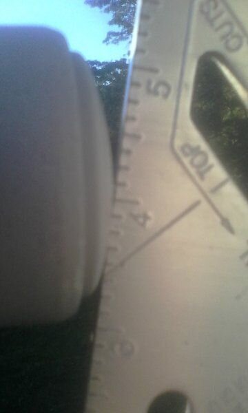

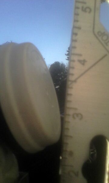

It was given away without the Directv feedhorn present. The feed arm stretches 18.5 inches from the front of the dish. I'm not sure how to find the focal point from scratch. The LNB bracket hasn't been bent from the angle I bought it in, new, so does it need to be bent and/or what degree of up/down on the 10-0-10 slider should it be set to? The bracket is clamped dead center, pushed all the way in.
Haven't even been able to find a diagram of what polarization that is, or if 0 on the bracket in line with 0 on the LNB is horizontal or vertical.

First of all though you have your LNBF rotated 90º . With the F-Connector pointing down you will be a zero. Then you need to go from there to see how much you need to skew it for 97W for your location. This is where dishpointer.com will come in handy. Remember to move slow as receivers are very slow at locking where a good meter will grab it quicker than you can move your hand.

Don't have a DirecTV dish to advise the correct LNBF position. Could you borrow one to make a template?
Looking at photos online, the feedhorn opening needs to be higher and the focal length distance appears to be too far way.
It will be very difficult to both find a satellite and set the feedhorn position. The feedhorn position affects the dish elevation angle setting and will have very poor performance if not positioned in the exact convergence point of the reflected signals. Not impossible, but with 30+ years satellite installs under my belt, I wouldn't want to take on the job. If you are going to try KE4EST's suggestion for hand-holding the LNBF, be sure that the dish is set to the correct elevation and azimuth for the target satellite.

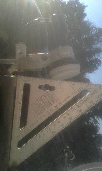

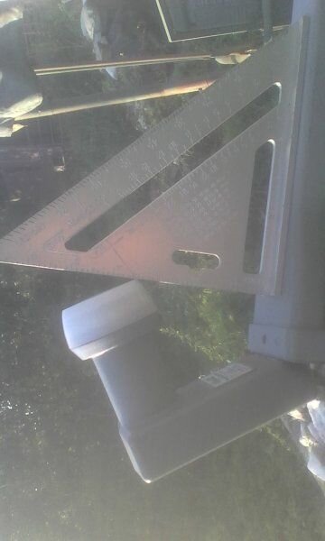

A 18" Directv dish will be worse for reception and is still a offset dish. Titanium was right about the feedhorn opening needing to be higher, you need to raise the Lnbf up an inch or so. I have three Slimlines setup here, I'll try and post a picture tomorrow of one of them so you can get a idea of the lnbf placement.
Reactions: KE4EST
So, an inch or so would put it closer to the apex of these shoelaces, either by extending the "universal" bracket past its limit, or? Not moving it up the feed arm by drilling a hole further up it, towards the base of the arm/dish?
P.S. I disassembled the 4 arm bolts, there's no way I can see to adjust where the tip of the arm ends up.

It has been a while since I did this and would have to start from scratch again myself. But, do a google search for finding the focal point for an offset satellite antenna. There are methods of using string and sometimes water, to get the correct measurements to calculate the focal point. It won't get you dead on, but will get you close enough to get signal when properly aimed at a satellite, then you tweak it to get the best.

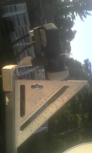

Though, since you mentioned water, my latest search results found John Legon's page "Calculation of the Focal Length
of an Offset Satellite Dish Antenna
" & word searched for 'water', finding it at the bottom. I guess after dinner I can make a level birdbath, measure it, and replace his values with mine, then stretch my measuring tape out from the center of the tip of the LNB to the focal length result from that calc.
(20.75 * 20.75 * 20.75) / (16 * 1.4375 * 20)
was converted by DuckDuckGo to
((20.75 * 20.75) * 20.75) / ((16 * 1.4375) * 20)
=19.42211277174 or 19 7/16
Taped 19 7/16 to the center indent of the LNB & 0 on the dish after having to push the universal bracket angle forward a bit to get the tape 0 to touch. There was this little abrasion in the paint (at 11.5 inches out of 22" on vertical axis & 16" out of 32" of horizontal axis, I only just measured now) I had noticed while cleaning the dish days ago, and it turns out that's probably what was previously marked as the focal point (By the DirecTV installer? By the dish manufacturer? By the last person to use a universal LNB clamp?), as it's where my tape 0 ended up, as close as a straight line I could get from the LNB without clamping in a boresighter or laser pointer (mine got ruined by battery leak).

Here's some pictures of my Slimlines. One you might see the lnbf is lower and crooked, that's because the reflector on that dish is bent, the guy removing it threw it off the roof it was on.
IMG_20170915_180033.jpg IMG_20170915_180023.jpg IMG_20170915_175941.jpg IMG_20170915_175856.jpg IMG_20170915_175828.jpg IMG_20170915_175813.jpg IMG_20170915_175625.jpg
You don't need the 21v inserter for FTA.
After a horizontal flip & rotation, mine looks just about like your last photo (ends in .128216 when you hover pointer over it) but for the difference in equipment. So... does anyone disagree, focal point solved?
