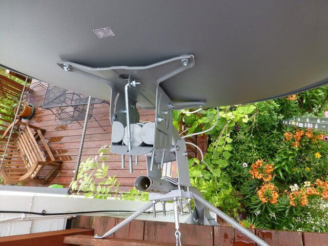

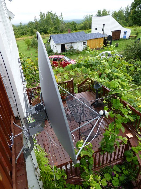

Pictures!
Nice pics! Thumbs up!
Off the ground but still accessible for adjustment and snow/ice removal. Hope you had some help mounting that up there?

Thank you.. Yes, with it being off the deck, it is very easy to access it. And being where it is, it really doesn't stare you in the face from anywhere. I will be tucking all the wires down in the next day or two. So proud!
Unable tell by looking at the photo... not sure if the dish will contact the railing when aimed towards the eastern or western ends of the arc. Did you know that the J-pipe (mast) could be flipped end for end so the pole reaches outwards away from the wall rather than the current install setting for height? :D
Sorry to rain on your parade. Have to agree with Titanium a dish that size should be further out away from the deck railing.
Having the braces attached to the deck may not be secure in the long term. But I have to agree it is easy to adjust from behind. Just don't fall off the deck.
Nope. It's "ALL GOOD". I can go between 72 and 125 with many inches to spare.

I can adjust it through the railings. No worries of falling. It is very secure, plus, i added the additional anchor brace via a butterfly tie and chain. The main brace is connected on a 2x10 board.
