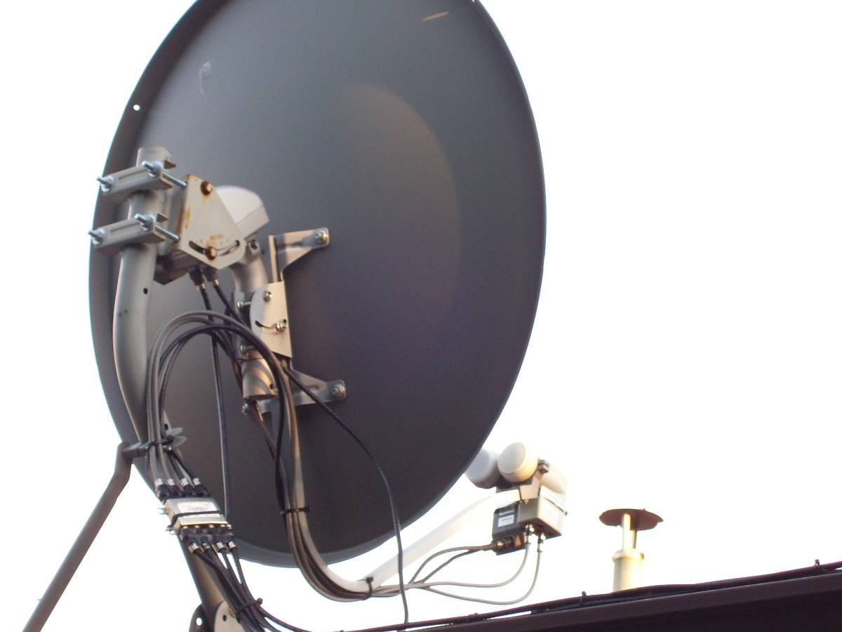

Here is a pic of my motorized with the 4x4 switch. Have both the KU & DBS LNB's on the 4x4. One line runs to the motor and the other 3 run into the house. 2 go to other diseqc switches for other receivers in the house and the 4th is extra.
Nice work!
