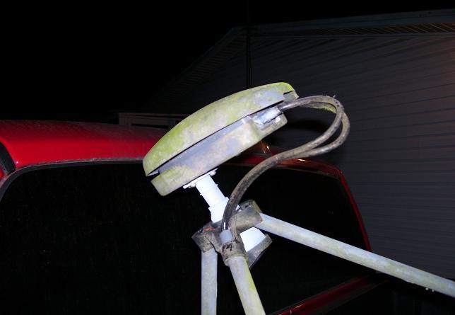

The "dovebar" LNB is kinda rare too, I have one. :D:up
Here's a pic from when I first hauled it home.
