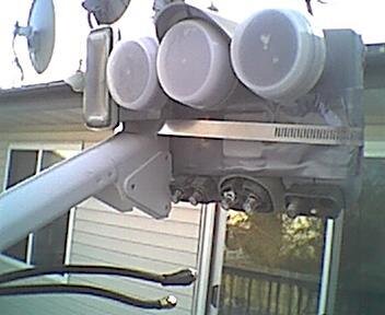

Some of my hose clamp projects
Dish fixed at 95 and DBS LNB's at 91 & 82
Dish fixed on 123 and DBS at 119 for audio
Dish fixed at 107.3/111.1 (for StarChoice) and add DBS LNB at 119
Dish motorized and DBS LNB next to it
I had for a little bit
Dish aimed at G10 (123) and LNB's on BOTH sides of it (DBS at 119, KU at 129 for Star Network)
Some LNB's are easier to work with than others (obviously the "block" LNB's (that look like DBS LNB's but are KU) work the best :)
Here is my setup when I had 95/91/82
closest LNB is 82
middle one is null (needed it as a spacer)
then 91
rectangle one is 95
THANKS! That makes sense! I ordered the Sadoun KUL1 standard LNB for my system, and by looking at the LNB's he has on his site, the KUL1 does not look "block" like. Their is a universal lnb that looks like the DBS. What would you recommend? This sounds like a viable solution to what we want to watch! THANKS! :-)
nah. Not the Universal. i have one of them and it doesnt work real well for that idea.
The existing one you posted should work better. You'll just need some type of a spacer (small piece of wood works) to fill in between the LNB's
