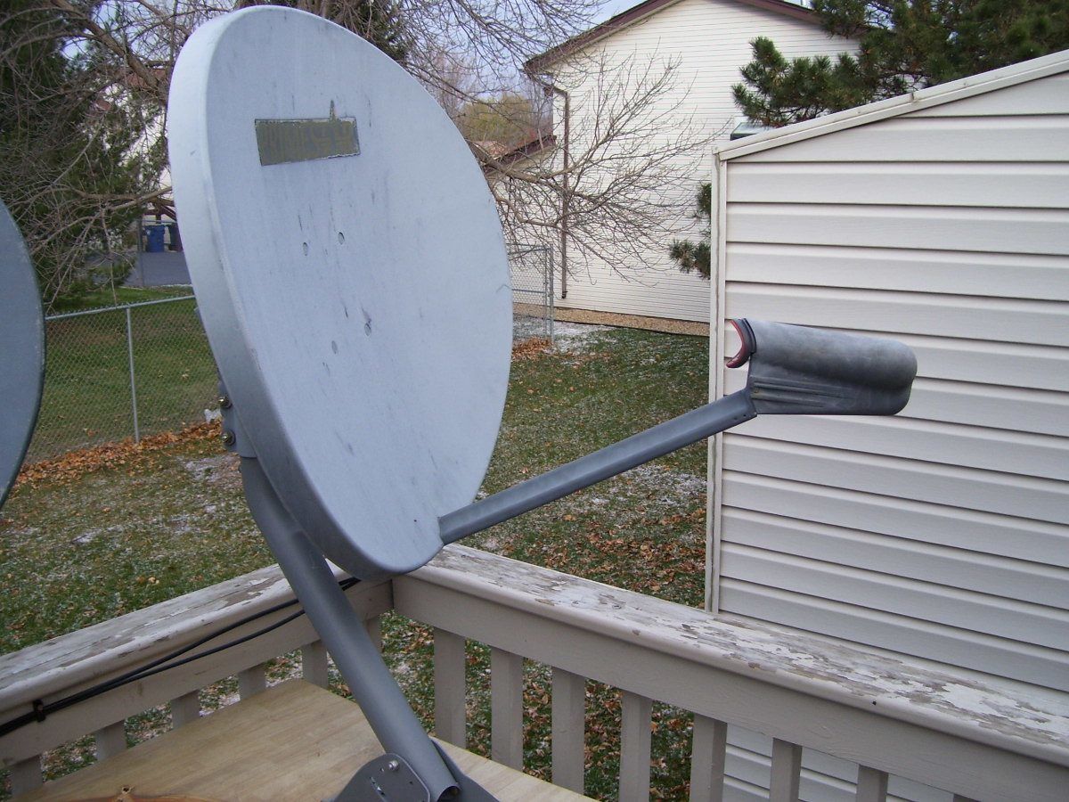

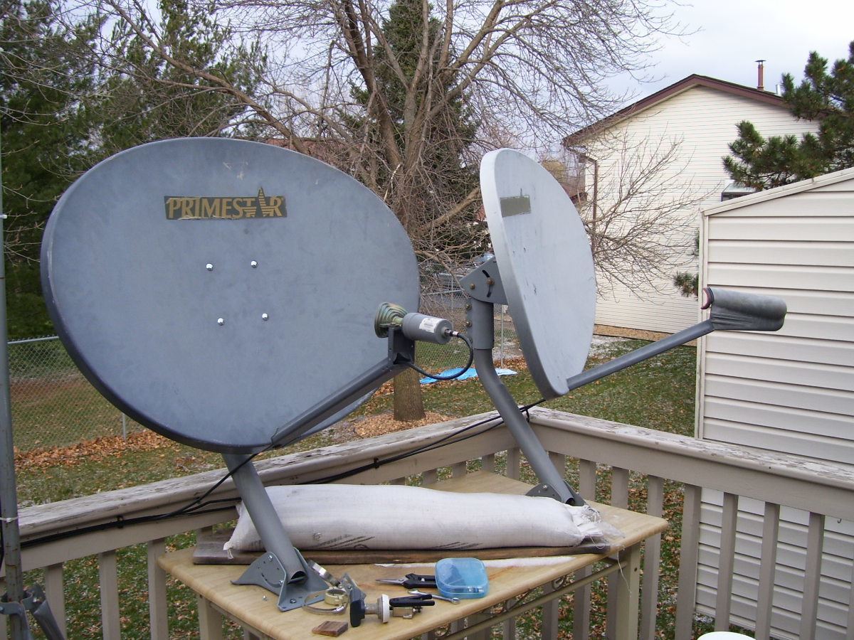

Here are the Pics of it. 1st 4 were done on Sunday when I set the dish up. The 1st pic is of both. The one aimed at SBS6 is the one I got on Saturday but the LNB is on the other one at G11 (which I found out the LNB was shot so that got replaced).

feeds. Main reason was the T90 is set up for 72,79,87,89,93,97,101,107,110 and already have a dish at 123 so that left 83,85,91,95,99 & 103 for a separate dish
83, 85, 95, 99 there isnt much on there (have a motorized for that). 103 I had it for but alot of the news feeds were very weak (we had this conversation a while back with a member who was in the uplinking business and those news feeds are at lower power) so that kinda left 91 :)
and with the LNB I have on there now (the DirecPC one) the LNB cant be skewed (the DPC dish can but not the Primestar) so 91 being 2 degrees off my true south skew is moot.
Primestar's can be skewed. It's not that much work either. You just have to mount a boat seat swivel between the reflector, and the mount. Almost bolts right up with the original holes on the swivel, only have to slightly enlarge them. Works real well, and you can buy them at Walmart. I mentioned this in a previous post a couple days ago here on site. I personally think the Primestar dishes are one of the best dishes ever designed. Free for the asking in most cases, so even better. I have about 6 of the large elliptical, (stored right now) and 2 of the large 40" ovals (installed), and they have killer gain, and that screw adjustment is the best thing going for the smallest tweak adjustments!

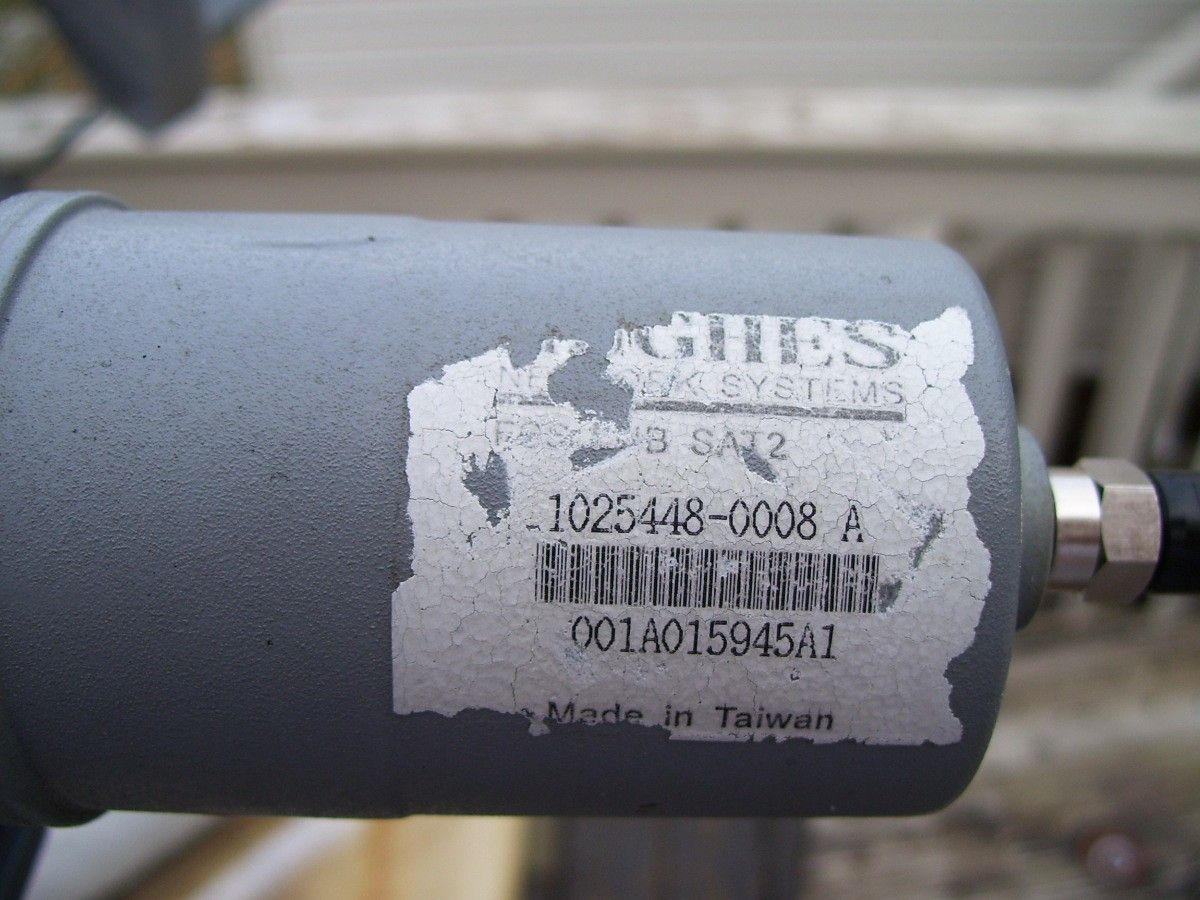

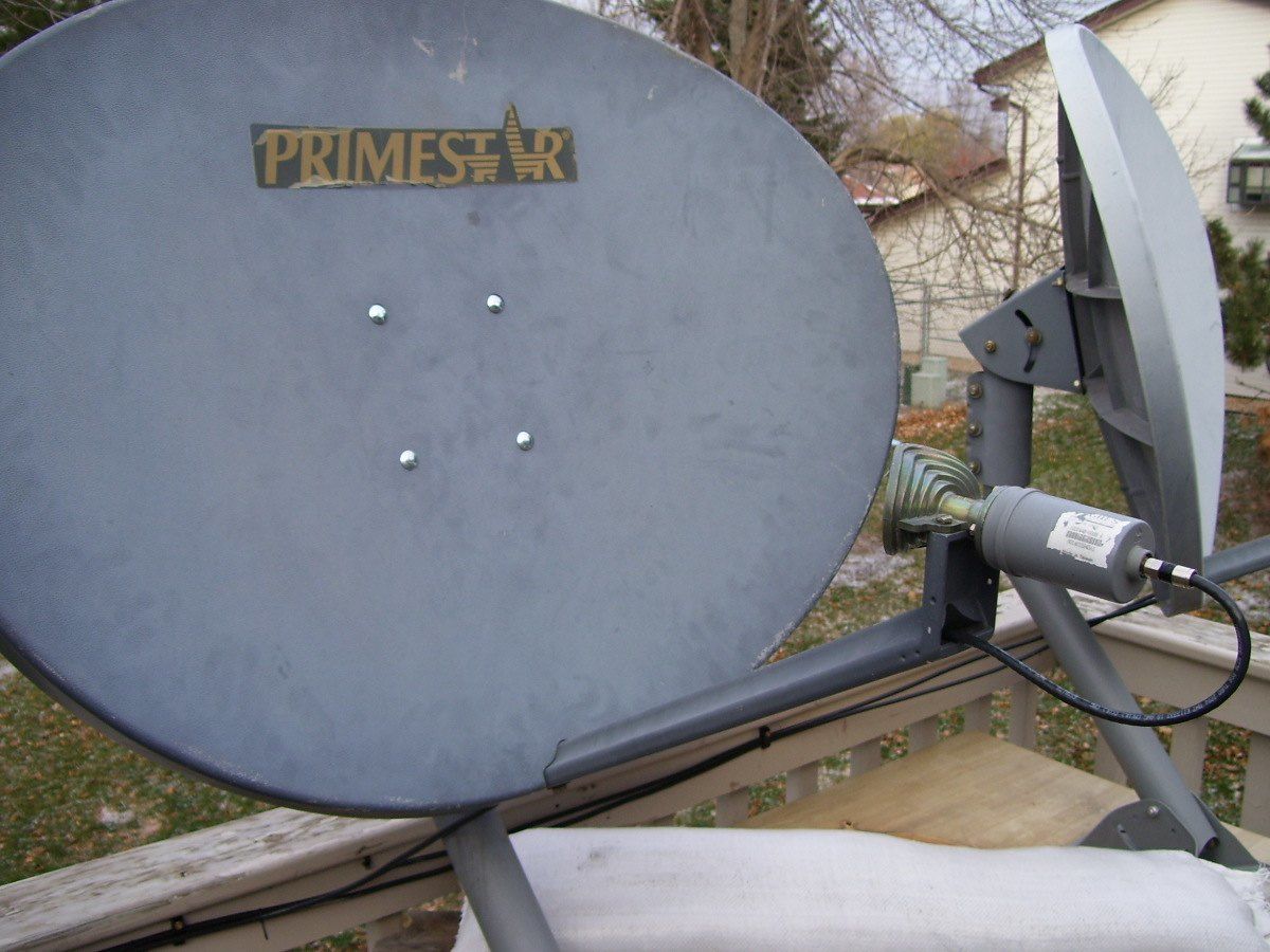

couple more pics :)
I switched the LNB on the G11 dish to the old DirecPC LNB

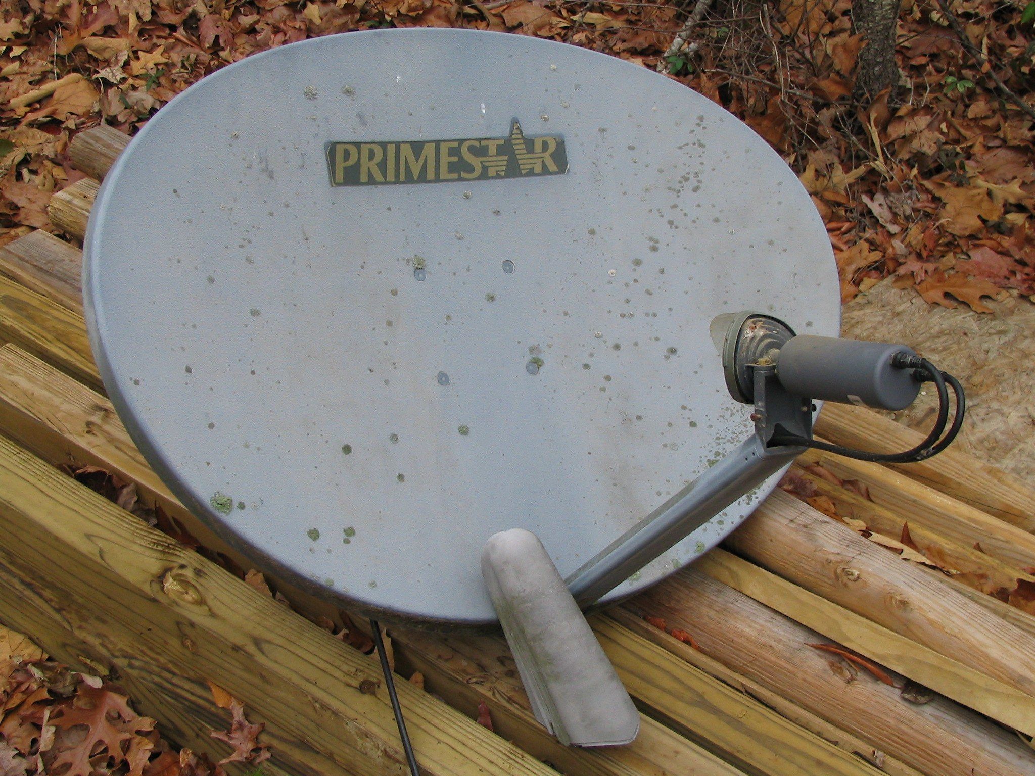

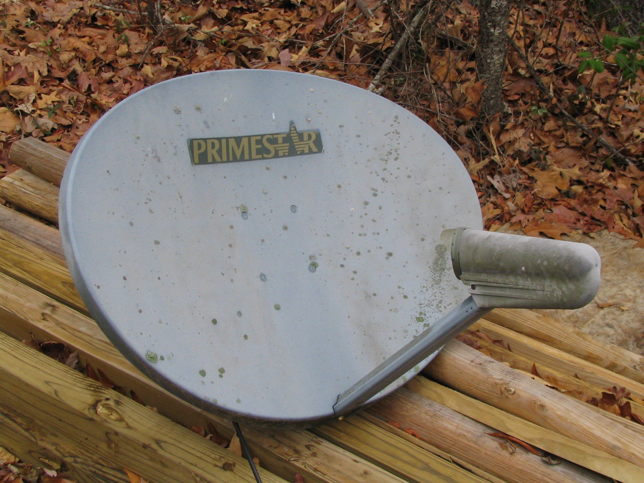

This one differs from my first Primestar. It has a cylindrical LNB labeled NJR2118F, instead of the flat, rounded rectangular LNB. It, like the rectangular version, has both V and H outputs.
I placed the dish on an existing wall mount (with some shimming) and pointed it in the general direction of AMC3, with the proper elevation. Connected up the Fortec to the V side, set LO=10750 and a known TP and checked the signal. Nada. Not even the usual 0-6% dance that the Fortec meter does, which seems to be the indicator that the LO is set properly. I changed to 10600, and there was the 0-6% "noise" but no signal, no matter which way I moved it.
I pulled the cylindrical LNB off and mounted the LNB from the first Primestar dish and dang if I wasn't pointing right at AMC3 and hitting about 40% quality!
So I have to believe the cylindrical LNB is a different LO, or is bad. How often do LNBs go bad? Any idea what LO this LNB is supposed to use? I Googled the LNB, but there wasn't a lot on it. Some mentioned 10750 and some 10600.
I'll guess I could pickup another LNB for it anyway, but I am curious ;), and if the LNB works, I might use it after all.

I've only hit one bad one out of about 6 I think, they're fairly reliable, even after all this time.
Standard lnbf, lo is 10750, long as the vertical side is powered, if it's any good, you should get something. (with only the V-side powered though, you might have to twist the lnb around to get a picture to come in, twisted it up to about 30-40, then -30,-40 if you get nothing the other way)
If you don't have a 3x4 switch that's a good way to test that one.

I did skew the cylindrical LNB to +12 (based on my location) and was only looking at a V TP. I'll try again another day, since the weather caught up with me; we are finally getting some much needed rain.

Heheh your LNBF is fine you're suffering from Bird Crap Fade!
I have the same one on my dish for SBS6. Try and hook it up to the H side and do a blind scan on all. Sometimes those LNB's are 90 degrees off for some odd reason.
LNB LO is 10750
auto or blind scan
