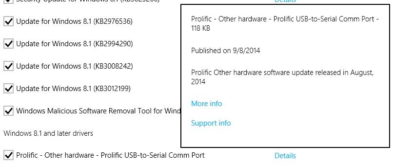

Hey, I noticed a new driver update on my Windows 8.1 PC today while doing updates, waiting for them to install. It's for the Prolific USB-to-Serial cable. I wonder if that means I can use my Windows 8 PC to now edit my Micro HD? Will have to give it a try after it installs. Has anybody else seen this or know if it works?
