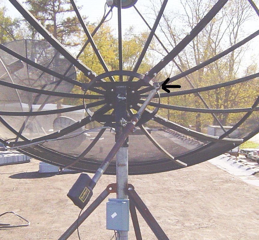

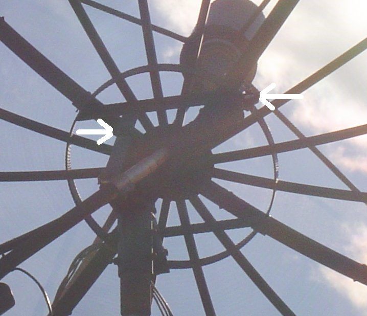

I had a conversation with Anole late yesterday about how to get more counts between satellites without modifying the actuator itself, or the magnets.
Anole suggested a possible solution by moving the point where the end of the actuator arm attaches to the dish thereby making the throw a little longer.
Most dishes that don't have H-H mounts follow two similar mounting rings. The one like my Unimesh 10 footer splits the mounting ring in half, and the other like my Perfect 10 7.5 footer which attaches offset of center.
Here are a couple of pictures to illustrate his proposal. (Sorry about the darkness on the 7.5 footer. It is 24F out with 25 mph winds. I am not going up to the roof for a clearer shot :) )
Anole, Is this what you were describing to do?
Also look closely at the P10 dish offset. See how the mount moves around the center piece?
BTW, I like the Santa hat on your Anole in your avatar! :D
Fred

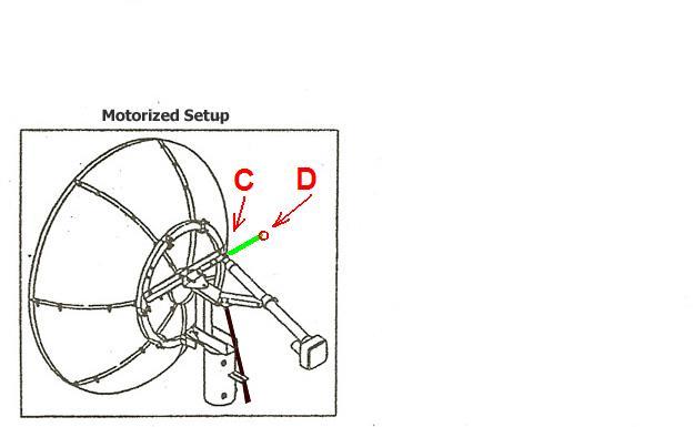

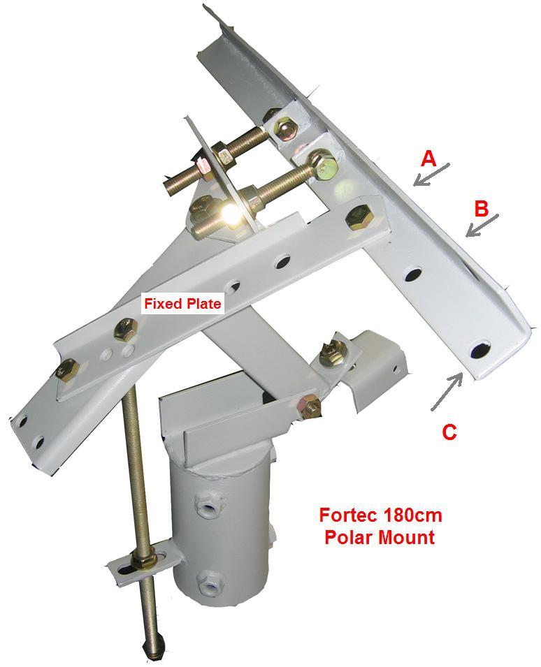

Here is what I was thinking. . .
The pix below were taken from this page on the Sadoun site, but I've modified mine to show the relevant points.
In the first picture, the fixed plate locks the dish relative to the mount.
It would be replaced by the actuator (motor) if the dish were motorized, as shown in the 2nd picture.
See the mounting holes I've marked? ( A , B , & C )
The farther from the pivot point of the dish you put the end of the motor ( C ), the less throw you'll have and the more counts between birds.
See second picture, at the point marked: D .
I can see from your pictures that the end of the motor is attached to the big ring on the back of the dish.
In my drawings there is a flat or extruded bar that sticks out and could possibly be extended.
I hadn't contemplated the ring, and don't know a quick solution to get ya more motor travel.
For users with different mounts, which more resemble mine, it should be simple.
. . . and, see also post #31 above, for the clever 3-magnet idea. - :up

Yes, I understood correctly. I just didn't illustrate the further out point. A small steel bracket could be made to move the attachment point further out pretty easily.
Your pictures are much clearer than mine.
Moving the attachment point further out from the centre will also reduce the effects of any play in the mechanism.
I think you are right Larry!
