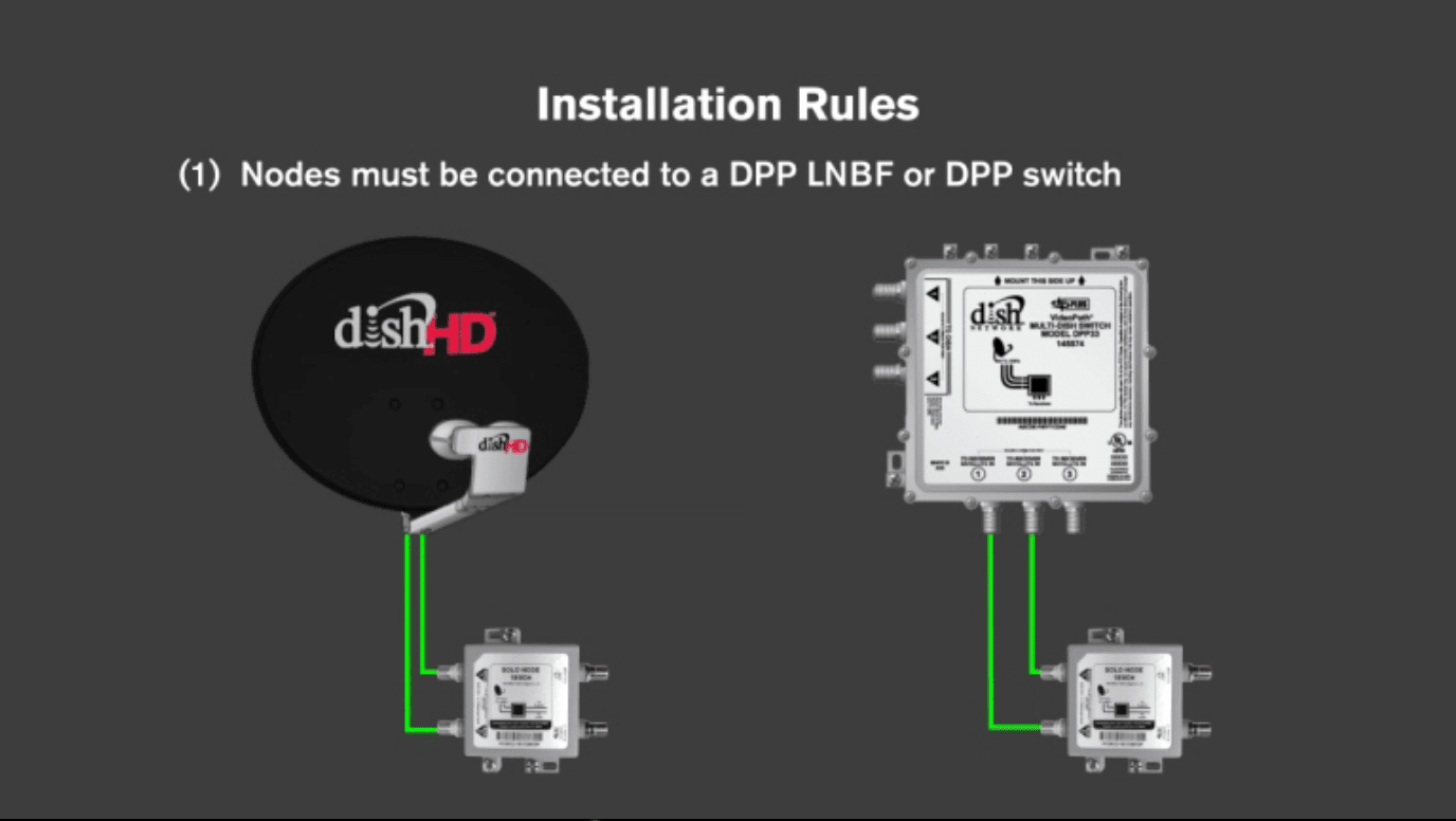

I have so much Hopper stuff here that it all gets mixed together. I am watching a training video now and it shows a DPP33 switch being used... (I am still watching though) :)
