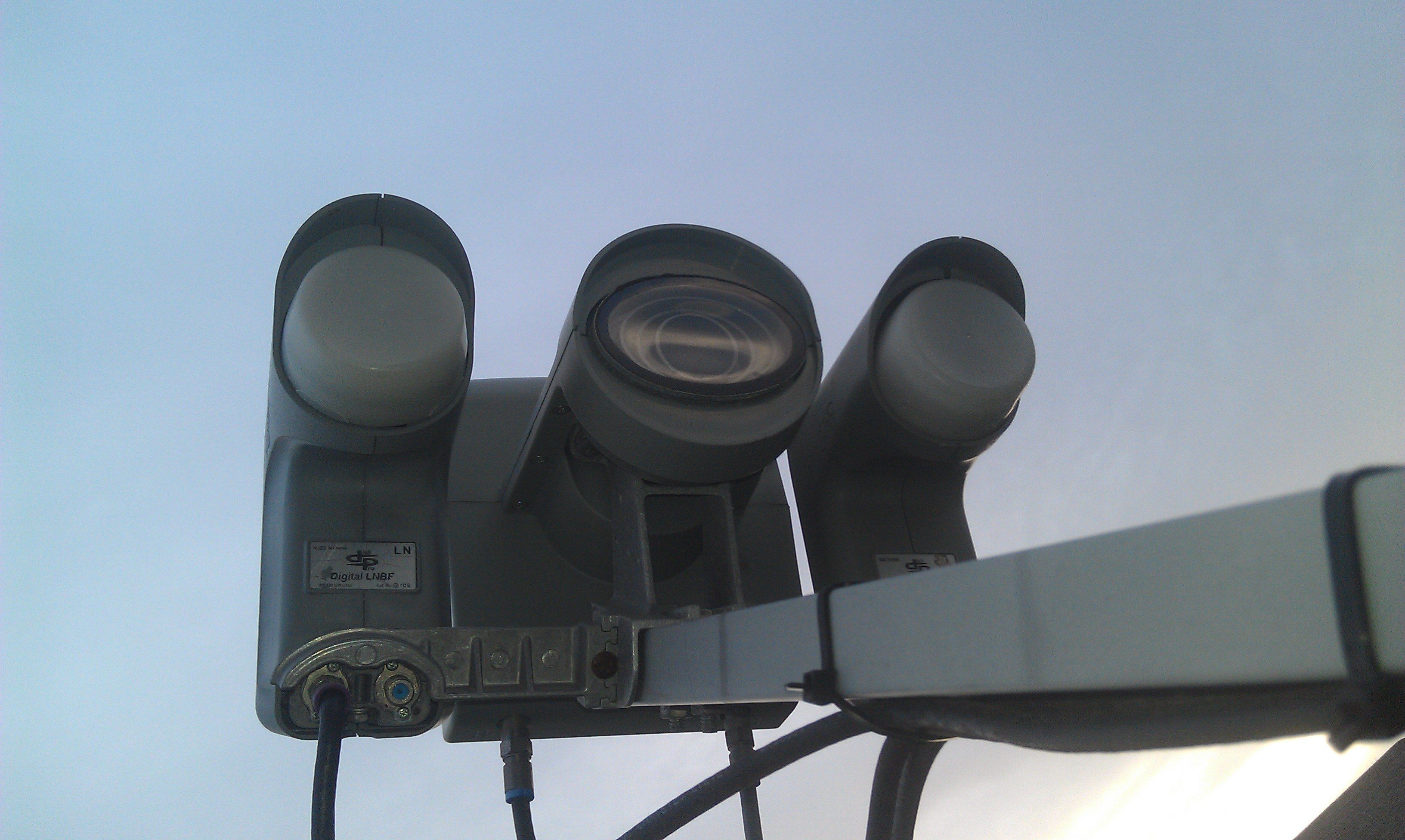

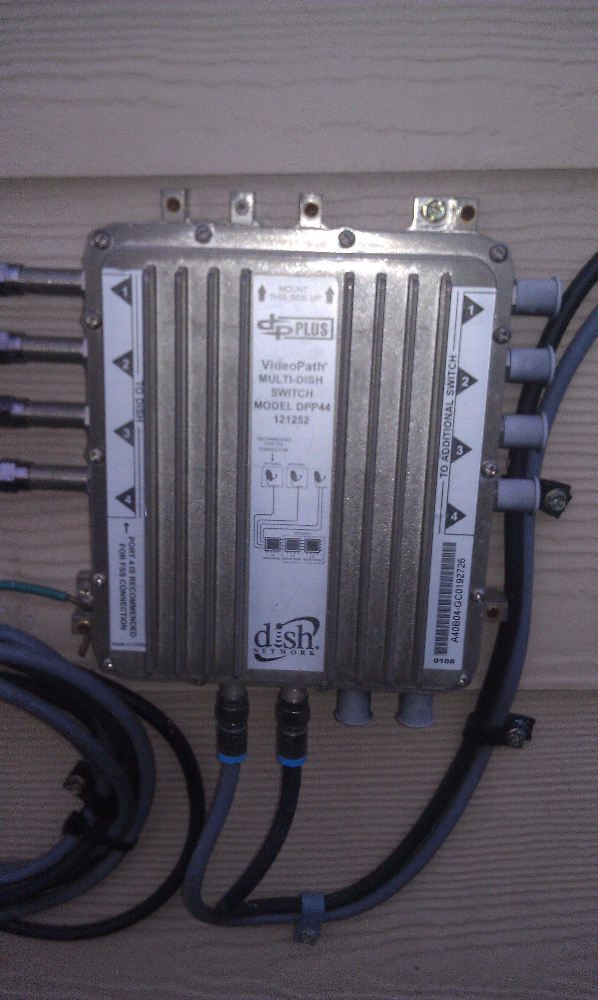

This is what I currently have:
Are there numbers on there I can get for you guys? I know the DPP44 already. Just would like to know ahead of time. You guys (installers?) are throwing out all these alpha-numeric numbers, and I can't follow! And thanks for everyone's help and patience!
Seems like one of the two lines going in the house is power for the DPP44, based on current conversation in the forum. So a DPP33 (which doesn't need power) would use the two existing coax lines to feed my Hoppers... Of course, I don't know what I'm talking about!

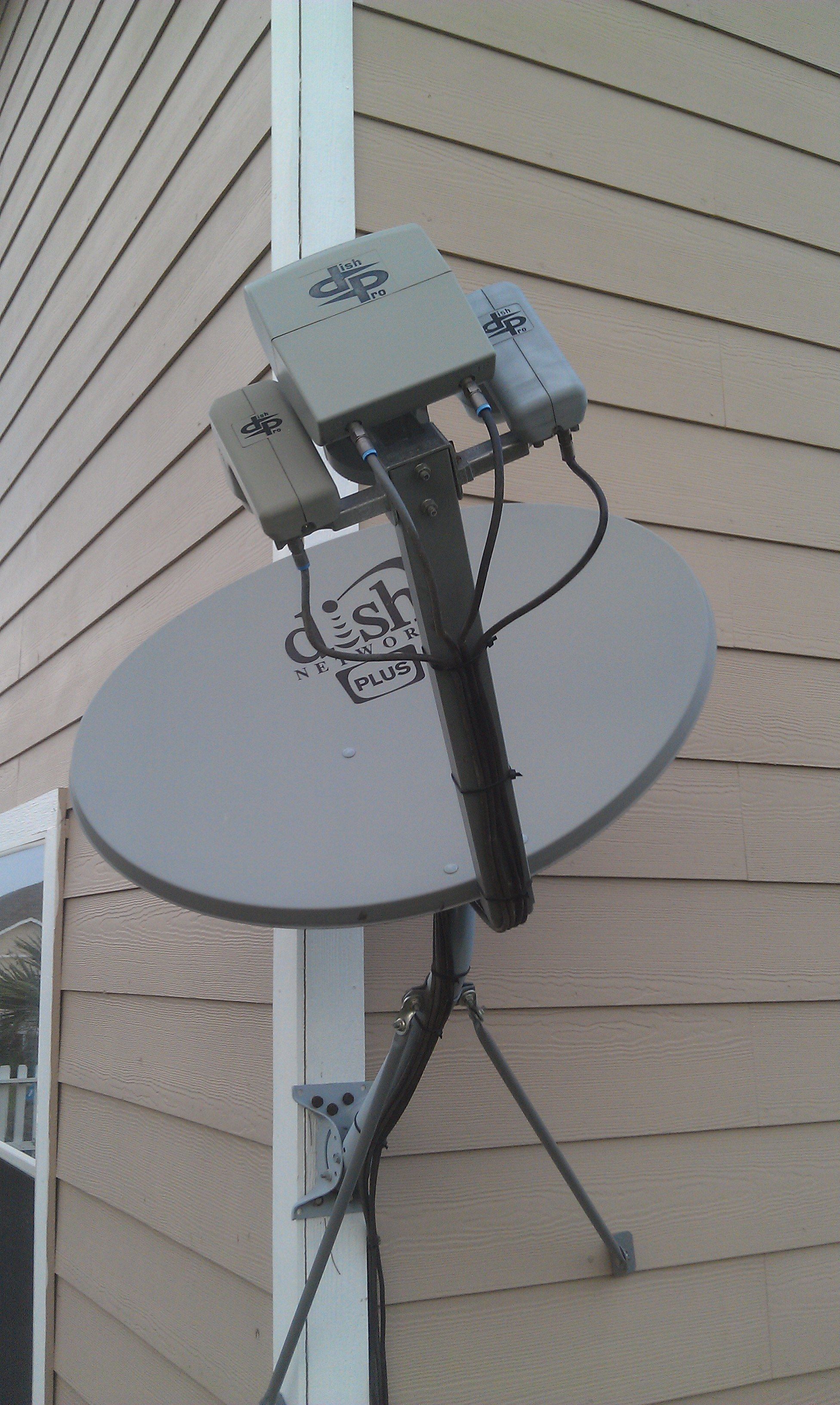

What would you do in my case? I have two Dish 500s. One on 110,119, and the wing 500 on 129.
If it ain't broke, don't fix it.
And, you "might" get a slightly stronger signal this way, depending upon peaking.
View attachment 74858View attachment 74859View attachment 74860
You have a first generation 1000+ dish set-up. Your 44 switch and 2 output cables will support 1 Hopper (1 cable for Hopper and 1 cable for power inserter). You'd need to run a 3rd cable to support a 2nd Hopper. A 33 switch won't work with your 4 orbital location set-up. As stated earlier, I'd replace your existing LNBF assembly with a new 1000+ DPP LNBF assembly and call it a day.
First comment was based on previous posts stating that they thought two dishes could be better peaked for signal quality than a single dish. More trade offs with a single dish, I suppose.
Second comment was an aside to comments posted by Claude.
