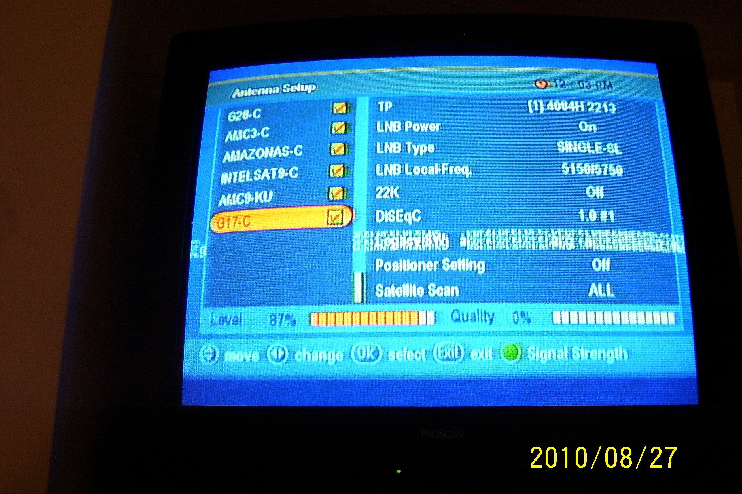

Hi Fat Air,
Just received another opportunity from the 250sm.
See the attached. Not a good picture but maybe you can see enough
to tell me what to do.
I was trying to set up G17 c-band when this occurred.
The shot is of the Antenna Setup screen.
This happened before and I did a factory reset to get out of it.
Fortunately I did a back up of the files just before this happened.
I don't know what would cause this. Puzzling. Did it just do this when you just entered the screen, or while making adjustments? I find with my 9200 to make changes and selections (any button pushed on remote) about 2 seconds apart. Seems to lock up a lot less. If I start to quickly push remote buttons, It's almost guaranteed to lock up.
Hi Fat Air,
This happenes (I think) when programming Sats.
This morning it happened to me again while trying to program
G25. Last night when it happened, I shut the receiver off for
5 minutes and it went away.
It also locks when there is nothing on a sat.
I locks when I hit the up or down arrows to quickly.
The software on the 250sm is the pits and Pansat doesn't
seem to care. I emailed them and they don't bother to answer.
Good public relations:(
Should I try to return the receiver?
But what receiver to replace it with?
