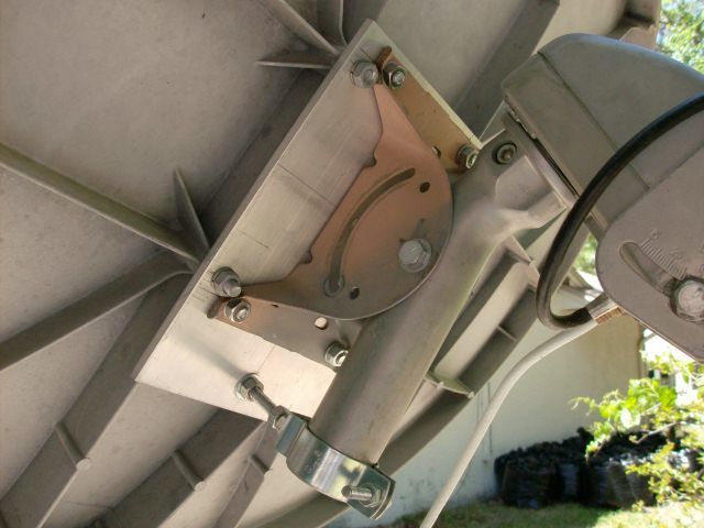

I realize its not the same dish but this worked for me.
I the interest of giving credit where credit due, this is a "Stogie" design that I "borrowed" as I am sure several others did. :)

Thanks for that image mjac. If I do decide to fit another bracket onto my dish I'll consider that layout.

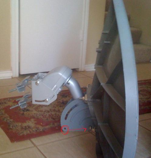

So I tried rotating the tube 180 to allow for more upward angles of the dish. In that respect I succeeded. My only concern is that offset center of gravity will tax the motor too much even though the dish with bracket and lnb will be 10lbs under the limit. Now how do I figure the right angle on the dish bracket? With the motor tube rotated 180, do I need to change the motor latitude/elevation? I think it's safe to say I need an angle finder at this point. Thanks all for your help.
Can you try:
Return Tube to proper position, and on the Bracket, use the other Hole to mount to the Tube.

That won't work Lak. The hole is only on one side and I won't be able to use the degree notches to measure against.
