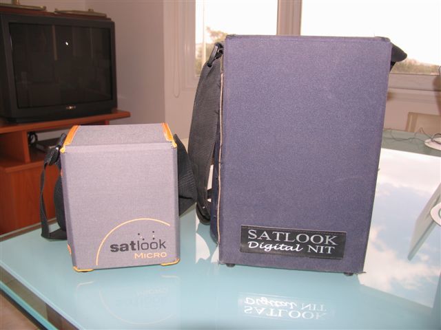

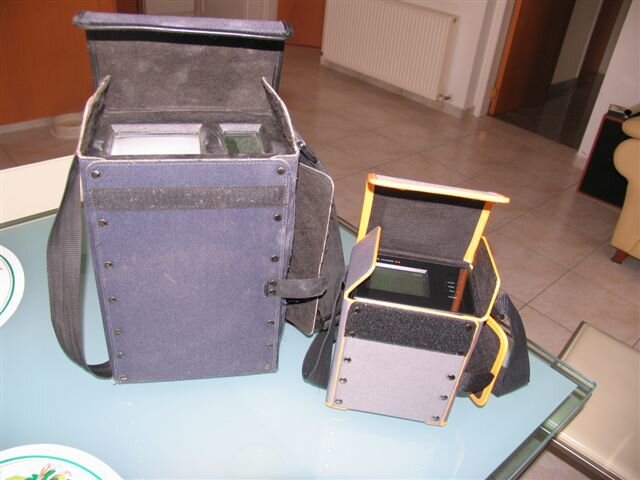

Updatelee, Well I've looked and played with the Promax, Satlook, and Rover SAs and they are all good and function very well, the Satlook has "easyfind" which is incredable but does not have a color screen. The Promax and Rover have color screens give all the same data but are far too expensive. The Satlook Micro g2 at €309 has everthing but 8psk which is not a necessity for me and it is no longer a pack of bricks. There is a higher model to include Dvb-S2 and 8psk. There is US software for it and I have tried up and downloading it no problem. The software editor has room to put 100 sats/transponders in its memory and the less TPs the faster it recognises the sats. I found it best to put 2 TPs per sat which gave me enough for all my favourite European and US sats. It also reads the Sat NIT stream to identify Sats
Upshot is I bought one.
