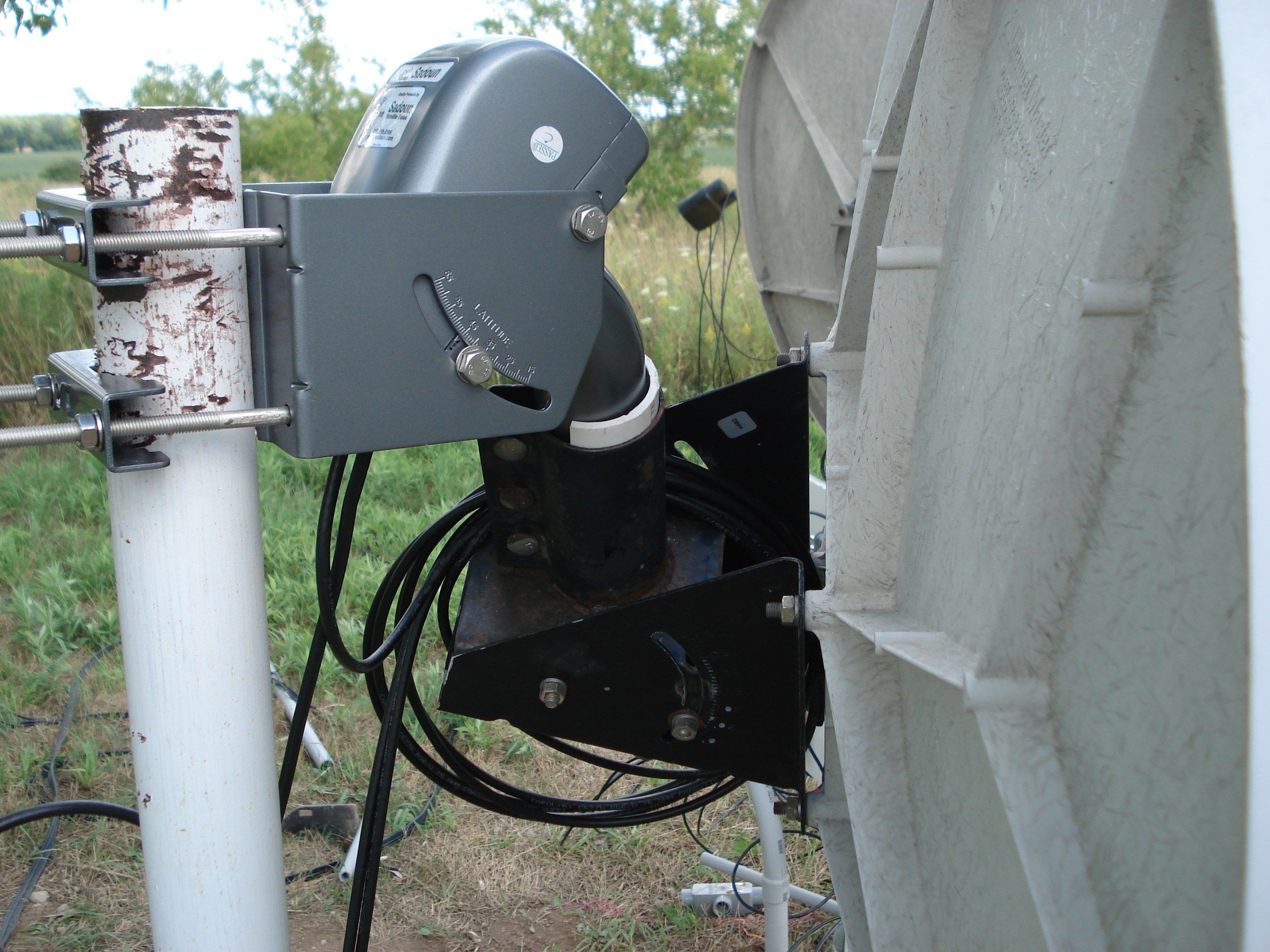

I think I will need to enlist the help of se of you math gurus later on designing a part so my dad can "fab" the thing for me.
My math skills are pretty poor to be totally honest.
What we have in mind is a metal thingie to go on the back of the dish and slide into the motor pipe thing. Whatever it's called.
I'll try to make a little sketch and put some photos up to so to be more precise on all this pot luck guess work.

motor mount
Dee Ann, I did this when I motorized my channel master 1.0. Looks like same dish to me. Just mount the metal pole mount upside down and use some type of shim around the motors arm to take up the space in the dish mount. see attached picture. I found it quite easy.
