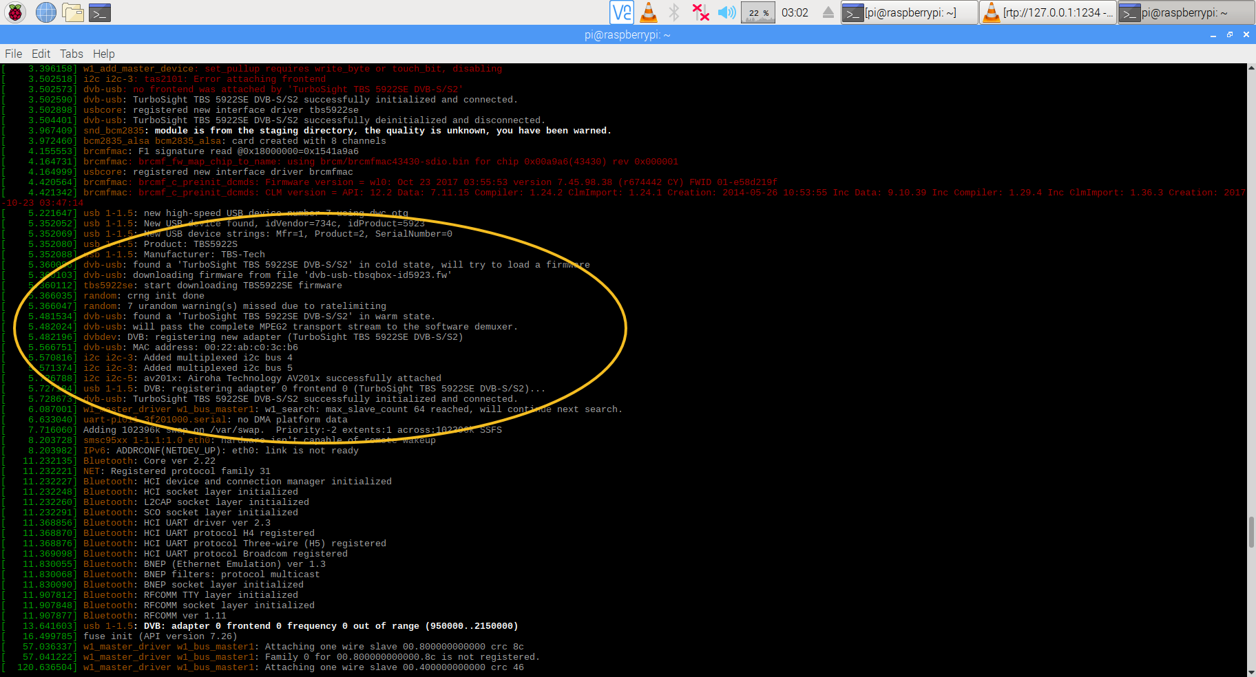

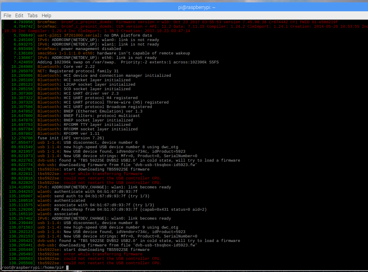

I have successfully compiled the drivers for TBS5922SE and after adding the firmware file for TBS5922SE which is dvb-usb-tbsqbox-id5923.fw (as suggested by TBS guys) in /lib/firmware. I have attached the output i am getting after typing # dmesg in the terminal.
please provide any suggestions to interface TBS5922SE with raspberry pi correctly.
It appears that the SE and non-SE cards are not all that compatible when it comes to Linux drivers. I see mention of "blob" driver for Linux in reference to the SE card not supporting all of the features.
Just because code compiles doesn't mean that it will run.
Your dmesg suggests a problem with initializing the serial connection.

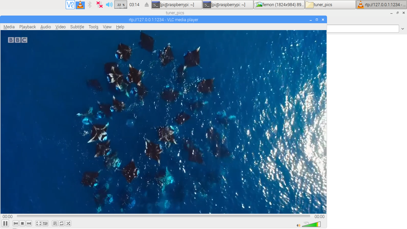

Hii,

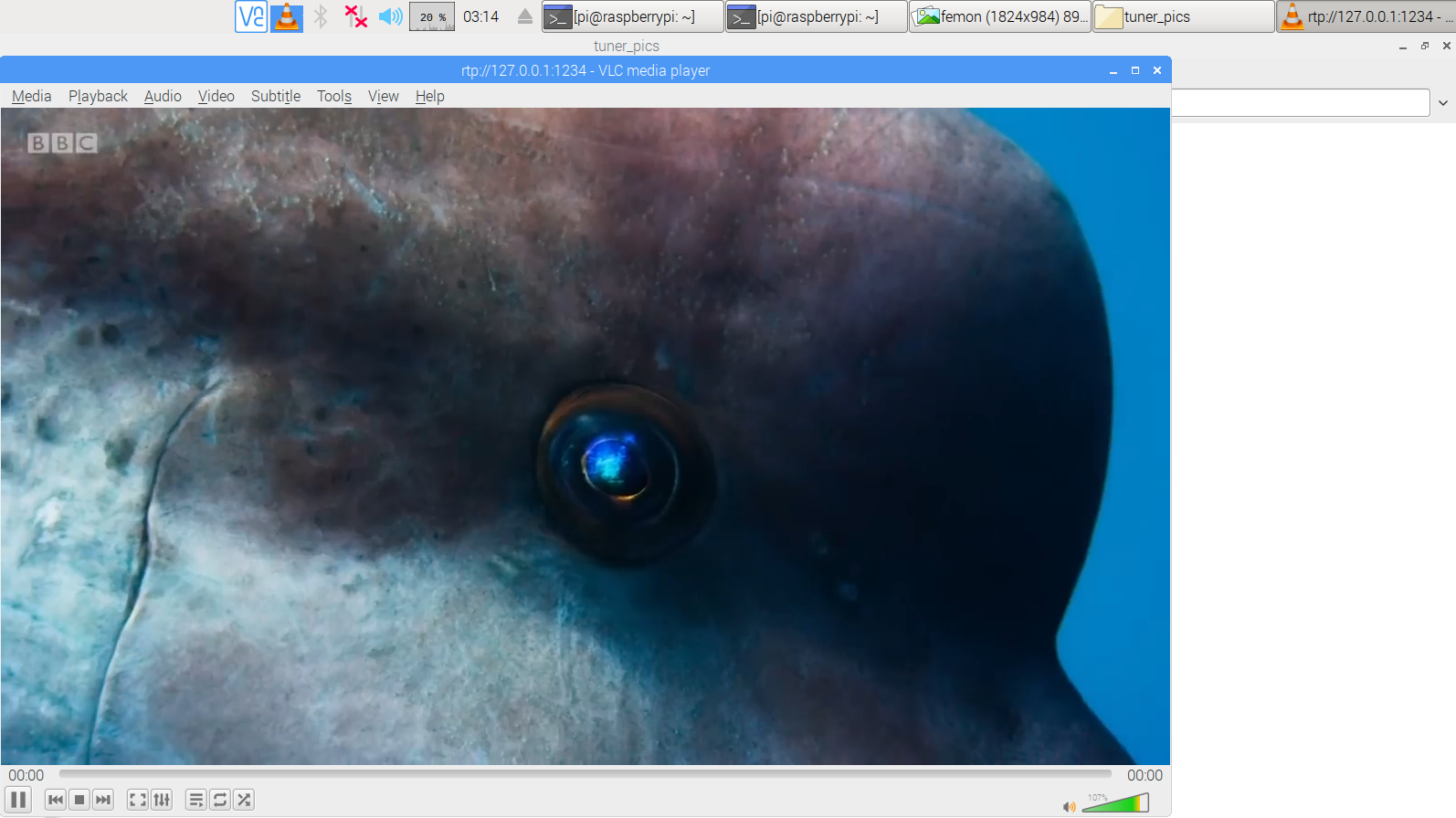

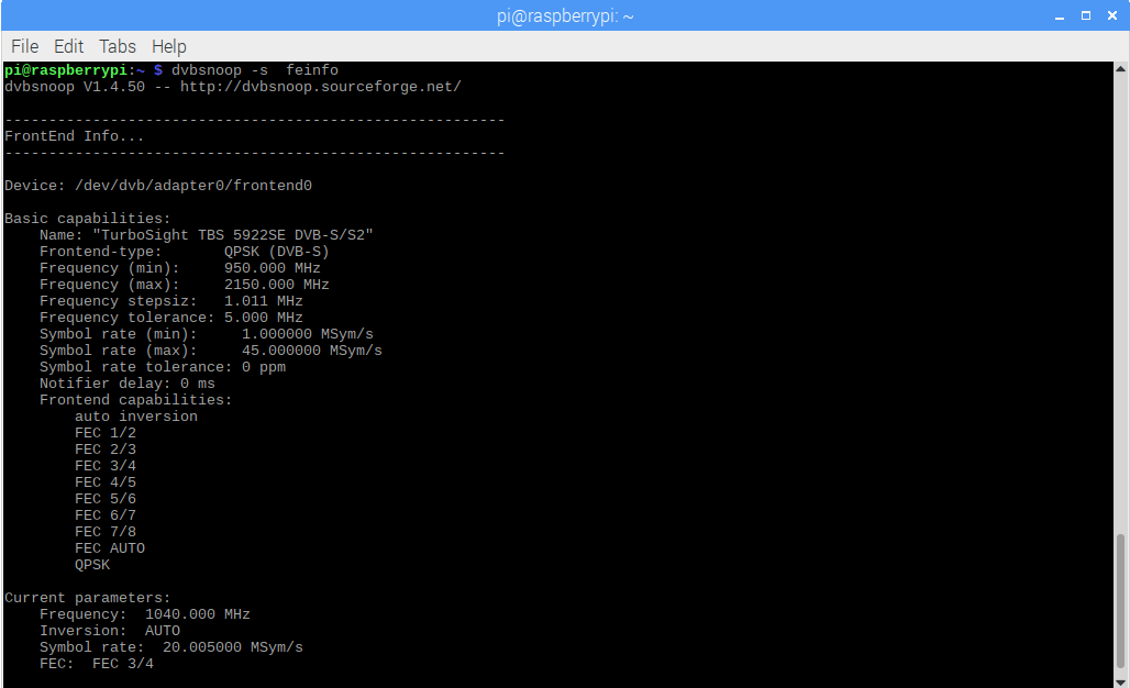

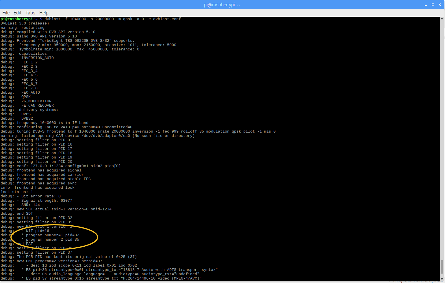

I am not rationalizing anything. TBS5922SE is working correctly on Rpi. I have attached some snapshots for your reference. In the snaps you can see that the firmware is loaded correctly, my tuner is getting locked via dvblast (you can also see the Program numbers and PIDs that i have encircled in yellow), i am able to get the frontend info using femon -H, also i have attached some snaps of the video that i am receiving via vlc for your reference.
If you are satisfied that my tuner is working properly on my Pi then kindly help me how i can receive data (other than video/audio) or how to create virtual network interface on my pi for my tuner.
