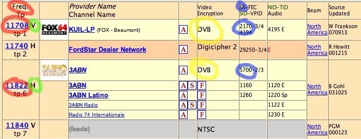

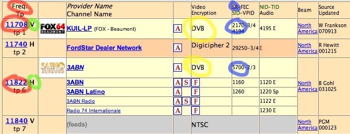

I have attached a Pic from Lyngsat. Someone sent something like this to me, and it helped. There is alot of info there, need to understand the basics first.
Red is Frequency - Ku is 5 digits, C is 4 digits
Green is Polarity - Horz or Vert for Linear(FTA) Sats
Blue is Scan Rate - Can be almost anything from 1000 - 40000
Yellow is Video Encryption / Format - You can only get "DVB"

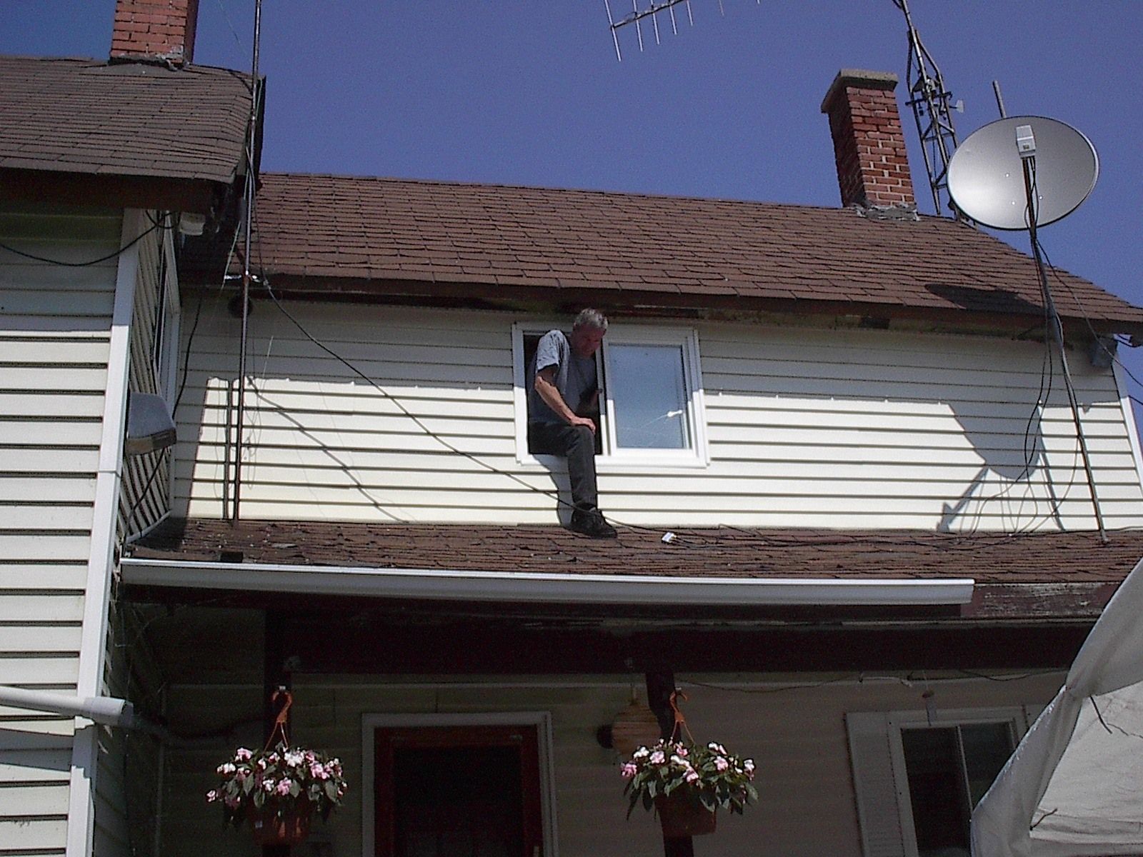

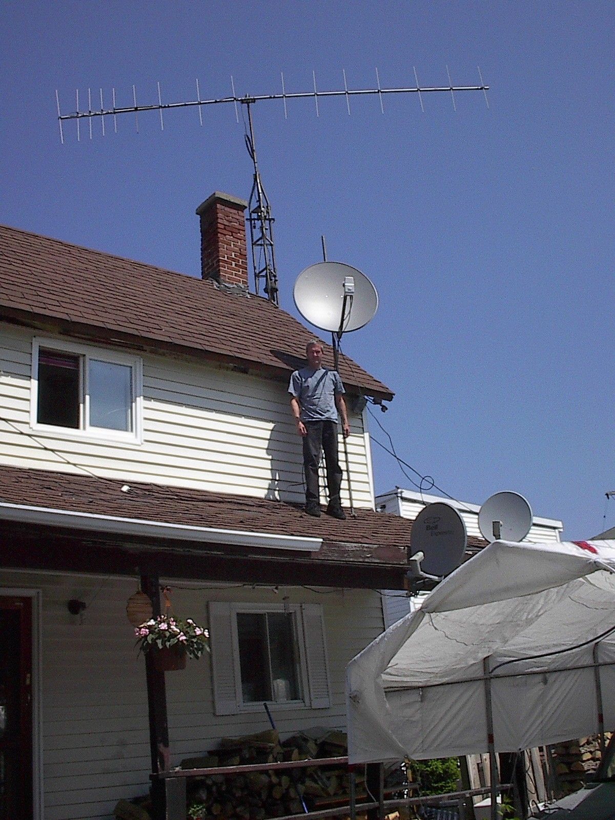

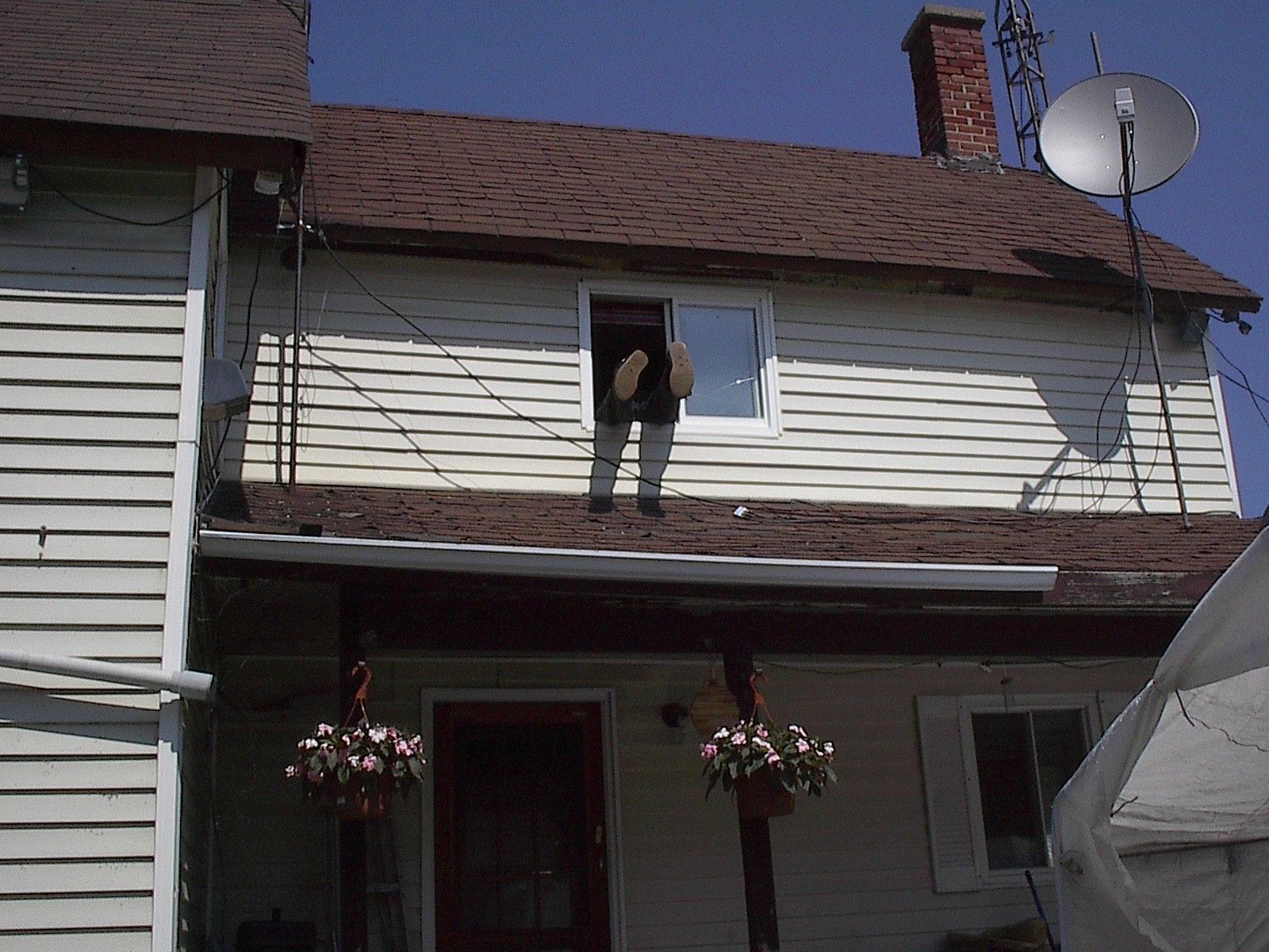

BINGO ! LaK7, thanks for the help. No matter how hard one tries if it's not right,, well it's simply just not right, Right? LOL. That did it. I see how this part of it works now but will do a lot more reading to fully understand. I do have a few questions now that I'm at this stage but I would like to try to figure these out by myself. If I can't, then at least I know where to go for answers! At least now I have the Birds in sight for me to test. This was the part that was the hardest physically, as I had to crawl in and out of a window. Thank you all for the help so far and with guidance, letting me do this by myself and not have to rely on outside help if my setup needs mechanical attention in the future. I think it's time for me to let this thread go. I can't Thank You all enough and Iceberg for having this site to help others!! You are a great bunch of truly "friendly testers". Tracker.

Why not. I'm a good sport. "HEY BUDDY !!, Ya you up there. Did you ever hear of a ladder !!" LOL.
