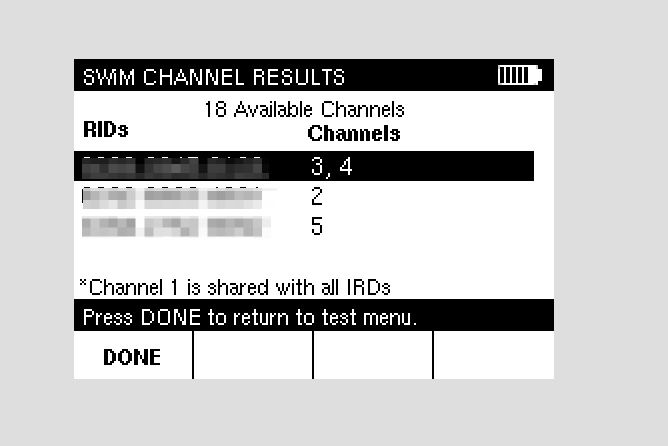

Meter shows 22 actually SWM channels plus guide channel for a total of 23 channels for the 3 Reverse Band LNB

Interesting;
I'll take this as confirmation then for the 3DR, though odd the 3D2, also a 2nd gen. DSWM, was limited to one short at 21(+1) SWiM channels.
Can the AIM analyze the 3D2 yet?
It can analyze the Reverse Band capable 3DR, but not the non-Reverse Band capable 3D2?
I also wonder if even though the AIM firmware can detect the 3DR's full number of 22(+1) channels does not mean the current receiver NR firmwares will be able to causing the 3DR to be limited to only 13(+1) initally as Scott claims pending a future firmware releases to reach the complete 22(+1).
But this would also be strange given that the current receiver NRs can see the full 21(+1) SWM channels of the 3D2, but not the 3DR.

Yes there is alpha fw for aim out now

That info is wrong. This is directly from DIRECTV. Also the AIM meter Beta software is not due to be released until tomorrow to support this LNB properly. (Or so I am told.)
•Similar to the 3D2 DSWiM LNB, the 3D2RB and 5D2RB Reverse Band LNBs are designed to support 22 (+1 Network Tuner) tuner channels.
•Current support is same as DSWM Gen 1 & 2 LNB's of 13 tuners but support of 22 tuners is pending future FW release for Genie servers

DUDE, you are telling I am wrong when I posted evidence and you got none!!!!!!! Only hearsay......... Meter was fully updated to DirecTV latest and greatest version
(EDIT) Actually you could be correct. (I don't have an AIM meter) Reading what DIRECTV sent again it appears the FW on the GENIE needs updating to support the 22 tuners.. not the LNB itself.

*•Current support is same as DSWM Gen 1 & 2 LNB's of 13 tuners* but support of 22 tuners is pending future FW release for Genie servers
The question with this statement here is does this mean the Genies are presently seeing only 13 tuner support on the now officially released 3D2 while other receivers can see it's full 21(+1)?
