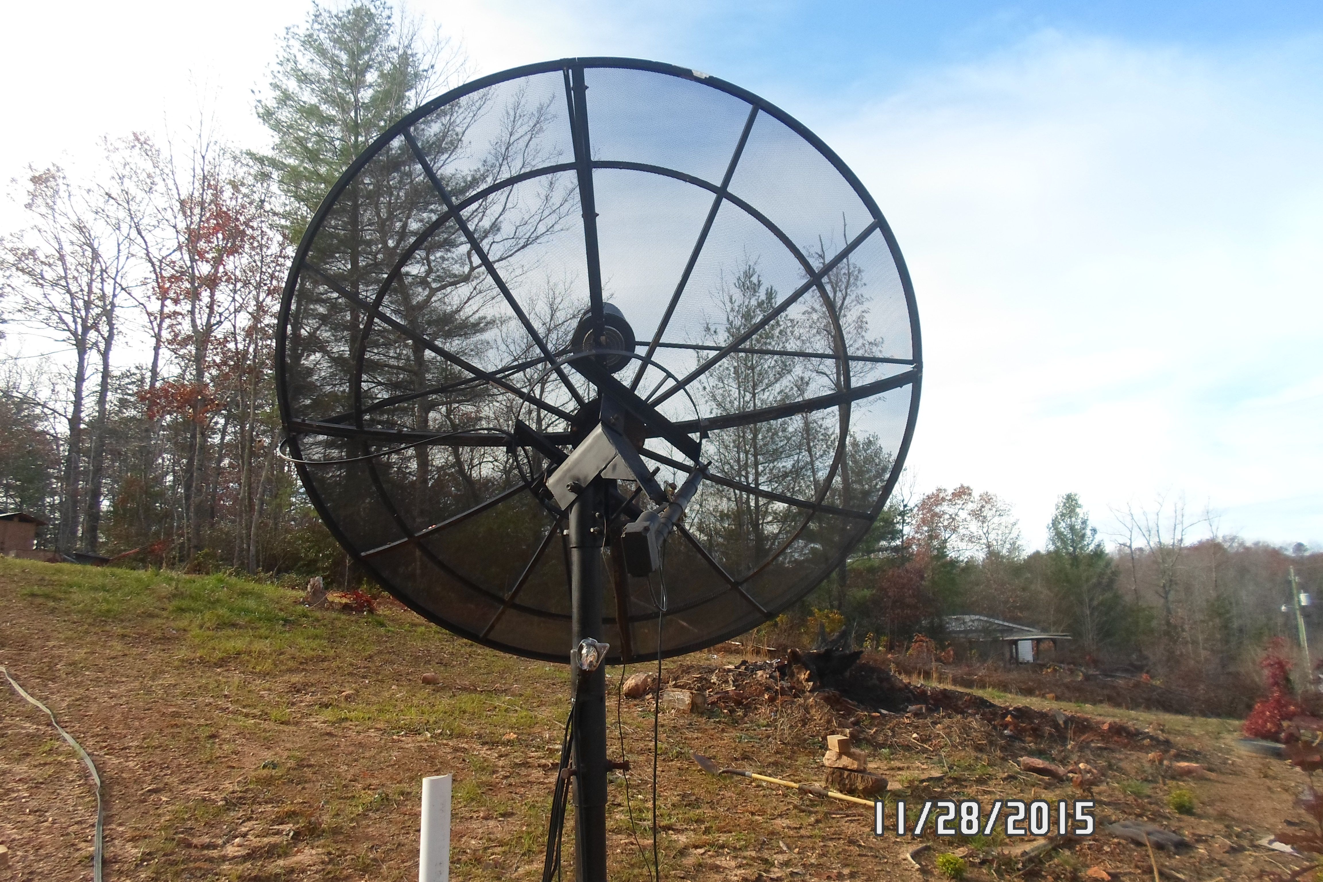

A tree? If it is in the line of sight between the dish and the satellite, yes.... that definitely could be a problem. Limbs do not only move in the wind. They will lift and droop with heat and moisture throughout the day. The branches will also increase attenuation when covered with rain, mist or even absorb moisture. Post a photo from behind the dish lined up with the feedhorn so we can look at the line of sight to the 116w satellite?

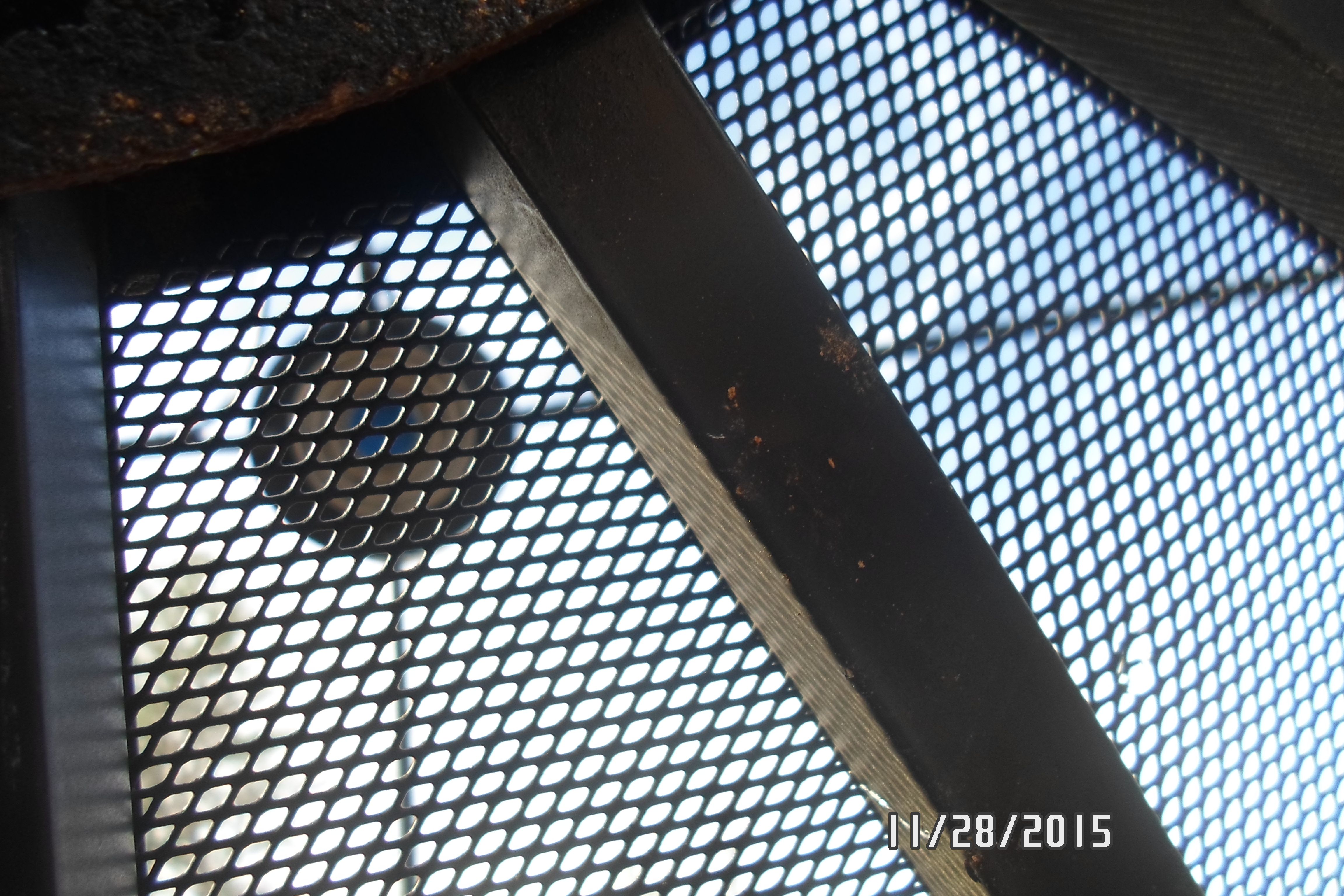

Here's the pics.Warning...pics are large! What do y'all think? The top of the only tree even close to interfering looks well below when viewed by eye...The camera angles are a bit misleading.Trees is 85+ feet away.Also,if that tree is blocking signal,it should have been much worse before the leaves fell.
Temps were warmer last night and the night before...problem transponders remained on much later,possibly even all night.I will know more once the daytime temps drop below the 40's. :eek:
