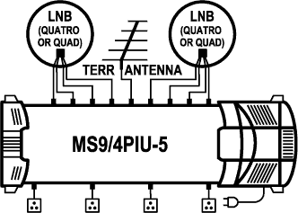

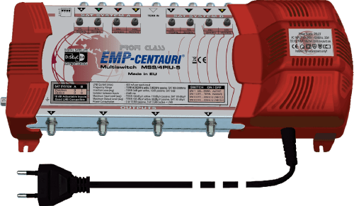

I'm not that experienced with multi-switches, but I think that you would need to get 2 quattro lnb's and something like a 9x4 multiswitch.

The thing that you need to address first is usage scenarios.
- Idependant Tuning by all receivers
The 9x4 switch and Quattro labs is the most versatile solution. This would allow all receivers to access the low and high frequencies without limitation.
- Shared tuning of LNB switching
If you do not need to access low and high frequencies at the same time on all receivers, you could get away with using 2 of the 2x4 or 3x4 switches and 4 2x1 or 4x1 diseqc switches. The LNB for N.A. satellites will always have tone on and all receivers can access H and V transponders. For the other satellites that need the universal capabilities will be set to low or high by the first receiver that tunes a H or V transponder.
Another option would be to use a 2x3 or 3x4 for the N.A. satellites and a Quattro LNB for the other satellites. Then use 4 2x1 or 4x1 diseqc switches.
Once you know this, you can determine which switches will be needed and the cost associated for the project.
