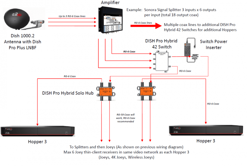

Well, if he doesn't, I have two Solo Hubs I purchased from dishdepot.com. Why are you not sure a Duo Hub might not work? Has DISH sent you any wiring diagrams yet?

This is the only one I've seen:

Two on a single dish will require a DPH42 switch. It can be done though. See the wiring diagram in the post above yours.

I don't know for sure but I'm thinking that the dual hub might not work with 2 H3's. I'll guess you'll let us know on Thursday. :)
Two single hubs will isolate the two Hoppers. The dual hub should bridge the MOCA signals between them. But you can always do that by connecting the client ports of two single hubs together directly or via splitters if you need the client ports.
Which is exactly what I did to connect our 2 solo hubs coming from the DPH42 to the Hopper 3's.
The question is whether a duo hub will even work with the switch and 2 H3's as it is specified by DISH to work with the Hybrid LNB and 2 H1's, H2's and/or SuperJoeys. I haven't bothered to try one out. :)

To my surprise the installer arrived with the two H3's and a DPH42 switch. Install went smoothly and everything seems to be working as expected.

Yes, I had them installed today. The install must include the new DPH42 switch, otherwise two dishes will be required.

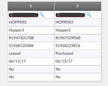

Yes, two Hopper 3's up and running, one account, fees increased by about $6.00 over my two HWS's. Call the number Charles has posted in this thread. I called Saturday morning and they were willing to come out and do the install Saturday afternoon.
GPM, how many accounts do you have now ? Can you show your online account details, at least the part that shows (2) Hopper 3 DVRs on your account ?
One account. Is this what you're asking for?
Thanks very much. I was sure you did, I just wanted to clarify. Dish's left hand doesn't seem to know what the right hand is doing. Which should not be a surprise. Thanks again.

Shows it exactly like you described ;) Yet you "can't" have (2) H3 units on a single account, the 2nd H3 won't be activated, etc, etc.... ;)
Interesting thing, after the installer left I was checking things out and found that the 2nd H3 only showed a few channels in the All Subscribed list. Called Dish and found out it had not been activated. Took a few minutes, unplug, reset and all was fine. Maybe it was because it was his first two H3 install but there was the 'oh no' moment.
