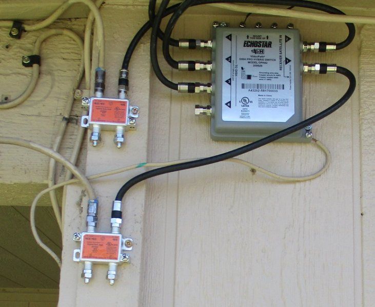

To my surprise the installer arrived with the two H3's and a DPH42 switch. Install went smoothly and everything seems to be working as expected.

I'm guessing your switch and the hubs in the picture are outside and if so then I don't mean to be a buzzkill but those hubs should be mounted sideways and all the wires should have drip loops so no water gets into the hubs or the switch.

JSheridan, wonder why the technician did not install a Hybrid Duo Hub instead of two Solo Hubs! He doesn't have any Joeys. I guess with the two Solo Hubs he will be able to have bunches of Joeys someday.

Thanks for the heads up. Luckily I count screwdriver manipulation in my limited box of skills. I'll address the problem shortly.

I don't know for sure but I'm thinking that the dual hub might not work with 2 H3's. I'll guess you'll let us know on Thursday. :)
