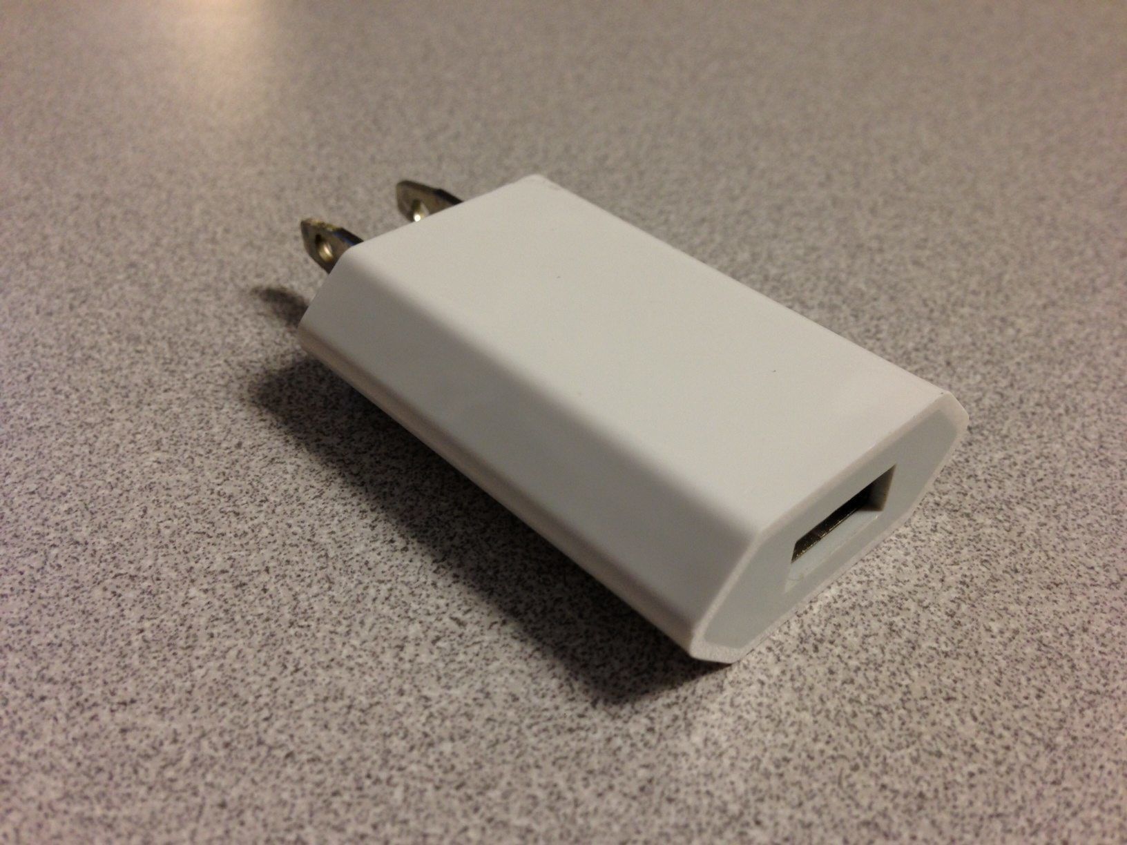

USB power adapters $3
USB A to A/B cables $3

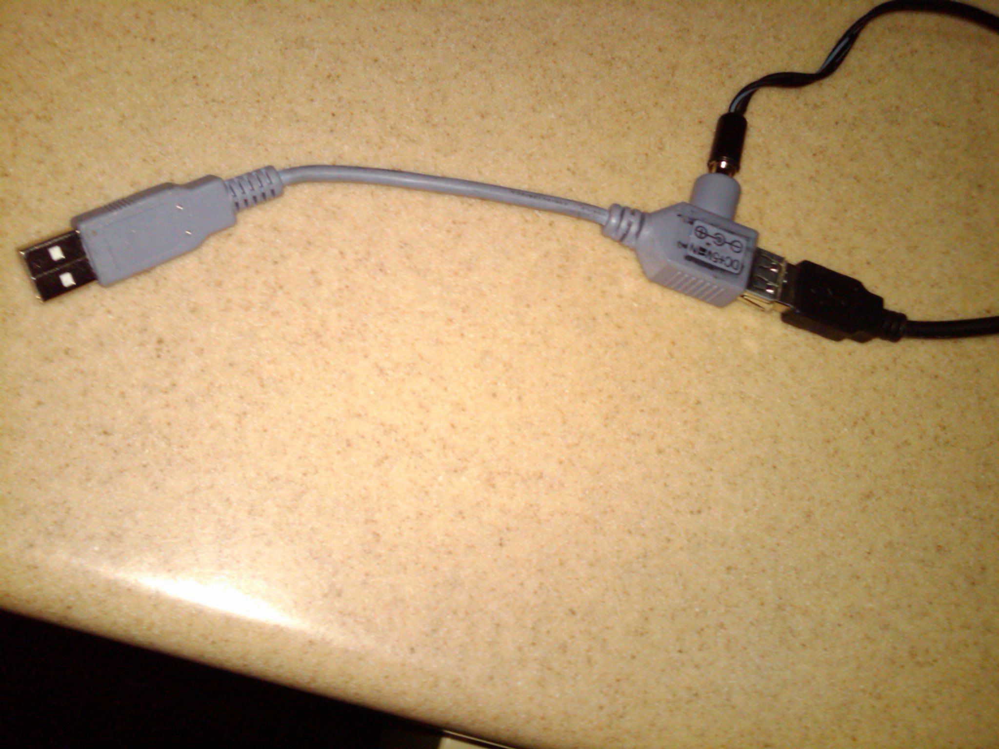

I had tried another drive that has a second cable that is powered through a USB port which I powered with an external USB Hub. l
But now I have obtained a external powered cable (see pic) and tried several different drives. None of them will connect, but the 16GB card will!
