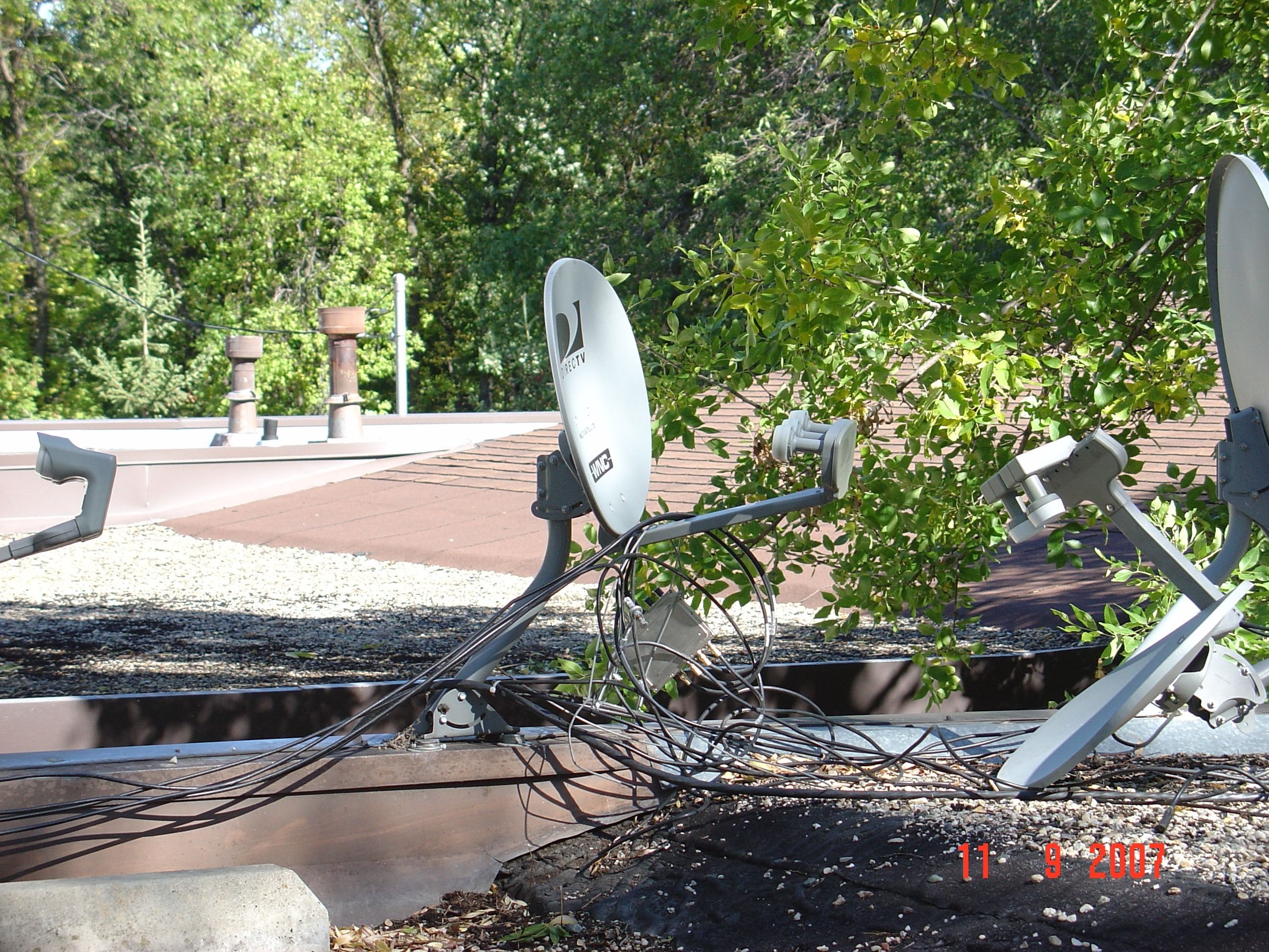

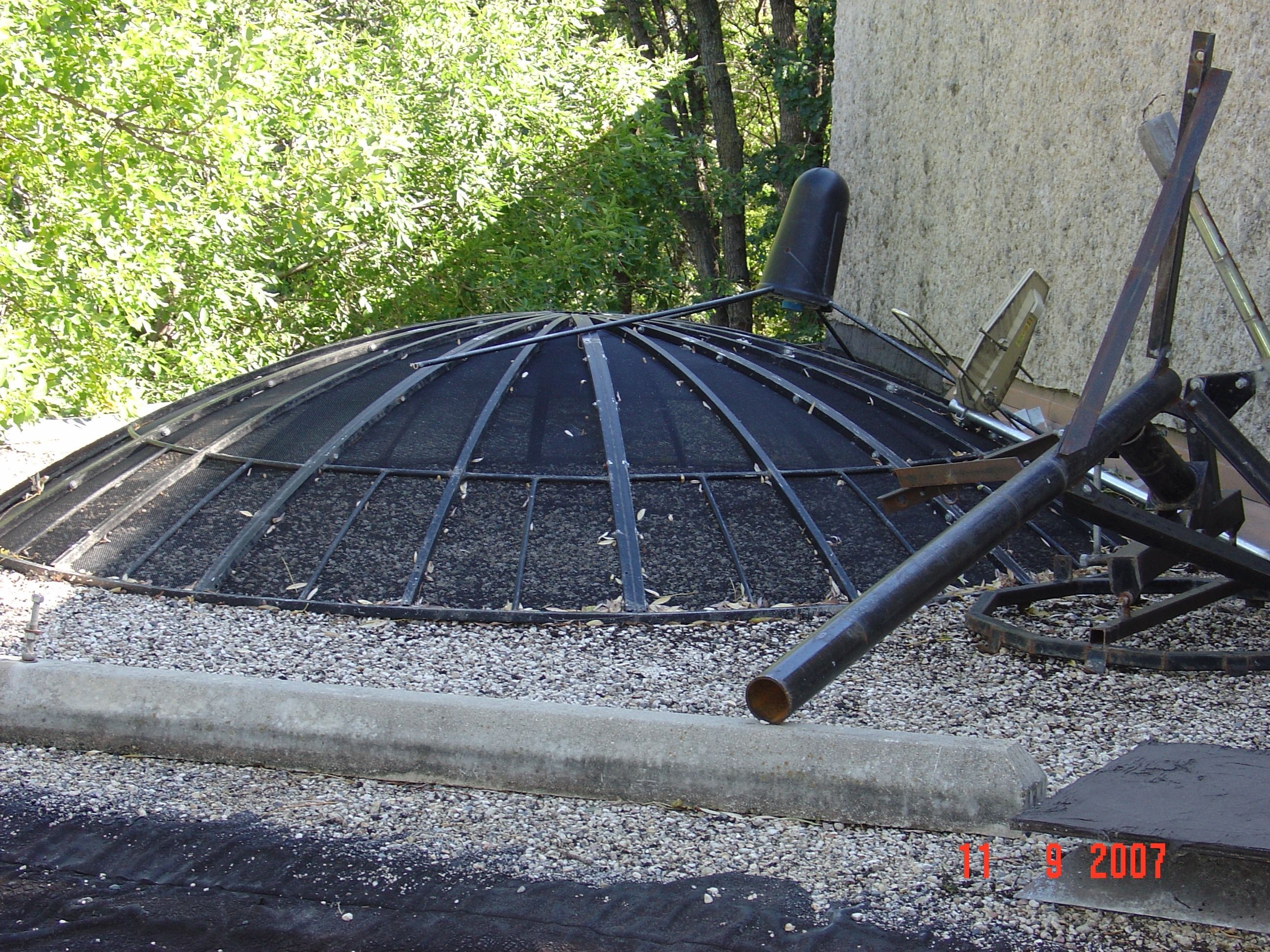

Finally got to the place where the guy had a disassembled 12 foot Mesh Dish for sale for $200.00. He said the Receiver is a Uniden 900, and he hasn't used the system for 5 years! He said the motor might need greasing??
The guy wasn't home but left me his ladder as the Dish was up on the Flat portion of his roof. So I carefully went up the ladder with my brand new knee brace on my leg and took some pictures. See pics 1 and 2. There was about a 2 foot step needed to get closer to the Dish but I didn't want to push things too far since I was already taking a chance just being up the 12 foot ladder. Looks like the Dish does NOT come apart, and it would be quite a chore to move it off the flat roof. Not so sure if it is worth all the work (ie would need 2 - 3 good friends and a truck) that would be required to bring it halfway across the city to my place??

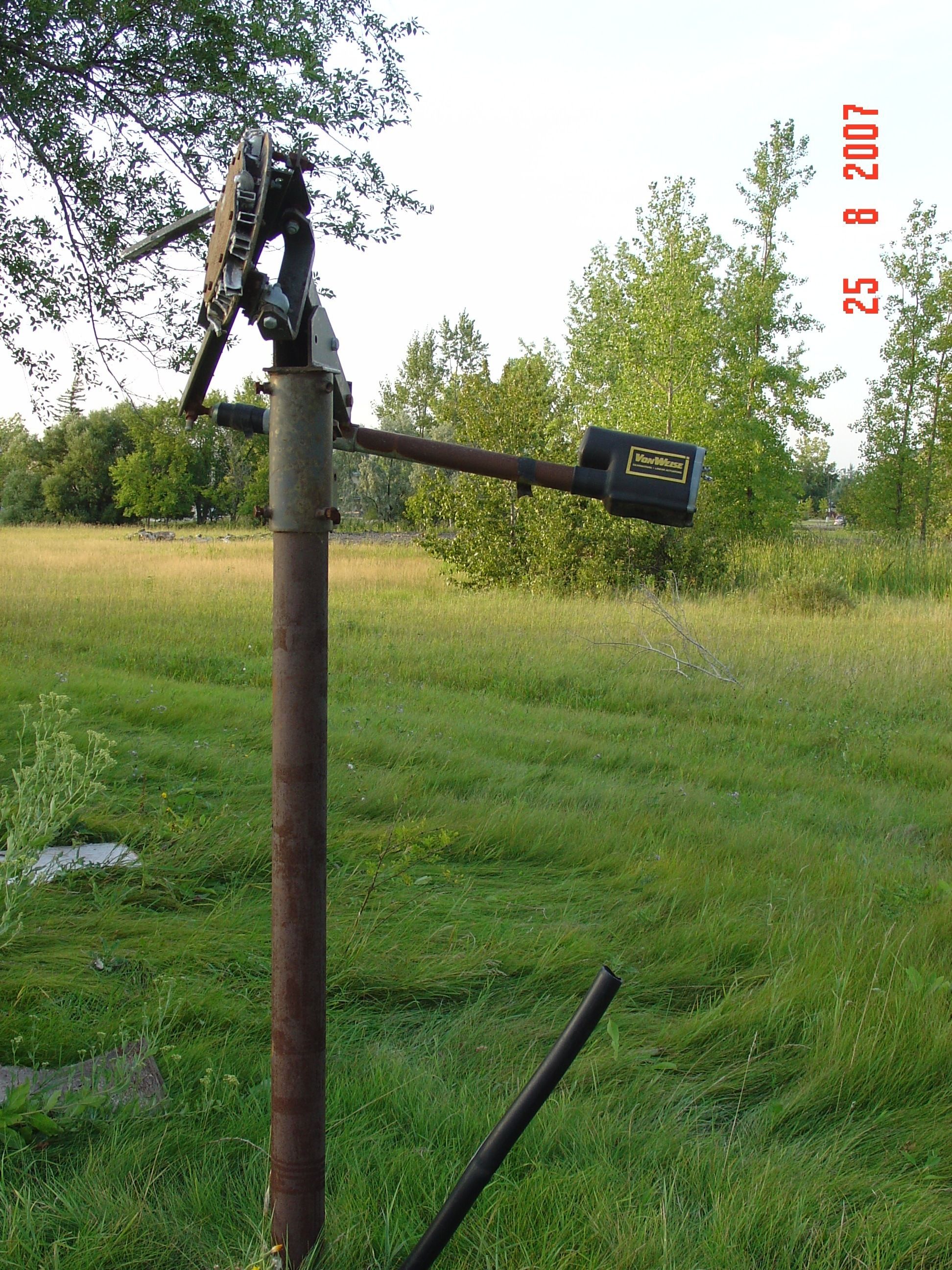

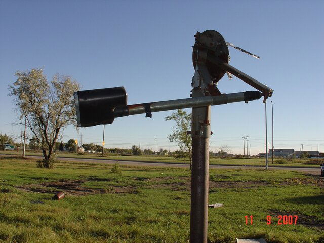

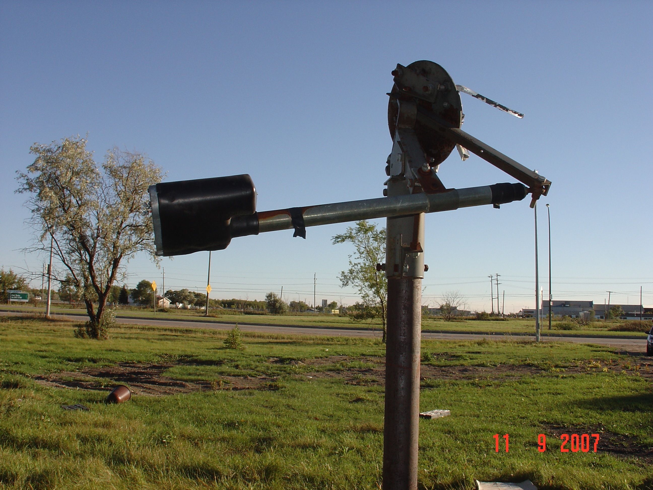

Von Weiss Actuator on Pole - Is this worth going after?
At another location close to home there was a 12 foot dish on a steel pole that I had inquired about. Well someone beat me to the Dish and left just the Motor and Pole. They literally ripped the dish off the pole leaving the Von Weiss Actuator. The pole is solidly in the ground in concrete see pic. The pole and Actuator - if thats what is the proper terminalogy, are in the next 2 pictures. I wonder if the $200.00 Dish could be mounted to this pole and Actuator? Trouble is I think I would need a stick of Dynamite to get that Pole out of the Concrete.
Any comments, suggestions, would be very much appreciated.

I can't tell from the pics whether or not the dish on the flat roof includes a non-pen roof mount. If it does, it *might* be worth the $200. I'd offer him $150 and see if he goes for it. Trouble is, BUDs are rather easy to find, and its equally easy to find people desperately trying to get rid of them (after all, nobody uses those big old dishes anymore ;) ) You could probably find one for free by looking around a bit, but maybe not with a non-pen roof mount.
As for the pole and actuator, the actuators are as common as the dishes, but if that one is particularly clean (no rust), it might be a good idea to ask for it. Von Weise is a good manufacturer.
I wouldn't bother with the pole unless part of the deal is that you must take that with you as well. You'll likely need a Bobcat to get it out of the ground :D
Thanks to your great high resolution pictures, a lot can be seen.
The first dish appears to have a decent motor.
I can see the 5" wires still sticking out of the back of it.
Tron looks to be right about the non-penetrating roof mount.
There's a short mast with bracing, in the pix.
It's not too badly disassembled - the octagonal ring that goes on the back of the dish is still hooked to the mount - just put the mount back on a pole and fit the dish to that ring, and bolt-away!
The LNB under that cover seems to still have its blue cap on it. :)
I'm sure one of our C-band experts will have some opinion of the dish brand.
Seems to be in pretty good shape, as best I can see.
That grey/silver thing to the right looks to be an amplified TV or FM antenna.
As to the scrap-mongers who took ripped the dish from the second mount, I'd like to string them up by their . . . :eek:
What a bunch of barbarians. Probably an aluminum dish. Couldn't have been worth that much in scrap metal. :(
The mount looks pretty substantial, and is slipped over the pole.
I'd go for the mount and motor, if it were free.
Always nice to have spare goodies, trading material, or a freebie for a friend.

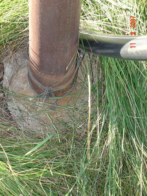

If the pole were desirable, follow the suggestions in the C-band section:
- water the ground for a few days , maybe pierce the ground to get the water down there.
- gently roll a truck bumper against the pole to rock it a bit.
- lift out the pole and concrete with an engine hoist, or similar.
- take the whole thing home, dig a big enough hole, drop it in and pour just enough cement around it to fit your new hole.

I'm no expert, but it sorta looks like that first dish does come apart into 8 or 12 panels.
Note the wide rib sections with all the bolts through 'em.

As Anole said above, the panels should come apart where you see the bolts are. Looks like a nice big mounting ring and has a nice intermediate ring for stability.

That dish does come apart, maybe just 4 sections like my 7.5winegard. I'd grab it if I needed it, and had a place for it. They are well made dishes, perforated, not mesh, and good for ku also. Wouldnt be too heavy to set up either. Take out the bolts from the sections and go with it. Don't see many winegards around these days, not here anyway.

On my 10' dish the 3.5" pole is 4' in the concrete. Locally such pipe is difficult to locate. The closest thing is a concrete filled column at Home Depot for $39 and is only 10' long.

One thing to make sure of, is to be sure the dish isn't warped or twisted.too. Just because it is faced down and look flat, doesn't mean it would be flat while on the pole. The old two string method would help determine that.

And, check the mesh screen for the hole sizes. If it is 1/4 around, too big for Ku. If in doubt, find a mesh dish in your neighborhood and compare theirs with this 12 footer. The older mesh dishs has bigger hole sizes than the newer ones.

dishes in the first picture
All the way to the left is a two-LNB Dish 500 .
I can't tell if it has two individual LNBs or a big double-wide.
But, it's circular and made for 110/119º.
The three-horn dish in the middle is DirecTV Phase III dish, and it's described in other threads around here.
Again, it's circular and while not totally useless, it's pretty odd for any FTA usage.
All the switching is done inside the head, so that separate switch below the LNBs is probably from the next dish over
The third dish is an upside down DirecTV Phase II dish with two LNBs
It's not configured the way it's normally shipped, if memory serves.
The LNBs should be all the way to the far sides of the bracket, at 101º and 119º.
The fourth dish , all the way to the far right in the picture, and standing, has only one LNB.
It's from Dish Network, and would typically have been used to get 61º or 148º wing birds in some markets.
