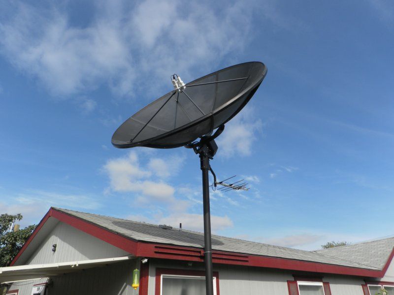

How do you manage to keep the pole that high at 90 degrees? I would think that the antenna weight will slope it a bit? I know it doesn't have to do with the lnb issue but just wondering if it will cause it to loose signal strength
Its bolted to a 2x4 that runs along the rafters with 4 bolts and about 600lbs of concrete.
A schedule 40 pipe won't bend with a dish like that on it. The dish will flex before the pole will flex. But real high winds on the dish can put quite a load on the pole and tip it over like a big spruce tree. So it is good to have them firmly anchored up high as well as a heavy concrete base. I have an AJAK 15' up and kind of over did it. ;)
4-1/2" OD sch 40 concrete filled, 5' deep in a 12,000 lb concrete base anchored to the foundation of the house. Not going anywhere soon.
Rafter mount is a 3" U channel lag bolted to four rafters with 8 3" lag bolts.
