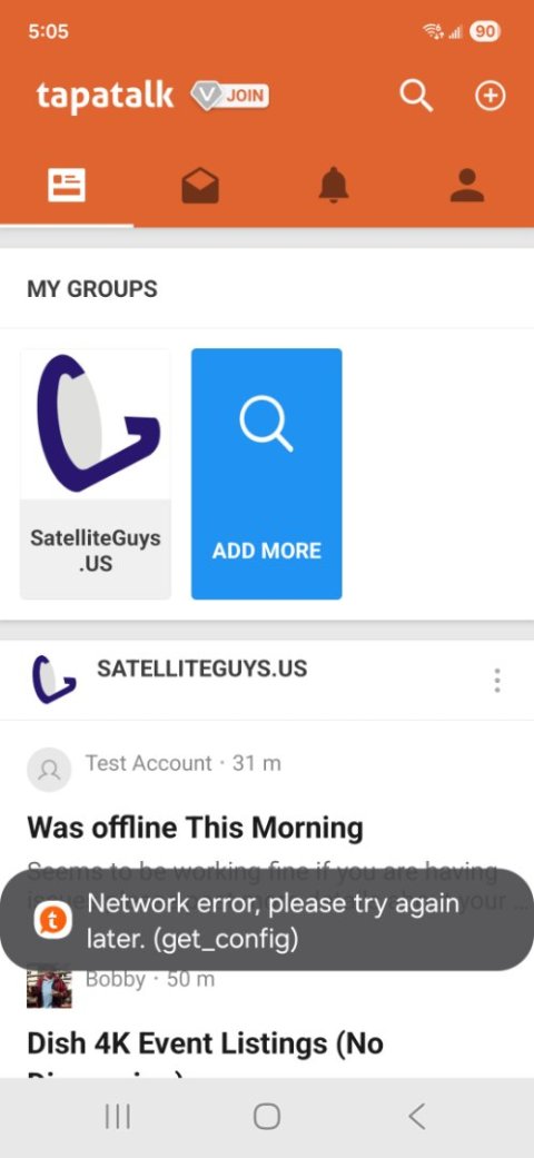

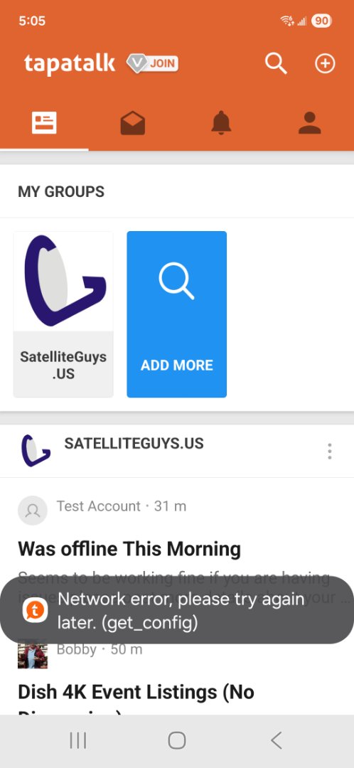

Since I couldn't log in using Tapatalk, I uninstalled the app, then reinstalled. Now I get attached screen. Something about a network error. I got same error before uninstalling.

Ok went through the system and tested it on 4 different devices and all of them are working fine. (1 iphone, 1 ipad, and two Android tablets)

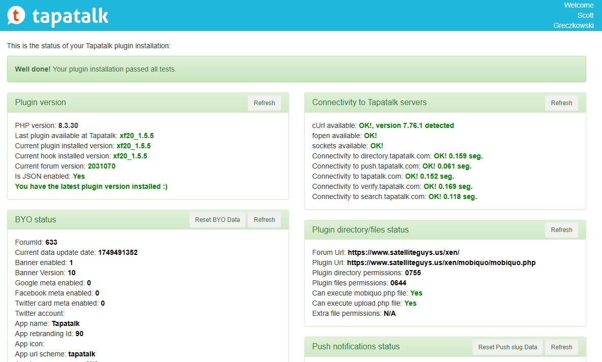

I also ran the diagnostics software and all is running well there as well. (As shown below)

With that said we are running the latest forum plugin which was updated last over a year ago.
About the only thing I can think of is when using it parts of your connection come to us from a Tapatalk IP address instead of the real address your using I am wondering if that TapaTalk address somehow triggered the firewall and is blocked. With thousands of hack attempts here daily it is impossible for me to find if they are blocked, and checking their support forum I do not see any IP addresses for their services so I could whitelist them.

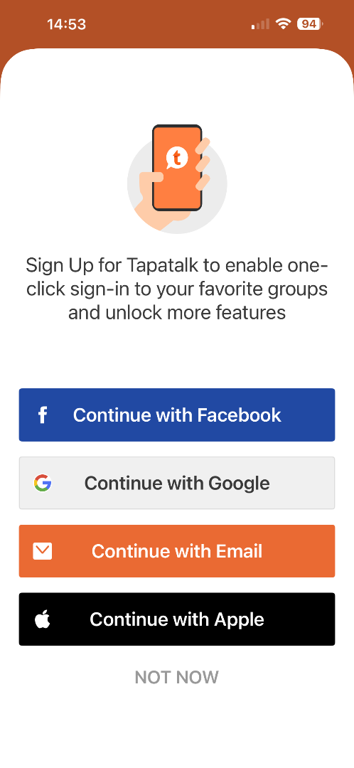

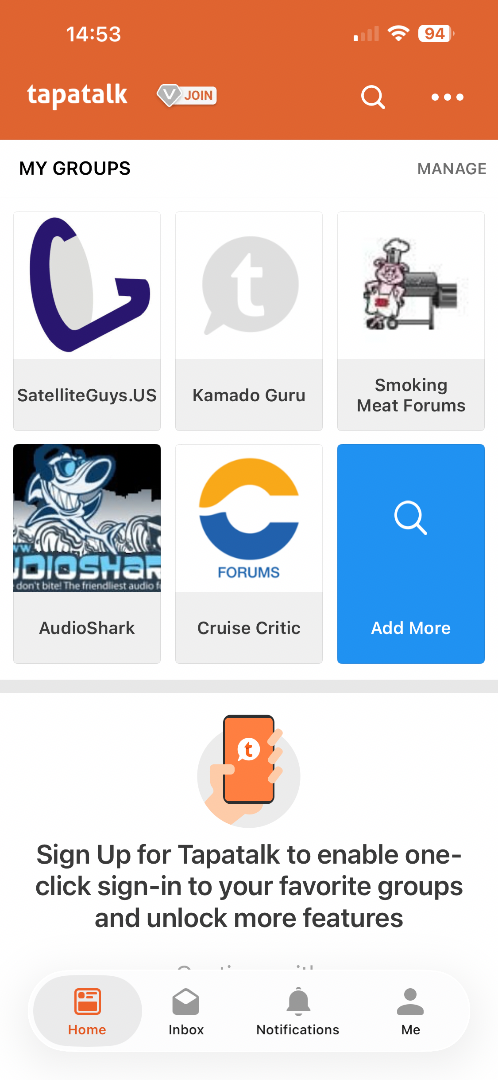

SOOOOO- I just tried to log in to Tapatalk, where I haven't been in many years. Didn't ask me to log in. I got this:
Then:
No account- but some account info.
So I deleted the app.
One down, 100 + to go.

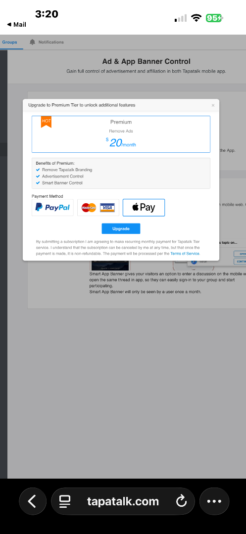

And when trying to turn the stupid banner off here is what pops up when you try turning it off.

So, the Tapatalk is branded into the XenForo software, and they extort the owner (you) $20/mo. to remove the Tapatalk App activation? Maybe that's why most of the Car forums I frequent use Fora.
No Tapatalk is a Add On for Xenforo (the forum software itself)
Fora is an addon that that Fora (who owns a big number of forums) made themself for use as a replacement for Tapatalk. They also run Xenforo (the forum software) and have their own custom add ons such as the Fora add on. They do not make their add ons available to other forums.
So you could save $20/mo. to eliminate this outdated plug-in? Sorry if I'm being dense here, but I really don't see the value of the Talkatap App. I'm perfectly fine using a browser to access my Forum sites.
