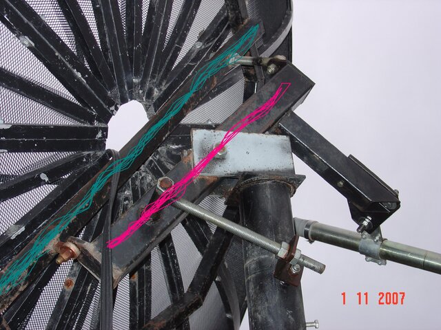

I have been trying to fine tune my 12 Foot Mesh Dish for Galaxy 25 / 97.0W. I have found most of the Tp's on 97.0W with a fair to good signal level, for example Tp 12177 S = 74, Q = 65. But no matter what I do I can't get anything more than a Q of 0 to 18 on 11966, and on 12152 I am seeing 0 to 10 very intermittently. I have adjusted Inclination - see pic #1 to as good as I can.
My question is when do you know you need to look at and adjust Declination - see pic # 2 and pic # 3 showing Both adjustments, and would it help me pull in those 2 Tp's?? Note, for my Latitude 49.9 for Winnipeg, Canada I should be at 6.6 degrees Declination, and my Apex Elevation should be 32.8 degrees. When I put my Inclimoter on the small Bar I read 56 degrees, when I put it on the Big Bar or Polar Axis I read 46.5 degrees. So that should mean my Declination is now 56 - 46.5 = 9.5 degrees, which is way off the calculated 6.62 degrees I am supposed to be at for my location.
But if I try to move the Polar Axis or Inclination any higher: ie. from 46 up towards 50 I lose all signal!! Does this mean I now need to adjust very carefully for Declination re pic # 2 to try and get my 2 missing Tp's especially 12152 which should be booming in as 12177 is?? This is very confusing.
Any advice would be very much appreciated.

its still not tracking the arc right
i agree with the above. sounds like your real close
mark your current settings and then try those listed above. hopefully it will track the arc.
good pic satphreak
Since your lattitude is 49.9 you will need to set the polar axis to 49.9 degrees. When I chequed your declinantion it should be about 7.29 degrees. See Footprints by Dish Size - Latitude Declination Chart - C/Ku-Band Satellite Listing
Here is you photo with the red line to set 49.9 degrees and the green line to 49.9 - 7.29=42.61. This should follow the arc much better.View attachment 21482

SatPhreak then I would need to adjust BOTH my Inclination (Red Bar) Bolt Nuts and Declination the (Green Bar) Nut. That is if I understand what your saying then I would need to adjust my Inclination - Polar Axis - Big Bar from its current 46.5 up to 49.9 degrees, and then DROP the Declination adjustment from its current 56 degrees all the way down to 42.61 degrees (49.9 - 7.29 = 42.61 degrees). That would mean a 13 degree adjustment on the Declination!! Thats a lot of adjusting on the Declination!!
I seem to be fairly close now, that is on the 4 tp's on the adjacent C Band Sat 96.9W I am seeing S = 75 and Q of 75 to 100% . And as soon as I raise Elevation from its current 46.5 degrees towards 50.0 degrees, I lose all signalling. Or do I have to readjust the East and West placement of the Dish as well? 97.0W is my True South Satellite. If thats whats required I'll do it, guess I could mark the current Nut Locations on the screw shafts with a red felt marker as per Gabsheres' suggestion. Any more comments would be very much appreciated.

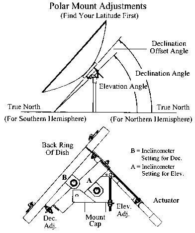

To answer the question in the title, the declination needs to be set before you start and with your satellite pointed at the South Pole.
According to this chart and your location of Winnipeg, your main axis should be set to 50.57 degrees and your offset should be at 6.61 using a digital inclinometer or protractor. Giving you a total of 57.18 total.
Once the declination is set properly, you should not have to adjust it again.
Then find the signal on your True South Satellite which is 97W and adjust the total elevation for best signal. Move to both ends of the arc and again adjust elevation for best signal.
From that point on, it is a matter of moving the whole assembly East or West to align the whole arc.

Thanks Anole, I checked Declination with my Inclinometer again today on the small Bar: - it is 56.5 Degrees - it should be 57.2, but since it was -25 degrees below zero with a -44 degree wind chill I left it alone for now, its so cold out there you can hardly think straight in that weather. Inclination on the Big Bar or Polar Axis is at 46.5 degrees - I need to raise it up to 50.6 degrees when it gets a bit warmer out there.

Took some closup pics today of the Declination Adjustment Bolt and there is not much Thread Left to Adjust it upward, I'm at about 56.75 and need to get to 57.2 so not sure there will be enough thread left to go any higher (if I am going in the right direction). Didn't adjust it too much as it was so cold out there.
My question is should I now move up the Inclination Inclination up a bit more since I need to be at 50.6 degrees for inclination. That is current settings are 56.75 - 46.5 = 10.25 Declination angle. My ideal needs to be 57.2 - 50.6 = 6.6 degrees. Also does the placement of the KU and C - LNB's re their approximate 5 and 11 oclock positions (see picture) have any bearing on my Sat Signal Reception? That is would fine tuning their clock position placement help with getting better or stronger Sat Signalling? Any comments would be appreciated.
Whatever your current elevation is right now on the main axis, set your declination at 6.6 degrees up from that, then go back to your main axis elevation to move it to 50.57 degrees. That will give you a total of 57.2 degrees without your having to adjust the declination again.
Then adjust the main axis elevation only for signal. :)
Linuxman, thanks for your reply, but to clarify are you saying that I should leave my current Elevation BIG Bar Polar Axis setting at 46.5 (it should be 50.6) and then drop my Declination Setting Now at 56.75 down to 51.25?? And then Increase Inclination Back up towards 50.6 to get the best signal? Sorry for not understanding fully. I appreciate the help.
Yes, leave your current elevation as is right now (46.5) on the main axis.
Put your inclinometer on the back of the dish ring and add 6.6 degrees to the current elevation and move the declination to where it is 6.6 degrees of separation total of 51.25 degrees.
Then put your inclinometer on the main axis and move the main elevation on main axis up to 50.57 degrees which would then give a reading on the back of the ring of 57.18 degrees total.
Think of it this way. The total is the sum of the two parts.
Elevation adjustment plus declination adjustment = total elevation.
Then adjust main elevation axis for signal while pointed at the South Pole, or nearest satellite to it.
But please remember to have your dish mount and dish pointing due south (toward the south pole) before making any measurements and adjustments. Otherwise the measurements and adjustments will be off and the dish won't track the arc properly.
