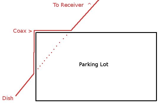

Pardon my crude drawing. It would lengthen your coax run but can you go around the parking lot (solid line) instead of over (broken line)?
if i had to guess maybe a 12ft. section and yes possibly cars passing over it, but just had a thought if i could use two support pieces to lift it up on both sides of the driveway so it would not be driven over that might be better.

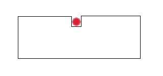

Gonna snow here - Winter Storm Warning for 5-8". :( Does the driveway have any expansion joints cut into it? If so, and they are wide enough, it may be possible to fit a coax cable down inside the joint and cover with sealant. Kinda like this:
Yes, they mention driveway and sidewalk but it would definitely be a much bigger job for 12' of driveway vs 3' of sidewalk. Hopefully you can come up with a workable solution. Keep us posted! :)
