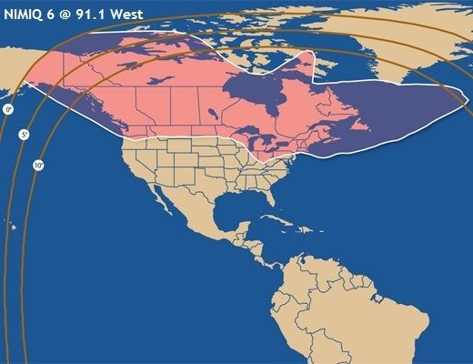

Northern Colorado reporting in - all of 91 is gone now. I get 82's transponders pretty well during the day, but lose them at night, so I was expecting something similar for 91. But for the moment, I have lost all trace of SD. At least I am still getting guide info and most HD - I think I will keep paying for service for now. I have a 1 meter dish in the basement, but I don't think it's worth trying for 91 unless I get a whiff of it. IIRC, the footprint change on 82 was harsh for me at first and then got a bit better during their initial tweaking, so I will check a bit further out.

I am in North Carolina and have lost all TPs on 91W with the original Bell Express-Vu dish. I am not sure if I will continue chasing a service that I am paying over $60 like I did with 82W back in 2008 by getting a larger dish (76cm). So... your feedback is good to have.

Mike Kohl posted a link to what we believe is the 91W footprint now
pink...you're good
close to the pink....bigger dish needed
the rest of ya are screwed
