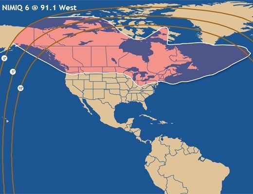

91W NIMIQ 6 completely active now....footprint changed
Hi,,I have a 3o inch/76cm dish set-up for Bell's 82 degree satellite on my roof near JFK airport just across the Nassau County border in Long Island, NY. My signal strength is quite good on all transponders,,from a minimum of 66 to a max of 79 with the majority in the mid 70s. I obviously need to enlarge my 91 degree dish, as well, now. Is the 91 degree footprint exactly the same as 82's? Do reports show it to be tighter northward than 82's-- worse signal for my location-- or should I expect the same signal strength on 91 as 82, or even better, perhaps, with a 30 inch/76 cm dish? Thanks for info.
Indications it's tighter that 82 so you maybe on the fringe, enough signal for a lock but not much fade margin. Good luck though!!

What I find interesting is that the published 82 footprint doesn't reach as far into Montana as that for 91, but I get signal from 82 in northern Colorado and I don't get a whiff of 91.
I also kinda hoped they'd have a glimmer of signal for Echostar in suburban Denver, so those guys could work on the Bell firmware.
I'm located 17 miles north of downtown Spokane, WA. With an 18" dish, my levels on 91 range from 67 to 81, on average about 5 points lower than from the old satellite. On 82, they run from 75 to 86.
82 reaches all the way to the Colorado Border

OK... I figured that that is what you were talking about. A good incentive to tilt the beam a little further south, don't you think?
