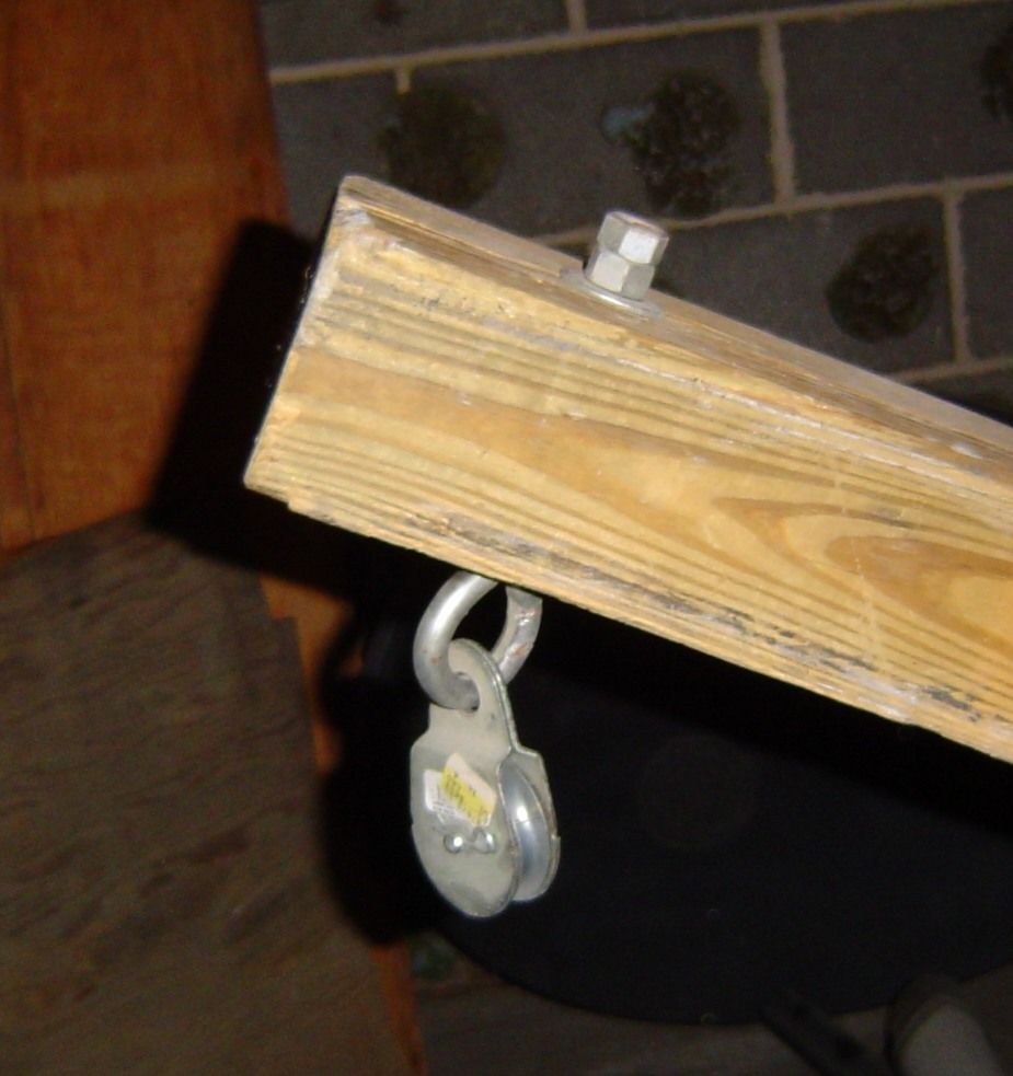

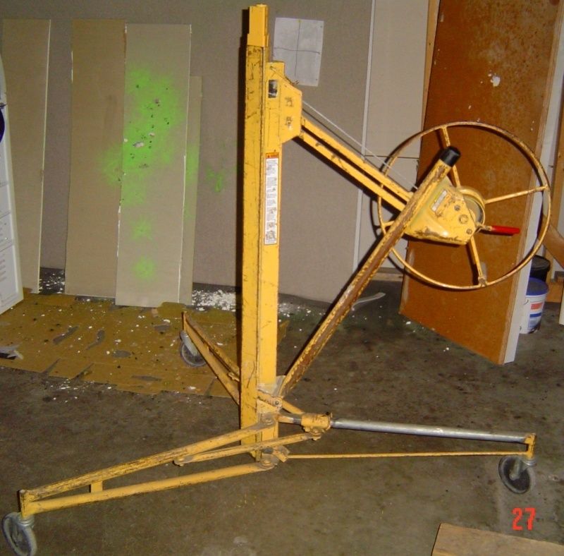

Well it looks like a break in the weather forecast for Nashville will be on Sunday. High in the mid sixties.
I have put out the call to all my buddies, and think I can raise three of them for the trip. I have been in touch with the owner, and he will be home, so it looks like a good possibility of a go. I have also PM'd djkurious to make sure that we can get that one at the same time if he is available.
Since my last post here, I have found a piece of equipment that will do the trick of taking down the dish. I own a drywall lift that I had forgotten I owned. It was buried in the warehouse, but I drug it out a couple of weeks ago. This lift will support a 12 foot piece of 1/2" drywall, so I think it will support the dish and mount. I also got a lift for hanging over the edge of the roof for bringing things up that I will borrow the pulley off of and the 200 feet of rope that came with it. Pics below.
My welder is making me a tube for the top of the lift with a pivot point to stick in the top where the lift platform usually sits, with a hole for hanging the pulley on one end.
He is also making a piece of flat steel with holes drilled with centers for two points on the back of the dish and front of the mount. There will be a hook welded to the flat back for grabbing with my rope hook. :)
We just climb up on a ladder, take the top six bolts out, loosen the bottom six bolts, lean the dish forward away from the mount, slip the flat steel between, put in two bolts, grab onto the hook, take the weight off with the rope, remove the bottom six bolts, and lift the dish away from the mount and gently set it on the ground. Do the same with the mount, and cut the pole and we are off.
Piece of cake!!
Here's the pics:
Oh yeah, I almost forgot, the lift folds up for travel in the back of the van. :D

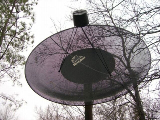

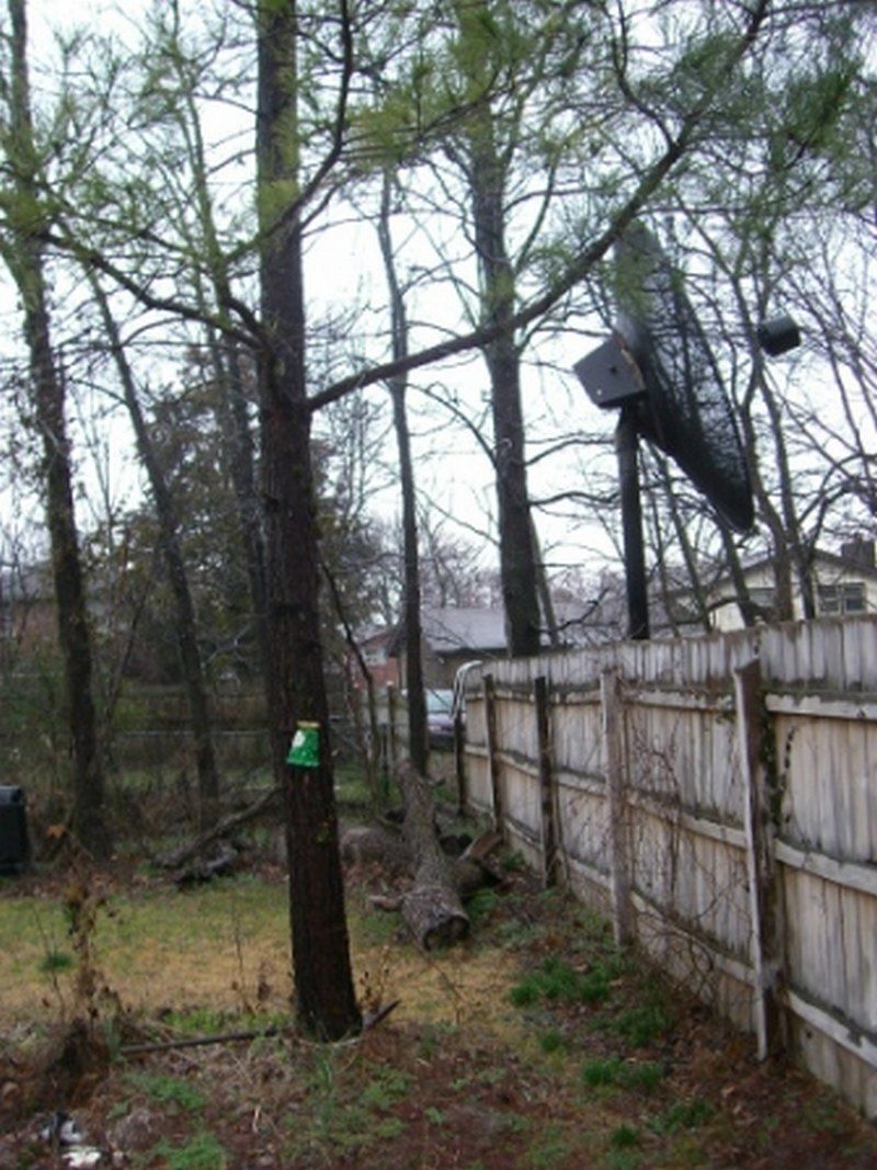

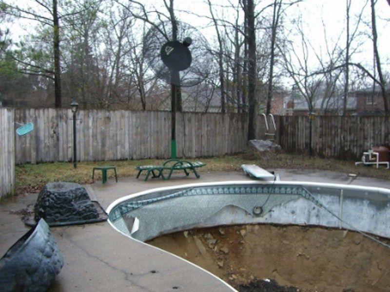

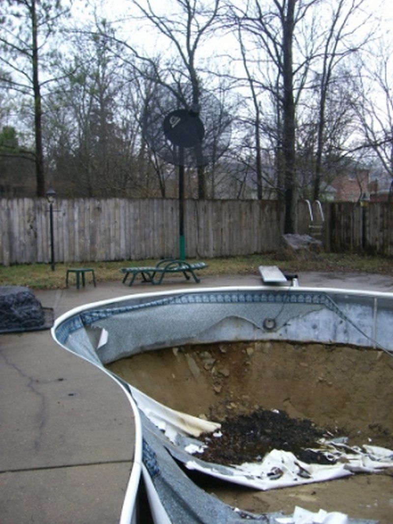

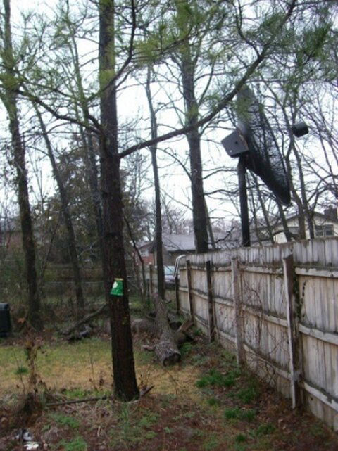

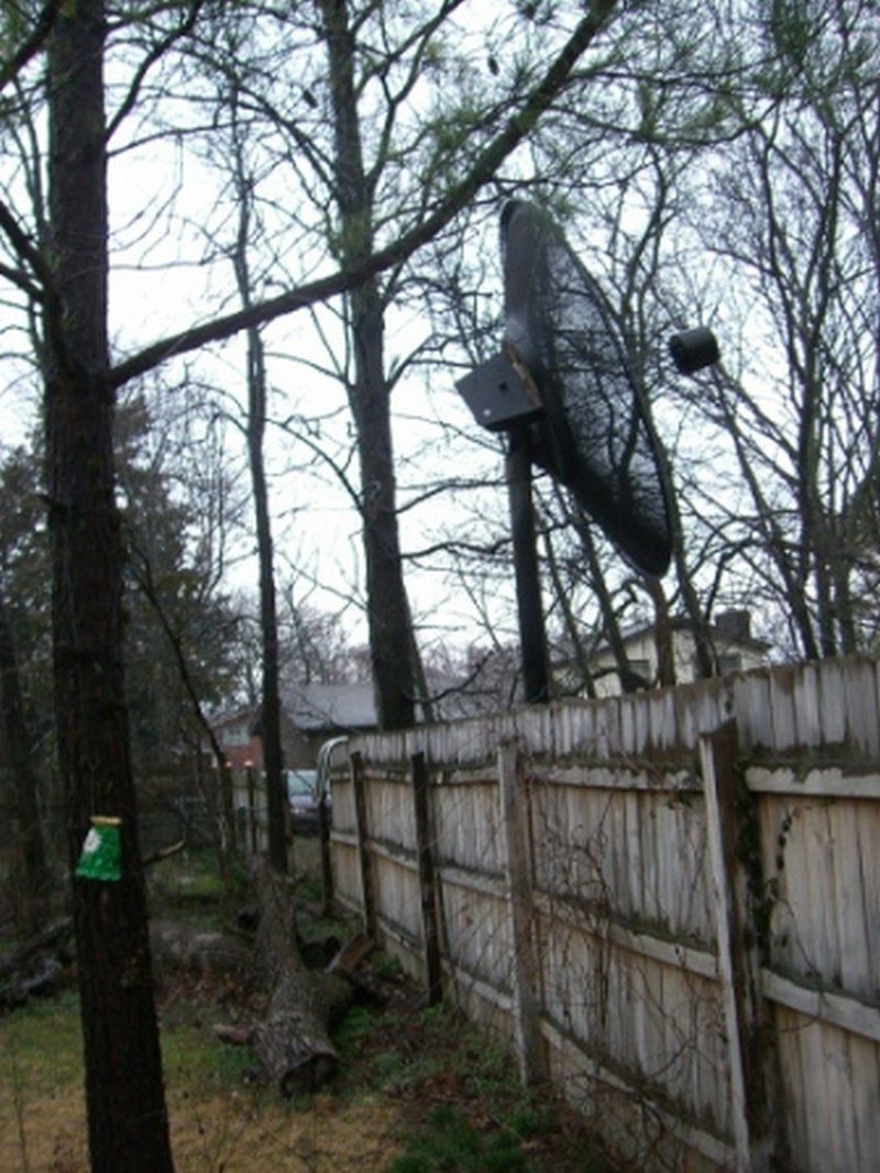

I have been in contact with djkurious too. He went by the place where the perfed Birdview is, and has surveyed the area with some newer pictures. He has it all setup with the owner who will help us too.
This one is going to be a challenge. Djkurious took some measurements for me so I could plan ahead.
The bottom lip of this dish is 8 feet off the ground. The bottom of the mount is 9-1/2 feet which puts the top of the mount at about 13-1/2 feet. My lift only goes up to 11-1/2 feet which will be fine for the mount which is the heaviest piece.
The problem will be getting the dish off the mount. I'm thinking a rope between 2 of the trees behind the dish and hang the pulley off the rope to get the dish loose and gently swung around to set on the ground.
All work on this dish will have to be done behind the fence as there is only a walk-through gate to get into the fenced in area under a car port.
Djkurios has done a great job of preparation for us and has paved the way for us to get this dish, and I thank him very much!! :hatsoff:
Here are the fresh pics of the situation:
The dish itself only weighs about 75 lbs, but it is big and bulky. If we can get up high enough to snag it from the top, it will be fine.
