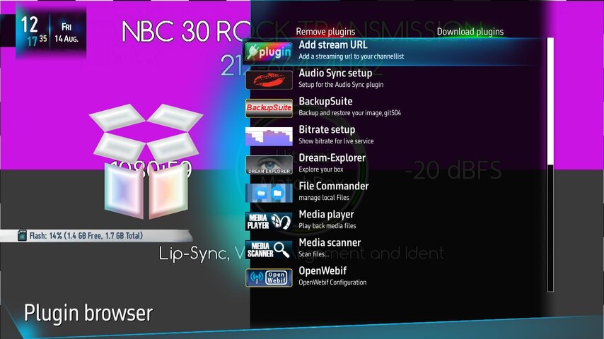

I just loaded TNAP 3.2 ofgwrite into slot 2, and restored settings from my slot 1 TNAP 3.0. Everything went VERY easy, though I had to remap my usb drive on the Mio, that I save shows and such to, so my laptop would see it again. Kudo's to El Bandido. I just set a couple recordings through the OpenWebif screen, and that also seems to be working ok.
I then loaded the 'Add Stream URL' plugin from the Downloaded Plugins "Extensions" (I think it was) tab. Haven't tested it just yet, as I don't at present have a USB keyboard hooked up. Though I do have a Logitech K400 keyboard I can transfer from my tv set. No time right now.
I did notice that IF I copy/paste the streams in a IPTV folder on the Mio's drive, I can see them just using the normal PVR button and navigating to that folder. Once I highlight one and press PLAY, it brings it up automatically and plays!
Some of those URL's are LONG!! Which USB keyboards are supported?
I assumed that any USB keyboard worked. No? I use a RF dongle, no name, mini USB keyboard.
I have both a mini usb keyboard and the larger K400 (much prefer this one) with the rf dongles. I've used them before on my Amiko receiver, and though I haven't as of yet tried them on my Mio, I see no reason why they wouldn't also work on that.
I can confirm that the Logitech K400 wireless dongle mini keyboard works fine. After installing the usb receiver, REBOOT the Mio, and when it comes back up, keyboard works. I just added some IP streams to a bouquet called "IPTV" with the Add Stream URL plugin.
Worked perfectly.
p.s. I noticed that AFTER you add a stream channel to a bouquet, you have to exit the bouquet into another one, then come back before that newly entered one shows up.
