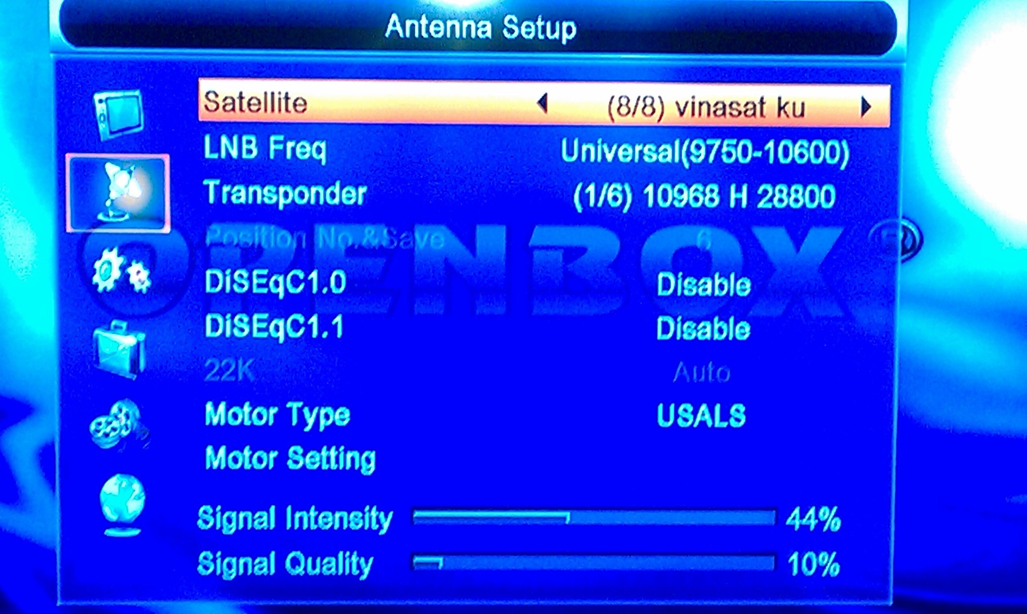

I've tried setting it as Carlospr43 suggested by creating two SATs, and below is the setting for Ku bands and setup the settings as Carlospr43 mentioned, butstill no signals for these transponders:

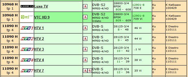

10968H (28800)
- Ku Band
11090H (28125) - Ku Band
11116H (6665) - Ku Band
11549H (28800) - Ku Band
I noticed that the 22k is automatically set to AUTO (and disabled) when LNB Freq is set to "Universal(9750/10600)"...

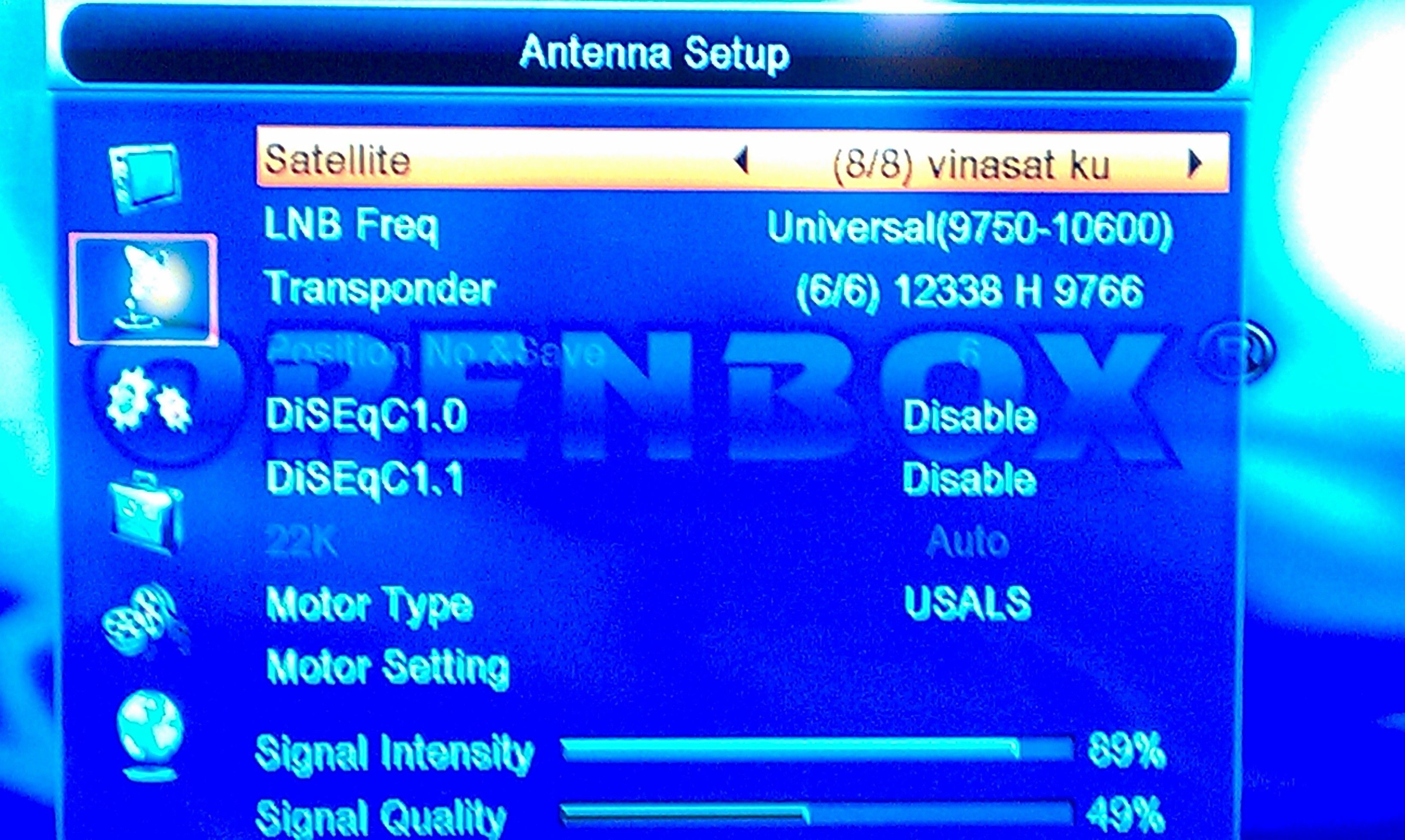

when I did a blind scan on this new satellite settings, it picks up transponder 12338H (9766), which is the same as 3413V (9766) - C band but not the others preset Ku transponders (as mention above)

why are your diseqc settings disabled?
you need to use the diseqc settings to select c-band or ku-band....
keep lnb setting at universal 9750/10600 and select port one or two on diseqc 1.0 (im not sure which is c or ku on that LNB) but it will be one or the other

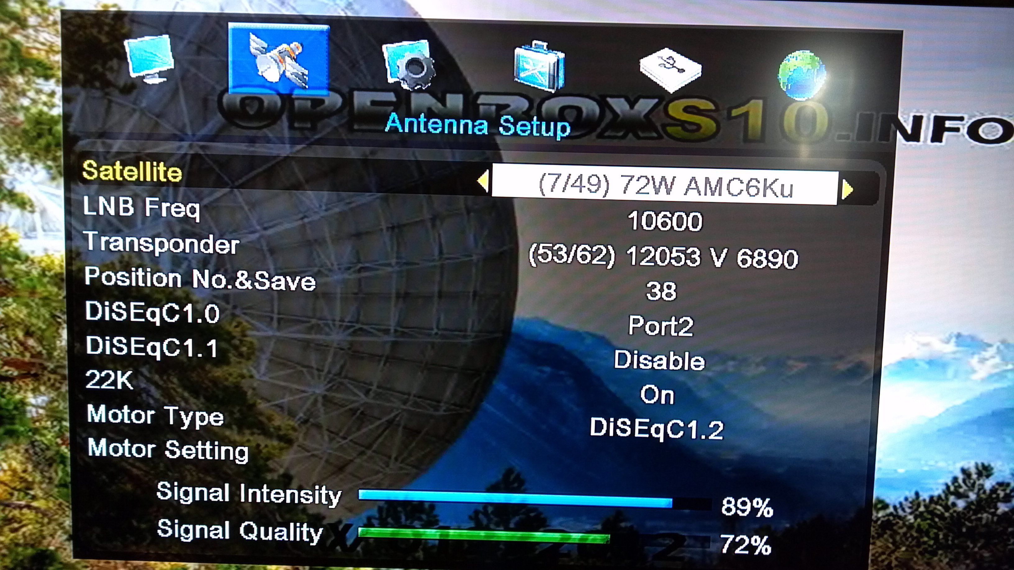

This setting works best for me,c-band diseqc 1 and ku on 2. I don't use the built in lnb switch, I use a 4 port diseqc instead.2012-04-07_17-04-06_719.jpg
