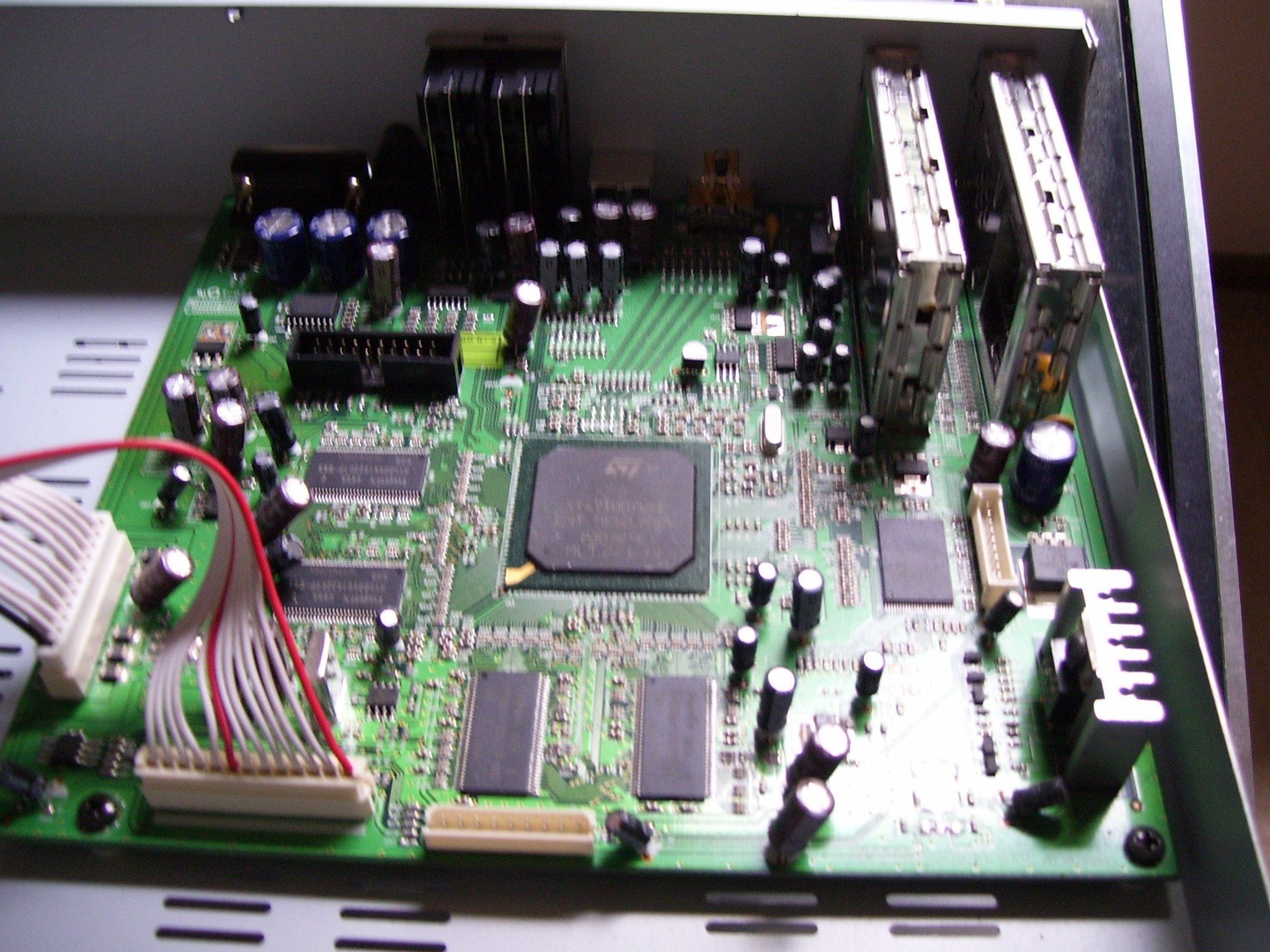

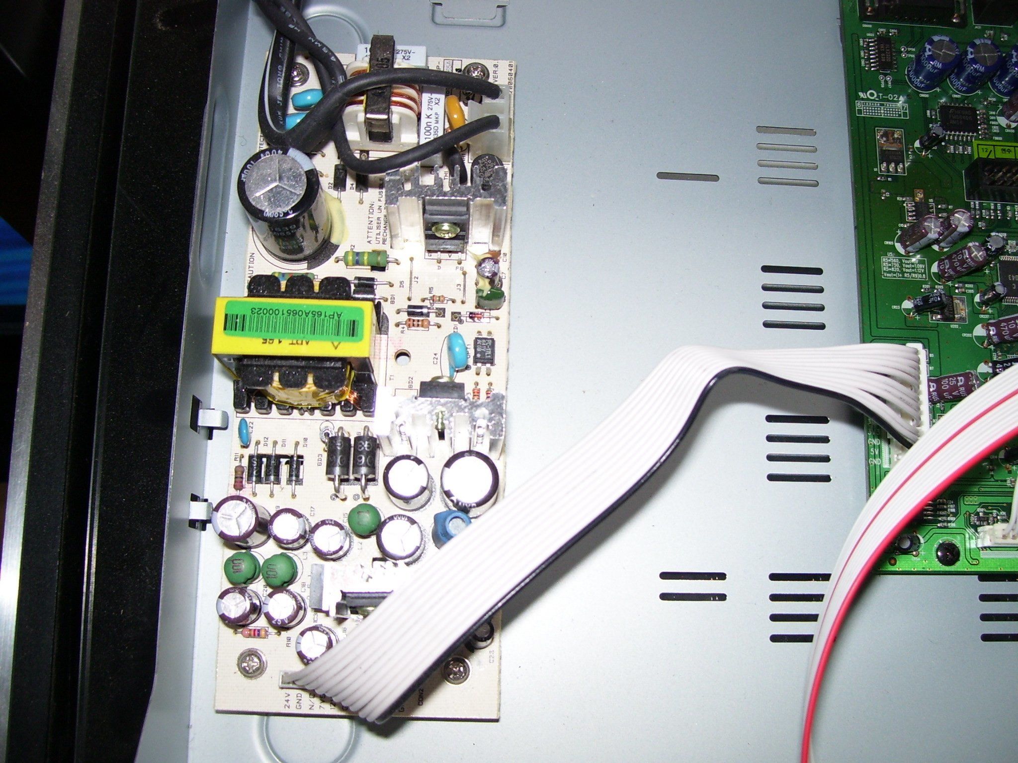

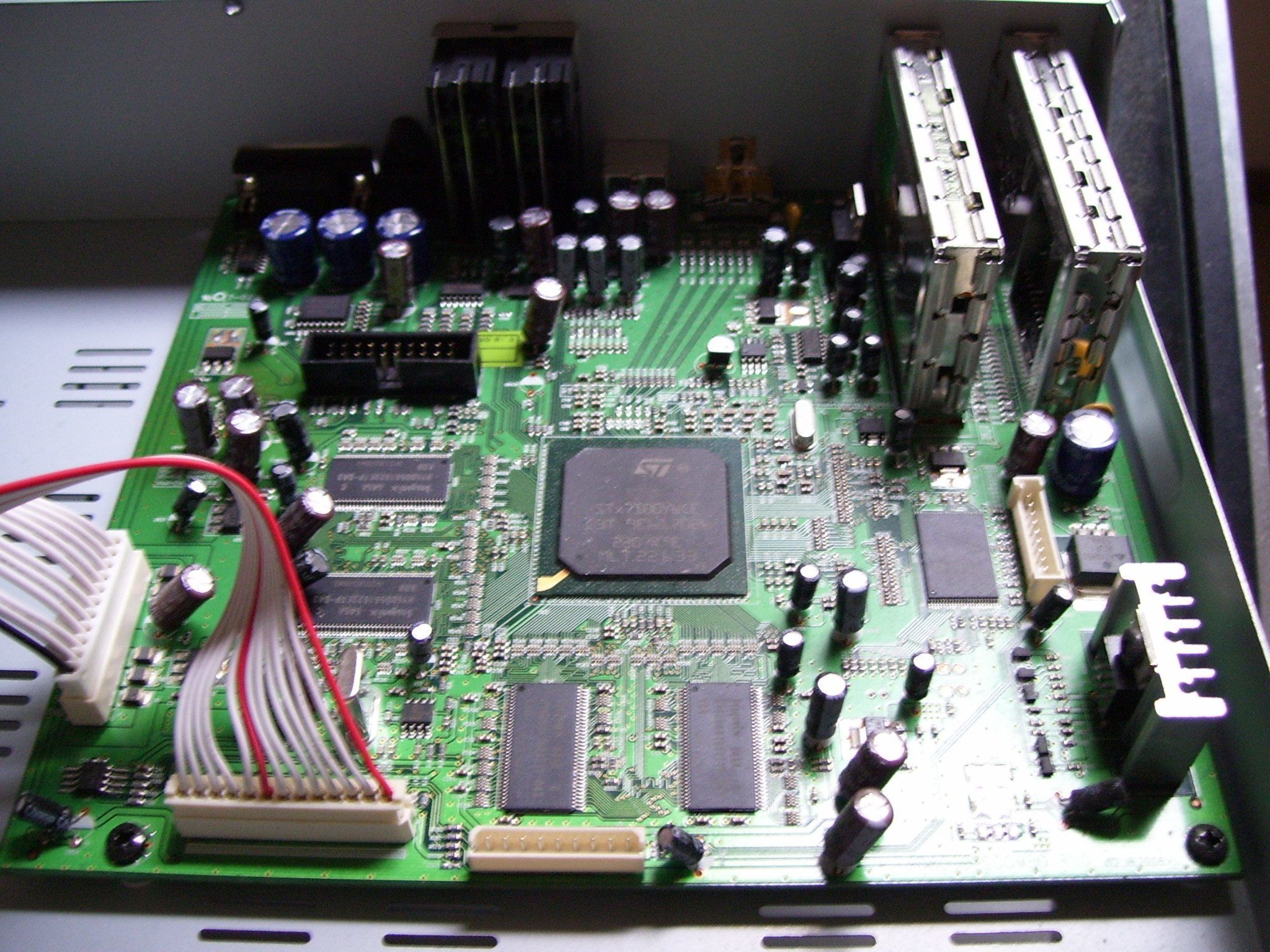

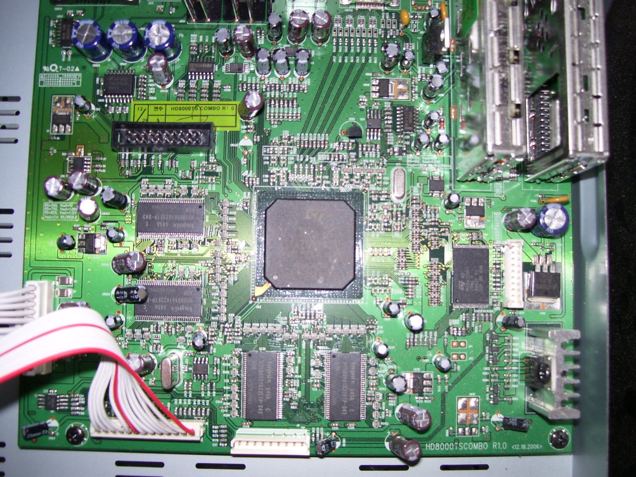

pics of mine...sorry if they are not the best

Wow, I see why your box get very hot, Iceberg. Maybe you can find one of the computer processor heatsink and put on your box processor. I bet you will find the difference real quick!
Plus putting a fan in your box as well. Like Pro said, heat is the killer of FTA boxes.
Maybe you will be fine. You mentioned is earlier posts you had to place the box somewhere else because of the heat it generate. Since I mod my box with a fan, it doesn't get as hot as it was. It stay warm to the touch. Try it Iceberg and see what happens.
