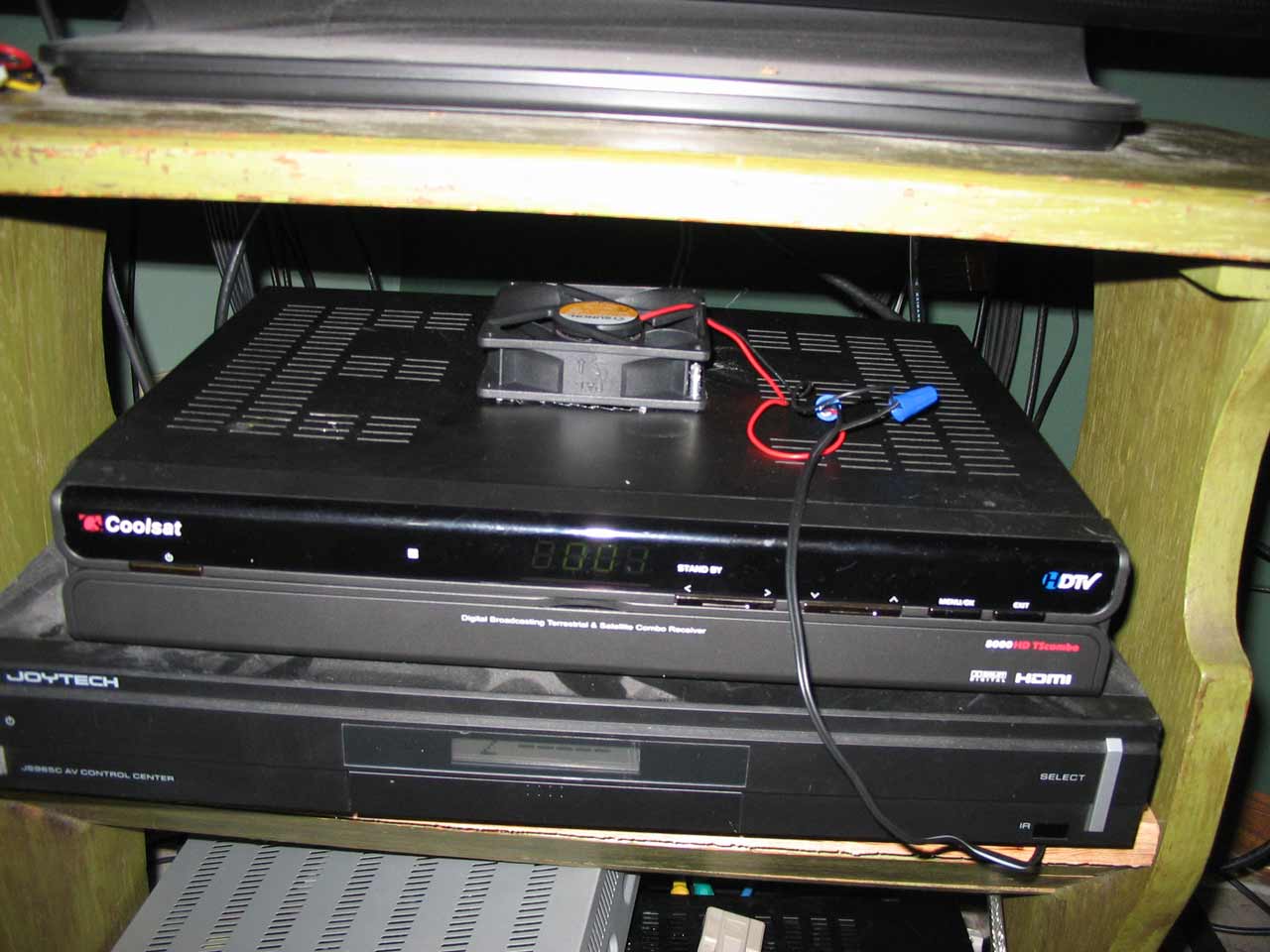

Here's my contribution, a quick 12V case cooler , permanently external powered .
I was having lots of problems ( the cat was sleeping on top of the box), the lnbf voltage was disappearing altogether, etc. Not a problem since the fan was put on top, the case is actually mighty cool to the touch. It's a 12V , 1.6W fan, usually used in PC Cases.
Not at all elegant, but it works very well and moves more air than would be technically necessary. :)

Another great idea! Thanks Brent!

I s the fan on all the time? I've recently gotten one (8100) used and it started the powering off. So after reading this a bit I opened the case and plugged it and fan isn't running.
This fan runs all the time. I expect it will run for a couple years before needing replacement, we'll just have to wait and see. I have several other fans, so that won't be a problem. A 5 volt relay to bring the 12V fan on whenever the receiver is powered would be a nice touch, but it's another point of failure, too.
Yes, it runs all the time. The installation of a fan isn't hard at all. Look at the earlier responses of this thread to see how other guys did their work. You can buy the fans at Radio Shack or any computer store. If you have any old computers laying around, get one out of them.

I wonder why the fan on Whatchel's receiver not running? Could it be the previous owner didn't install it correctly, or has the fan phased out?
Whatchel, take the cover off your CS8100 off and see where the lead wires go and compare them to the photos of the posts of this thread.
If you're icky about fooling with the receiver's innyrds, maybe someone you know that has a electronic hobby can fix that problem for you.
I, too, wish there is a way for the fan to cut off when the receiver is not in use. Every time I come into my living room I will here it running. I worry about it phasing out especially it being a fan from a older computer. Maybe it is for the best to leave it that way.

The fan is connected to a pc connector built on to the circuit board. It isn't spliced into the ribbon cable. It is like the one on post 10.
