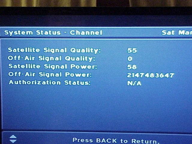

Strange that mine are not up and went I look at the system settings I see this picture. My 6000u is still getting my locals at 95%. I can see how this will frustrate people not being able to tune to their locals.

That signal power number is crazy! I assume you've tried the factory reset. Your numbers look very strange.
You must have your antenna connection connected direct to the stations transmitter.
